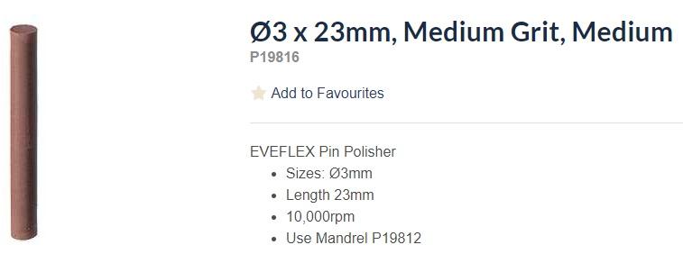

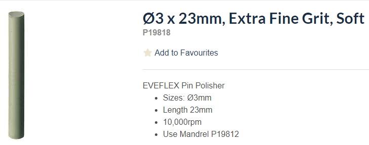

I've been curious about these pin polishers for quite a while, so I ordered the following from CousinsUK:
MediumMedium.jpg.7c9d317fd3e8a9fa544b255598ce90e8.jpgMandrel.jpg.76fd249d3fb13dfb229cce2be0cb8e33.jpg
In hindsight, I regret not ordering the two-millimetre versions instead as the polishers tend to hit the fingers/tweezers when rotated.

Yes, indeed, but it depends on the hardness and grit. The medium grit and medium hardness polisher will quickly taper the pivot so stay away from it. It's very aggressive.
I would say all you need is the extra fine grit and soft polisher. As far as I can tell it doesn't remove any material, except for perhaps a few microns. Of course, it also depends on how long you keep polishing.
Although I made no extensive tests with the fine grit and soft polisher I'd stay away from that too.
Just to make sure. Do not think that these polishers can be used to burnish/repair the pivot. A Jacot tool is required for that. However, for cleaning they are well suited.
