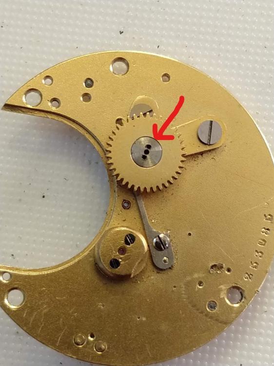

Hi there,Can anyone help me with a problem I have with an English Lever Movement.I thought that the mainspring had broken but on investigation that was all ok so I decided to take the movement apart and look further into this problem and while apart I decided to clean everything before reassembly and oiling.Under the top plate there is a sprung lever assembly that is held against the center wheel pinion and when I try to wind the mainspring up all of a sudden the pinions disengage and all power in the mainspring is lost??Has anyone any thoughts or ideas on my little problem,any help would be gratefully received.I enclose a photo of this lever/spring assembly under the top plate that connects with the center wheel pinion.Regards,Seth.

Is the red arrow pointing to the bottom of the winding arbor? If yes, it sounds like either the click is bad or just not correctly engaging the arbor.

Hi there,Firstly many thanks for your replies,I have not seen "Reversing Pinion" on it anywhere.Your RED ARROW on my photo is only on the pivot for the large brass pinion wheel that is shown.The mainspring barrel goes into the large cutout and the teeth on the barrel engage with the pinion wheel shown which in turn engages with the small pinion on the center wheel shaft.If you look at my photo the screw which is almost hidden by the pinion wheel is in a slot on this brass "L" shaped lever which is pivoted by the screw at the bottom of the lever.At the top and its half hidden is a polished steel spring which rests on the lever keeping it under tension.If the lever and pinion assembly is not engaged with the center wheel pinion then you cannot wind the mainspring.If the lever and pinion assembly is engaged with the center wheel pinion then you can wind the mainspring but the movement is SOLID and will not move. If the pinion assembly is disengaged from the center wheel and no power on the mainspring then the train is FREE and can be turned with tweezers.Hope this helps as I have 2 more movements exactly the same mechanism which I got from Ebay for spares.Regards,Seth.
This looks like it may be a reversing pinion movement. The English developed this system because people were used to fusee movements which wind counterclockwise. This mechanism gave them the opportunity to wind in either direction. Do you have photos of the other two movements assembled? I can confirm by those. Thank you.

Good evening folks. The first of 2 H. Samuel watches I purchased arrived today. On the surface, this one seemed identical to the OPs but after tearing it down I discovered it was not the same. This one has a safety pinion just like American pocket watches do. And as it turned out, it needed it. The mainspring was busted and had tripped the pinion. This one does have an extra gear, so at first glance it appears the same as @Seth's, unfortunately not. I'm still trying to decipher it's purpose, my first guess is it allows the watch to be wound counter clockwise. I do want to source a replacement mainspring, so if anyone has some researched a replacement for one similar or has one, please let me know. I will be reassembling this and if I can get it ticking with pressure on the barrel, I'll share more photos.
Good evening folks. @Seth my new watch arrived today, and I think I may have solved your problem. In the picture below, the arm that i outlined in red needs to slide over in the direction of the Green arrow, where it is currently in the picture is the "tripped" position and therefore the gear does not engage the center wheel pinion. This is apart of that safety mechanism we were discussing. In the video, you can see it in action.

After assembly I noticed you can reset the mechanism without disassembling the entire watch. You can use the point of a screw driver to push it back in place.
