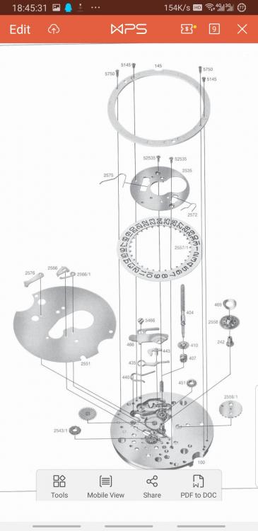

A day-date BFG 628!
From the technical document on Cousins, parts I need (2566, 2566/1, 2557/1) look like the same.
1375240999_Screenshot_20200309-184531_WPSOffice.thumb.jpg.34da8dd0ffddb7b205dacceb2cf29e39.jpg
So I bought this immediately and I am waiting for 4 days delivery......
