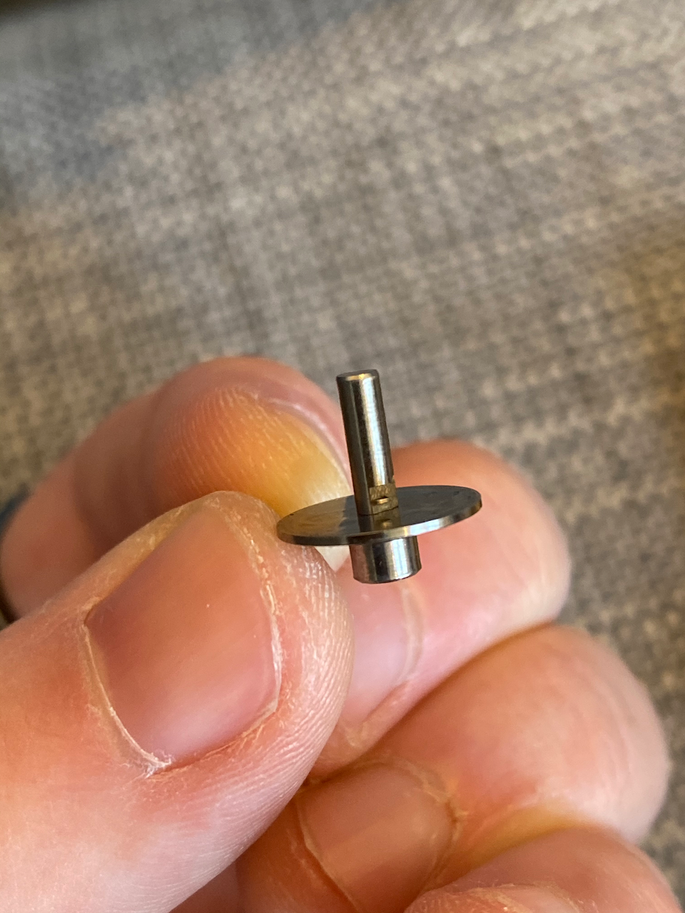

A quick heads up for anyone thinking of buying the above set, I just bought one mainly because of the metal shaft used to wind the spring, in the cheap Chinese kits these are normally made from brass so too soft for any chance of long life from those tools.
Unfortunately although shown as metal on the sellers page when it arrived they were all made from Brass 😞
Just in case anyone was tempted, might be better to just buy the Bergeon version one at a time as you need them.
Paul
Well, brass is a metal anyway, it can also be hardened (but not after machining) making very good tools. Also, don't count on what you see shining on Chinese products pictures is steel, because they specialize in mystery metal which is given a good look by plating, etc. If the seller is a specialized one or claiming to be "factory official" there is some chance that asking gets you a sensed replay, but if it's a dropshipper they will always answer what you want to hear.
