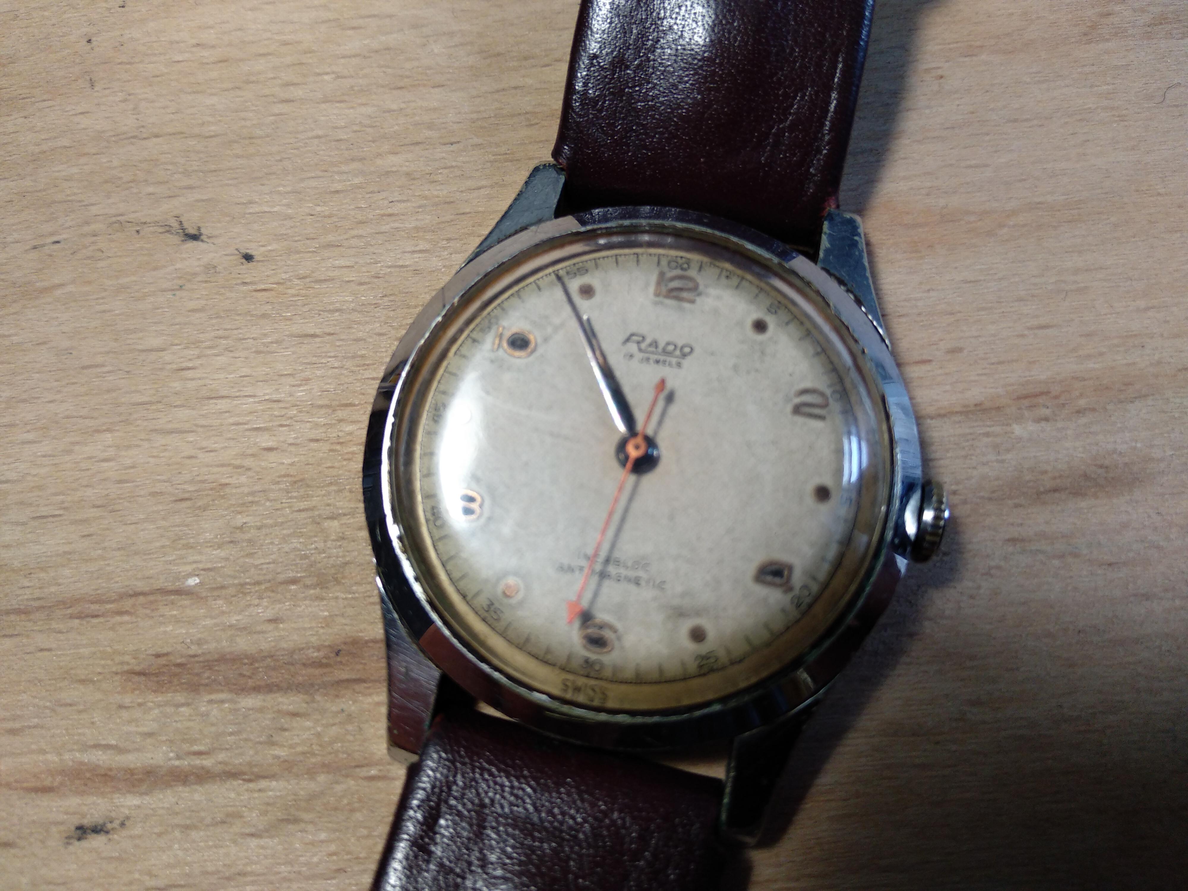

Rado 17 jewels AS 1187: an attempt at servicing a watch

Then, can I replace it by purchasing a regular ruby with the same or similar width and height and pivot groove size from eBay? If I replace it like the above and operate the movement, will there be no problem?
I don't have a timegrapher. I have two ways to check the accuracy of my watches : * First I have the app Watch Accuracy Meter * Then I take a real measurement everyday at the same time, using timeis.com website That double check works very well with my other watches (Seiko 5, Herma / Parrenin HP X40, Lov / AS 1710/11). Both the app and the real measurement indicate approximately the same thing (the app is a little optimistic). The Longines is the only one for which the app tells me it's fast whereas the real measurement every 24 hours indicates it's a little slow. That's why I guess the problem could come from another part than the balance wheel.
