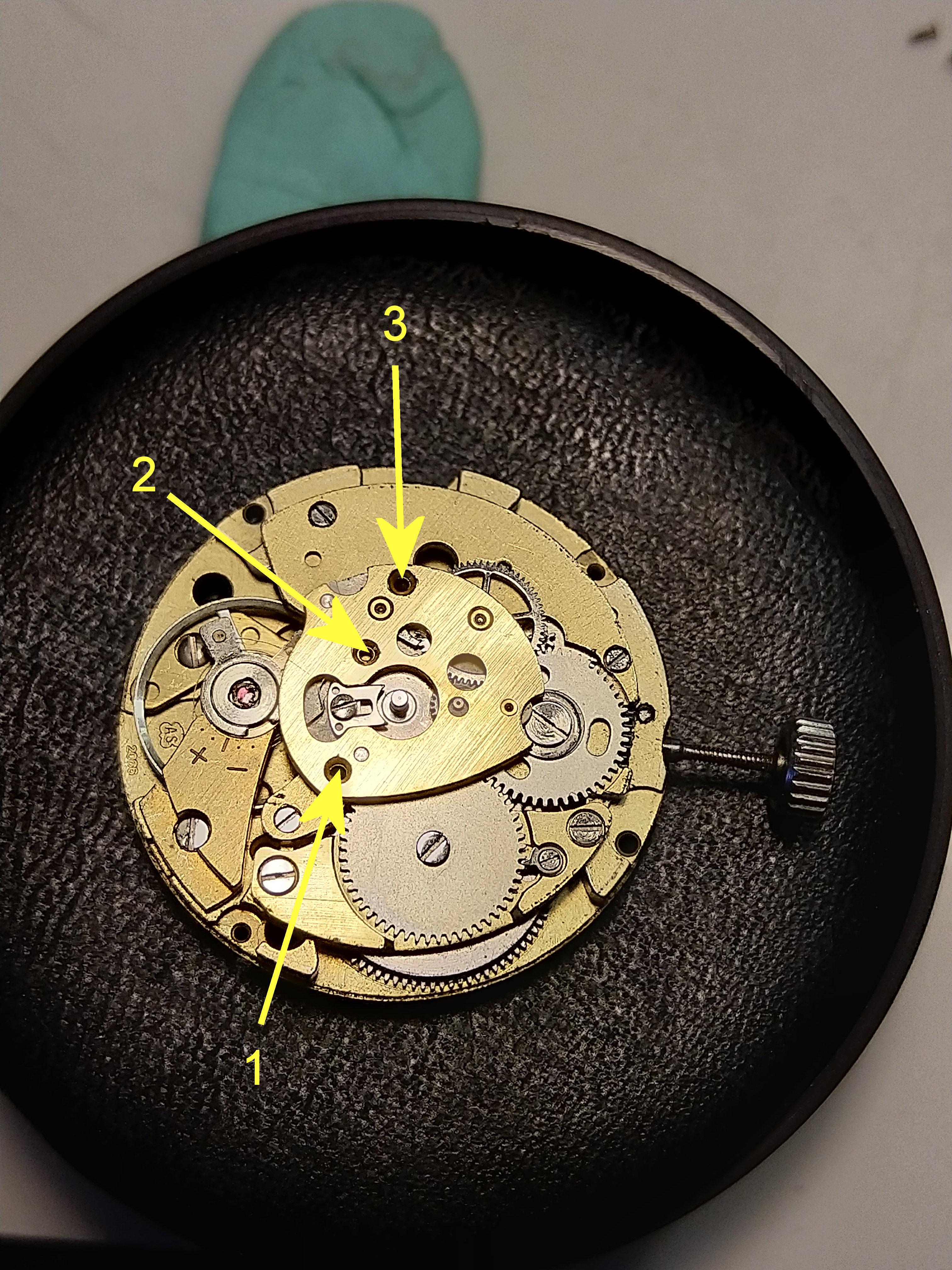

This is an AS 1916 and I'm a beginner.  Should the circled areas be oiled?  I only have Moebius 8000.  Below is the same plate with with the wheel and clutch(?) installed.

Yes, read the BHI document that WW attached. And apply the oil you have to those bearings. Also add a tiny amount to the leg of the spring which touches the swinging arm.

But now let's se how you could do for now. I taken pictures from the teardown too so you can put it together just by reversing th sequence.
First we have to get the oscillating weight off by loosening the lock. Just loosen the screw so you can move the lock to the side.
With the lock bolt loose lift the oscillating weight away. To get the autowinder away first screw off the three screws it is fastened with.
You could put a extremly small drop in the hole shown in the picture or on the pinion of the gear.
Later on when you put the winder back together lubricate at theese two spots. Just a small drop.
There are nice pictures shoving the amount you should use  in those documents you were presented earlier in this thread .
The same goes here lubricate in these three spots, but not when you take the winding assemly apart, just when you cleaned it and put it all together.
Always lubricate the surfaces where metal goes against metal.
The lever you call "Clutch" actually is like the click by the crown wheel, since you don't have any reversing wheel in this winder this click will prevent the oscillator to wind the mainspring the wrong way. So it is more like a break.
In your picture it is flipped the wrong way again.
After lubricating where metal parts meet eatch other just put the bridge back and go the reverse way in this picture series.
Now you can lubricate in phe previously shown positions.

Many thanks for the help.  Yes, my picture has the click the wrong way.
Do you assemble the autowind first and then fix it to the movement?  I've started by fixing just the bottom plate to the movement and then building it.

Yes I first build the autowinder assembly.
As you can see me and other people use Rodico not only to clean the movement from stubborn dust but also to fix parts into place while assembling, here the Rodico holds the ratchet driving wheel into place while putting the other parts and springs into place. Otherwise the wheel would with high probability fly away together with the springs.
The bridge then has guide pins which makes it easier to put it in place, little fiddly but easier in the way presented in the pictures..
