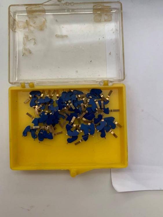

I've got another Timex electric with a "limp" contact wire. I'm going to try replacing it with an old hairspring wire. I don't know what happened to this wire. It's so soft that it'll bend if I stare at it hard enough.
Like this?108989506_578949759679506_470767333316747931_n.thumb.jpg.b49af6c6acfef1a4092843e221227ebf.jpg
Yes, that's the one. Are all Timex contact wire identical or model specific?
I have another two Timexes in the mail. One is a electric, the other is a Q quartz.
No they are not all the same.
