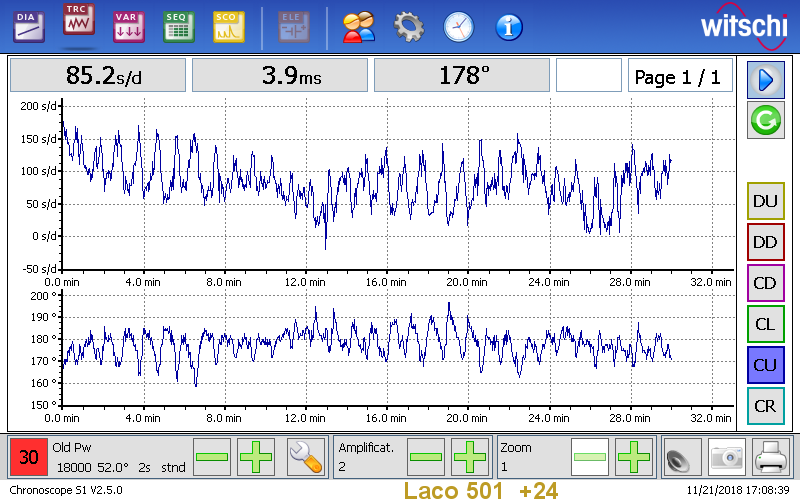

Then there is the other thing that I find interesting? Some witschi timing machines have a time plot feature. That is they will plot the amplitude and timekeeping over a period of time like around 15 minutes. This is where you can see the effect of unequal power in the gear train for instance and what that effect has on balance wheel rate. Then the interesting thing of this is having time to variety of watches some of them like the Rolex I timed and I can't attach an image if you want. It very clearly has a wheel defect you can see that in the amplitude but almost no effect on timekeeping. Other usually cheaper watches the effect is dramatic. The normal timing machine doesn't show this because it kind of averages this all out.
If it's not too much trouble I'd like to see it.

Then I have more images but they're not labeled these all have text on them. You also have to be careful because the machine will do an auto ranging so things that look really bad if you look at the numbers might not really be bad.
