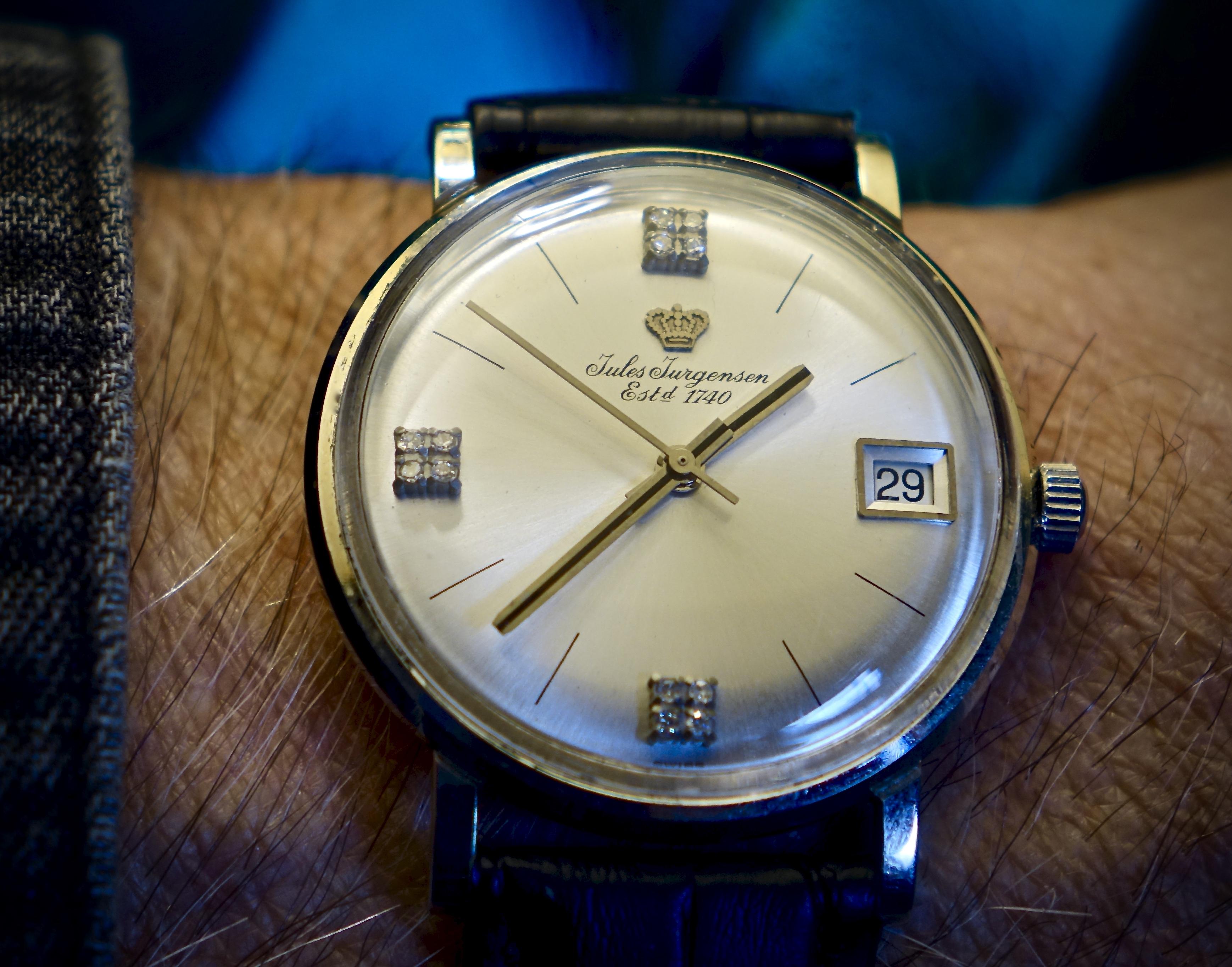

This watch was working up until recently when the stem came out. I can still insert the stem & wind but cannot set it.
I've tried all local watchmakers without any help. The Factory advised it was a 60's branded watch made here in the States.
I would love to get it repaired...fond memories require it.
Any help greatly appreciated.

That case looks to be what is called a monocoque case, aka one-piece. As Nucejoe says, it's probably simple. However, for a newbie the case will present a difficulty. The crystal has to be removed by using with the right sized clamping tool or blown out through the pendant/pipe, where the stem goes in.
It looks like a very nice quality, and quite striking looking, dress watch. Any jeweler/watchmaker that does anything other than replace batteries and sell earrings should know that it's a once-piece case that takes special treatment, but is not daunting. Sorry about your losing your brother.

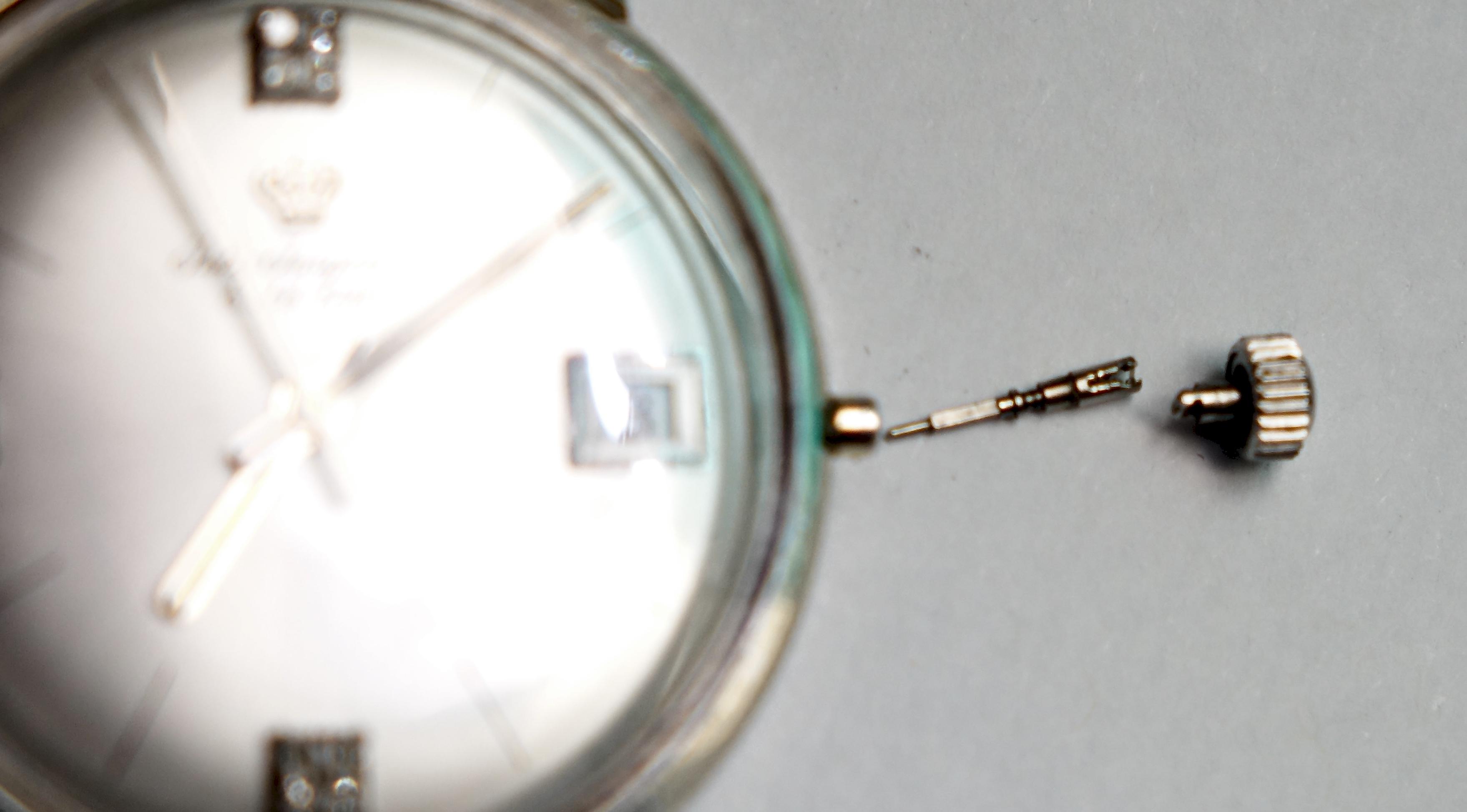

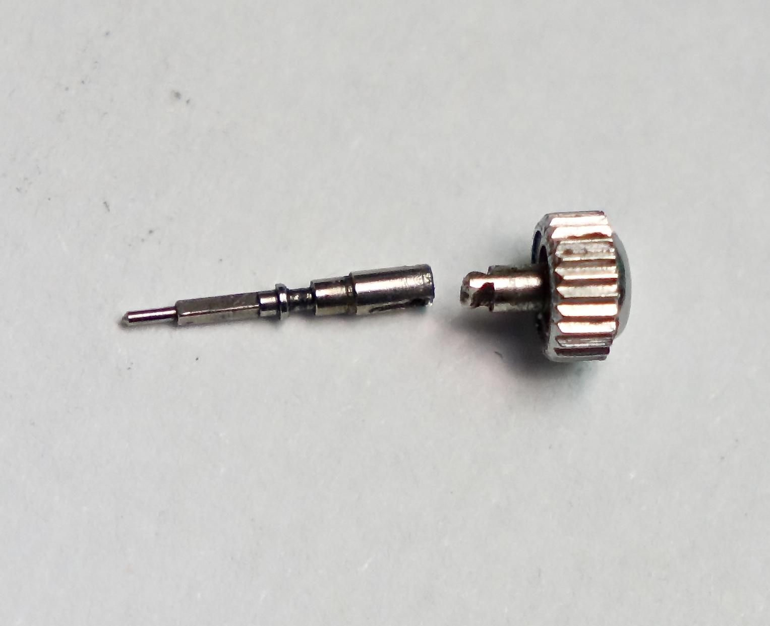

I’m wondering, since this is a “front loader” case, does this use a split stem? Quite often the male/female coupling corrodes or wears. Usually easy to replace.
Male part of two piece stems is to lock into the slot of the female piece. Stem winding but wont stay in, idicates widened female slot or broken male head. A pic of the stem can narrow the diagnosis down.
My WAG is that both pieces came out and then they came apart. I certainly could be wrong. Regardless, the movement will have to be removed in order to make it right again. You don't want to lose those stem halves, as they are rather hard to find.

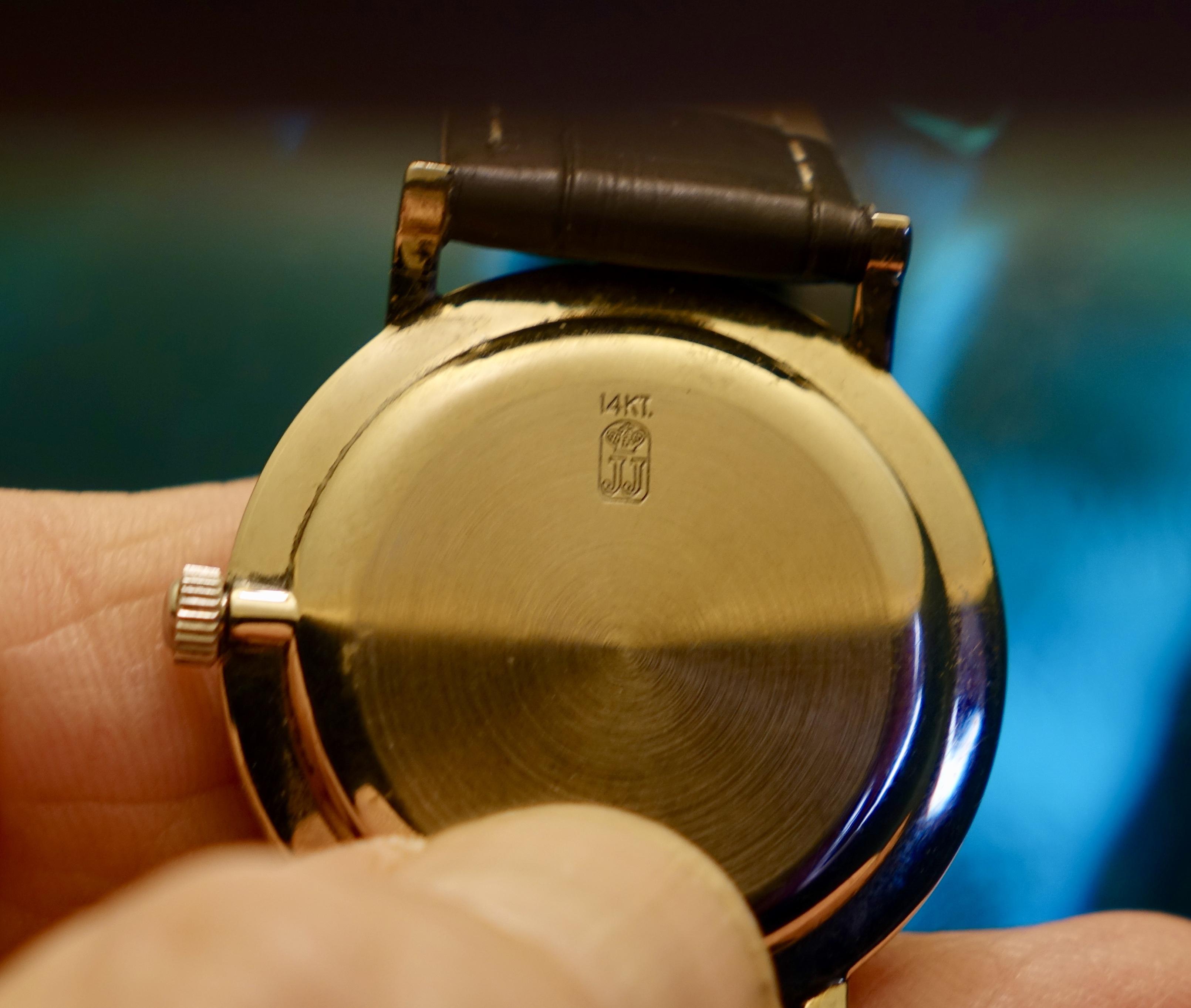

Here is all I know of the origins of the watch...I contacted what is left of JJ..
Thank you for the photos of your watch. I fully understand and appreciate its sentimental value and it appears to be in good condition. Unfortunately it’s US produced and we have no spare parts for it. However, I believe the watch is fitted with a standard Swiss movement and a local US watchmaker should be able to replace the broken stem.

Probably assembled  here.with a standard  or perhaps  more elaborate swiss movement.  Worth your time.as it is a nice watch with sentimental  value. I would  suggest that while having it repaired  you have it cleaned  and lubricated  as well. The stem is held in place by a lever which may be broken.my first guess would  be corrosion. The watch is stuck in the wind position. When an attempt to set it was made the lever snapped. But this is only a guess..any competent watch repairer  can do it. Unfortunately  I can reccomend  no one. If you do an image search on keyless works you should  be able to see how it works.it isn't at all complicated
