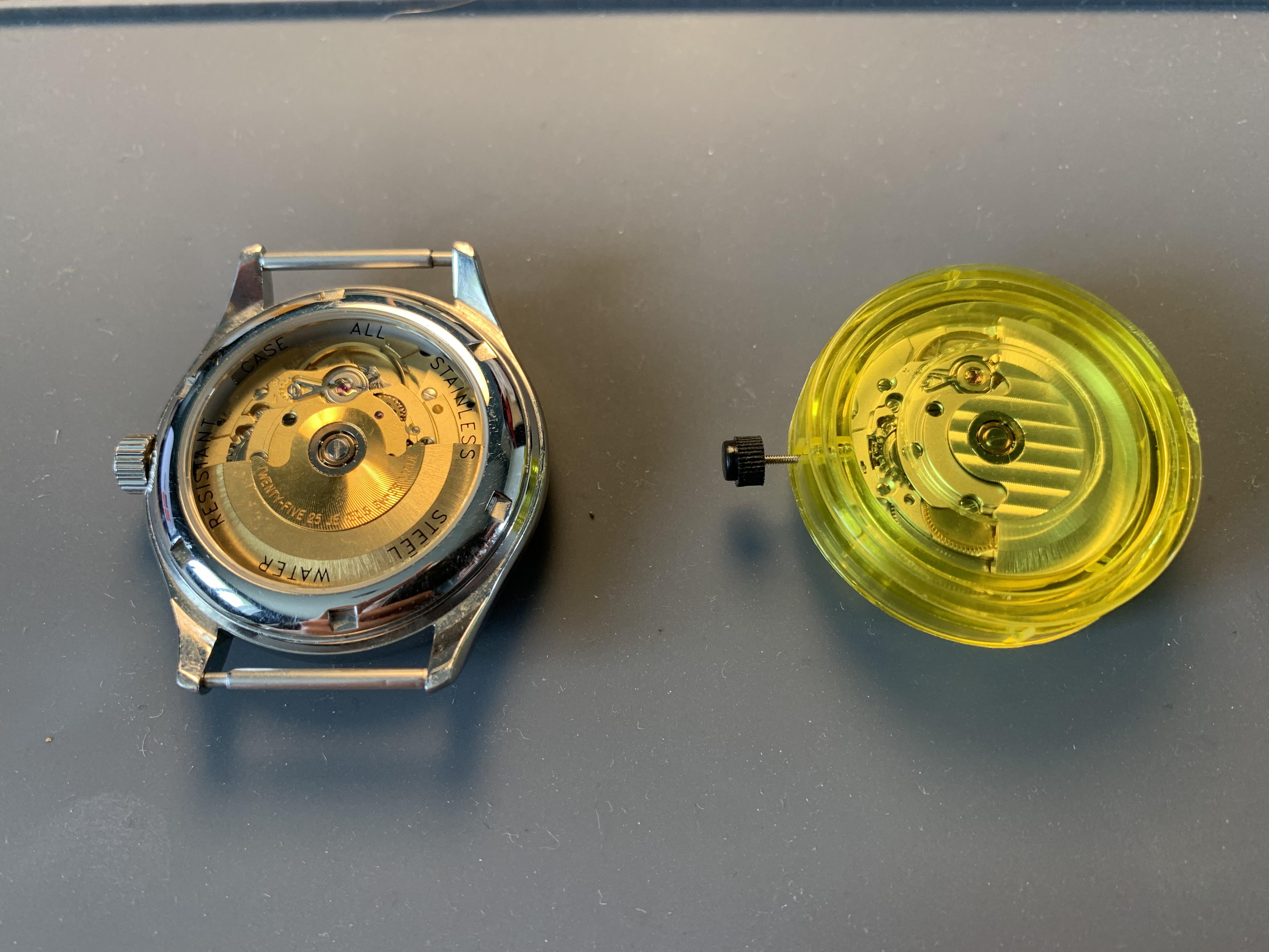

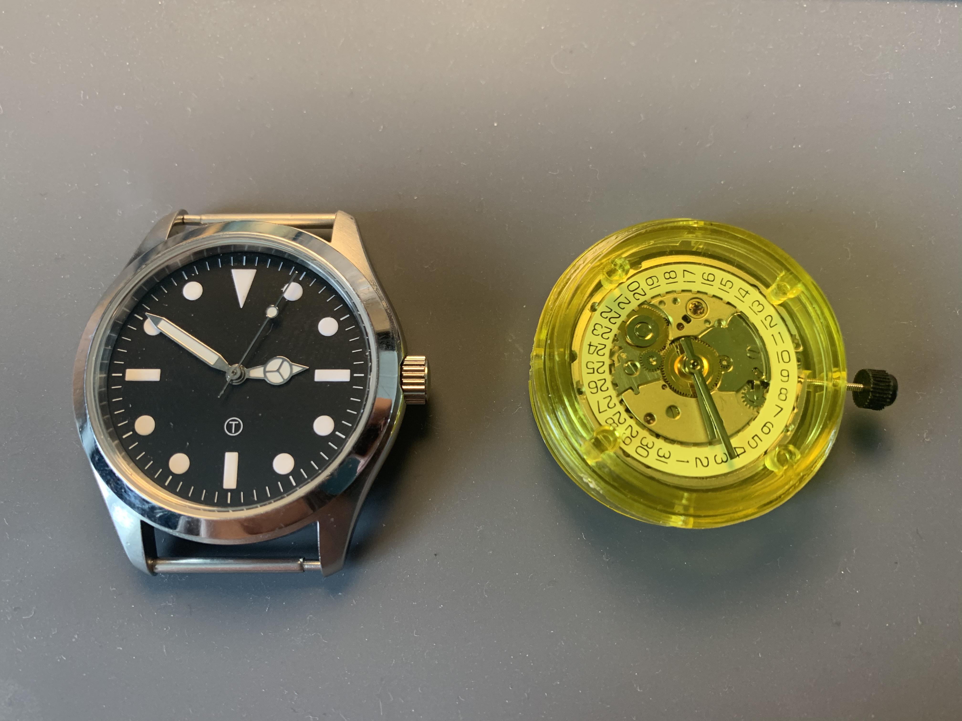

My cheap blue demagnetizer also arrived last week. This week I was looking for a Seagull ST2130 on eBay and came across a guy who was selling a brand new one alongside a generic divers watch containing a genuine ETA 2824 that was running 30 minutes per day fast.
The ETA was apparently "less than 2 years old, but suddenly started running super fast" He had bought the seagull to replace the broken ETA, but in the end decided not to proceed and sold them both together instead.
When they arrived I tested the Seagull which was still in it's transport packaging (+1.3s / day!) and the genuine ETA in the watch (+1600 seconds / day). The fine adjustment had been set all the way to the minus limit.
WIthout even uncasing the watch I ran it over my £11 demagnetizer in 4x90 degree rotations, drawing it slowly away each time until I could sense no vibrations (it is only the 50Hz alternating magnetic field that causes the "feel", there are no moving parts inside) and in less than 1 minute it was running at a consistent -112s/day without any regulation so far.
So it appears that my £11 investment could have saved me over £100 in its first 10 seconds. :)
Regarding the sticking, I think as others have said, the demagnetizer probably has worked, but the hairspring coils, initially pulled together by the magnetism, are now being retained together by any residue on the hairspring.
