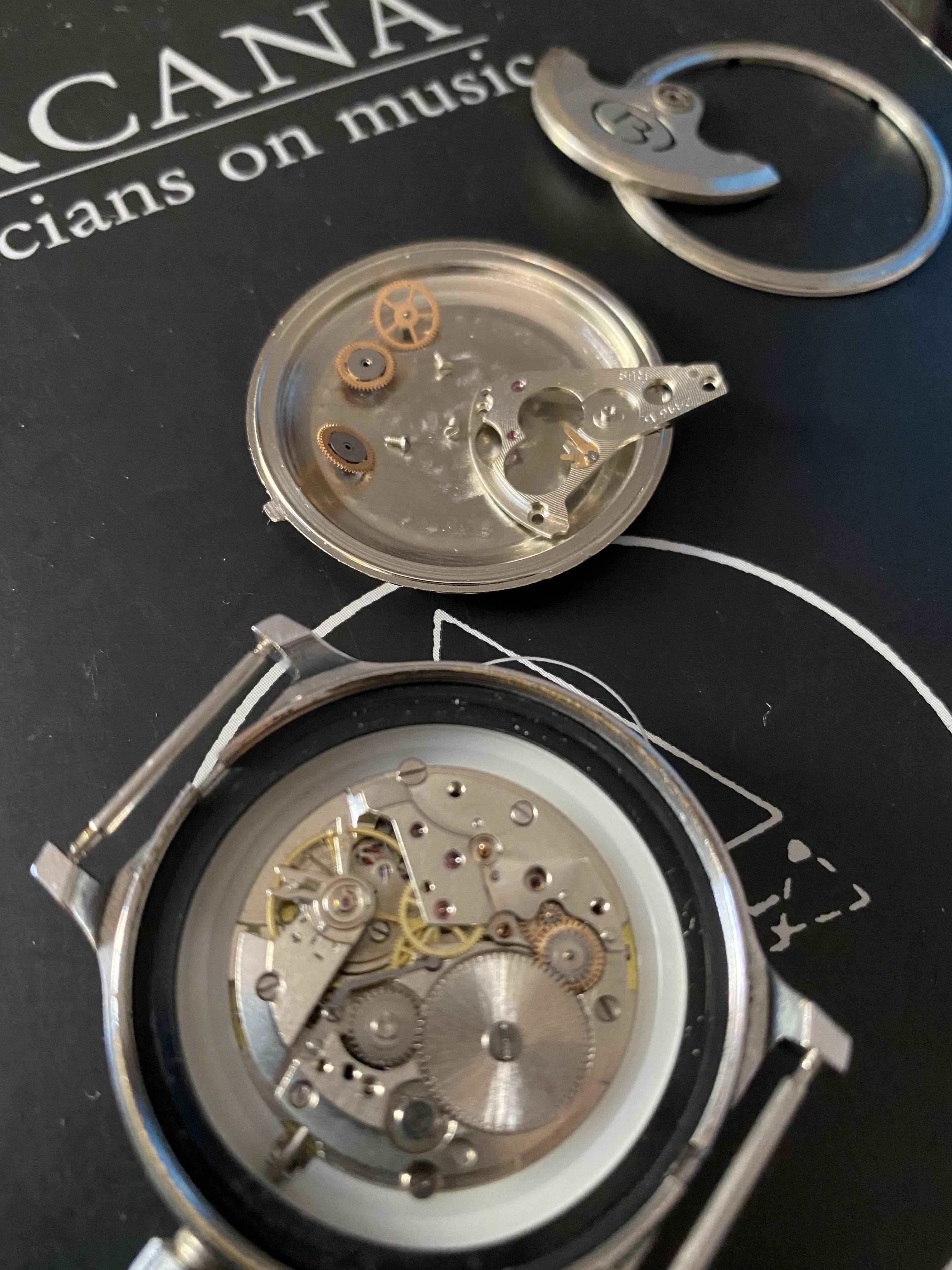

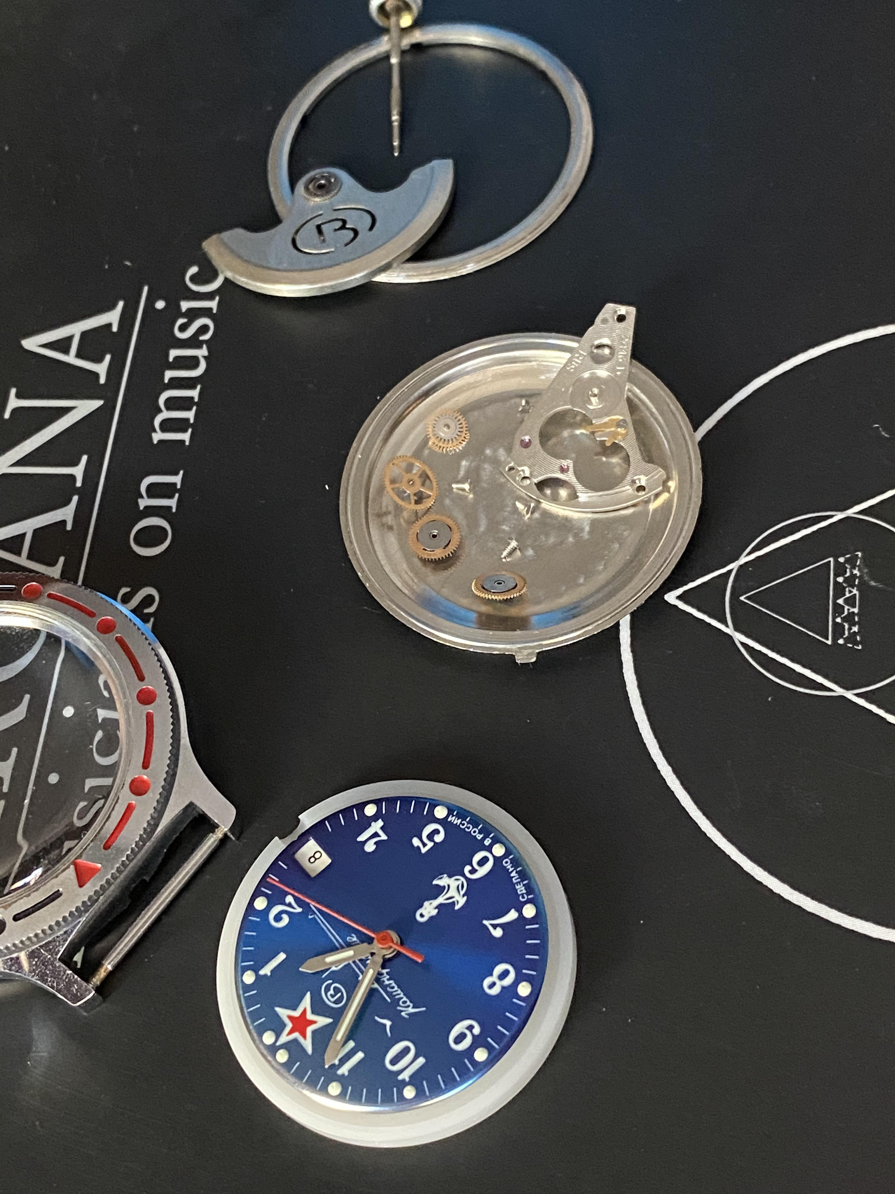

Komandirskie 2416b
Typically watch manufacturing companies will purchase parts to their exact specifications including the jewels. This means that typically you may not find an exact generic replacement. I'm attaching a PDF of a book that explains how to replace jewels. Seitz book.pdf
