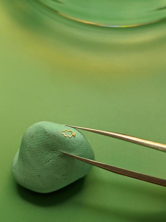

Have a couple of days not working, so setting off on part 2 of the lessons, really enjoying myself, only slight hiccup early on was the incabloc top spring came out completely when removing the balance pivot jewel, pinged it across room 4 times (but by some miracle located it each time :)) and finally got it safely back in place, only keyless works to go. I'm not taking the mainspring out of the barrel as I don't have a winder to put it back in.

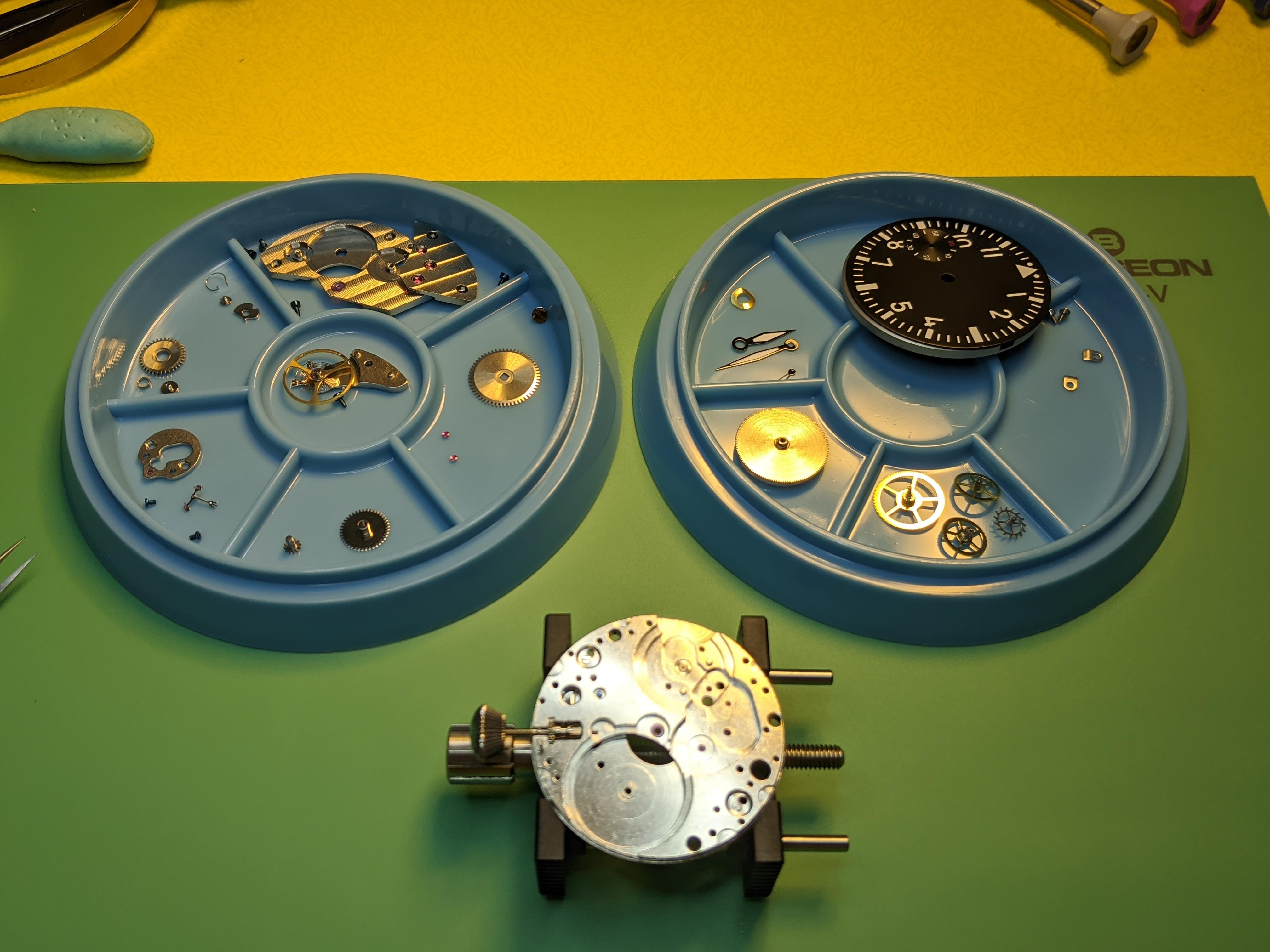

Back together... and running. Was a good job I followed advice to photograph disassembly process, this is a slightly different variant to the one used in the course demo, the keyless works are 90 degrees out of position, and the train is slightly different too, the 3rd wheel sitting below the 4th rather than above. The incabloc setting jumped out on me again on reassembly, I've definitely taken a dislike to them! But those aside, have really enjoyed today, going to let it sit and see if it is still running tomorrow.
