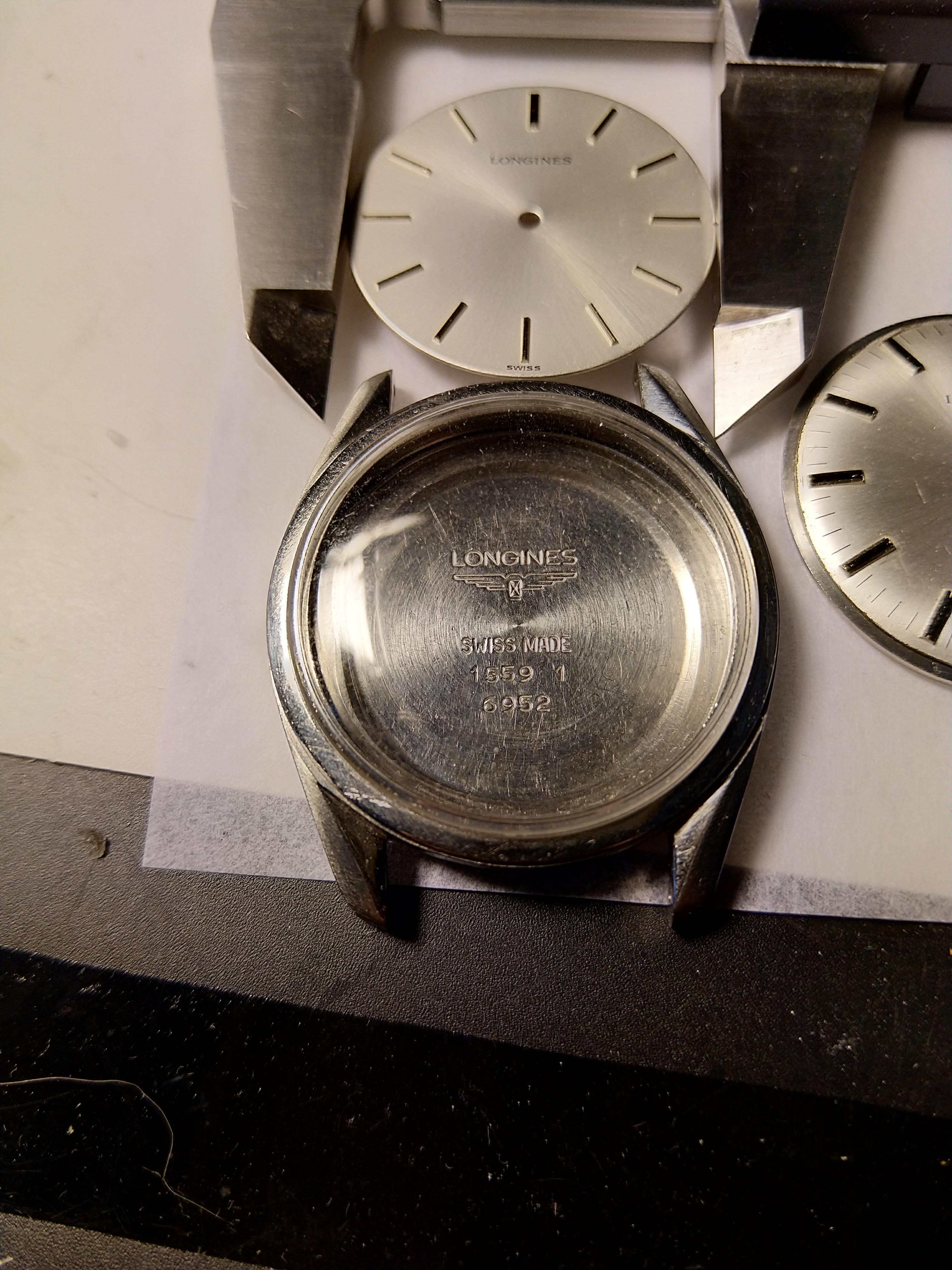

As you see in the links there seems to be two different versions of the 6952 movement case in the first link is stamped 6952 but I actually think the back is correct while the case is for an domed 441 movement and dial. (These has different positions on the dial feet too and smaller)
The second link should a better case.
But one should always ask the seller which diameter of dial it takes before bying since there is smaller dial diameters too. But what I seen from Matts work I'm quite sure he knows about all these basics.

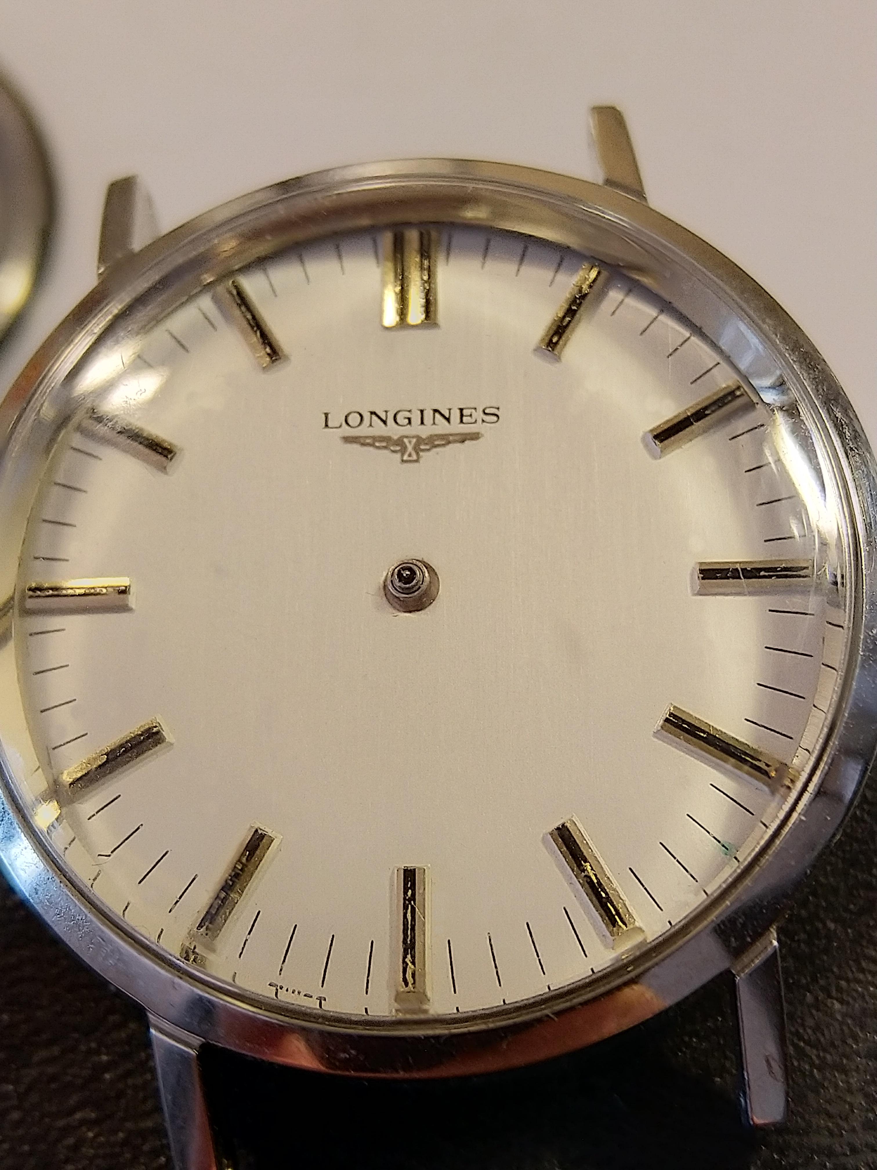

So when he asked about the stems I took a quick look at his Longines and didn't know if it has a flat or curved dial,  but I assumed by the picture it probably has a flat dial so out I went to the testpit.
The dials on all my 6942 are flat... the movement is not, but this is how they came (have a bunch of them).
There is no surprice the 6952 is flat too.. Same size.

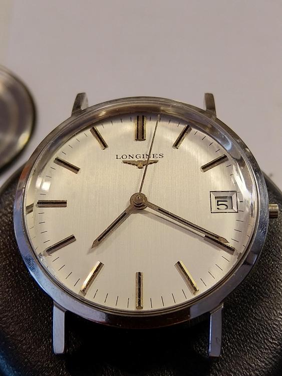

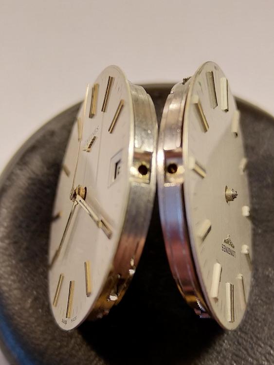

So next we pop them into the case and they surprisingly fit the same ( No movementring or caseback was used for this quick test.thats why one see the small gap in the top) The case has a dome crystal.
6942 No Date.
6952 With date.
The holes of the stems alignes at approximately 2.5mm so the stem fitts through the tube.
So it seems atleast they tought of this at Longines.

I took a look in my "to fix box" and to my surprice I found a case of the first type with 6952 marking on it, obviously needs a new tube.
It will fit a 6952 with a curved dial unfortunately I only had dials for it to the 6942 to test with.
And it only take a dial up to a diameter of  29.5mm to 29.8mm. quite odd ones.
Edited by HSL
