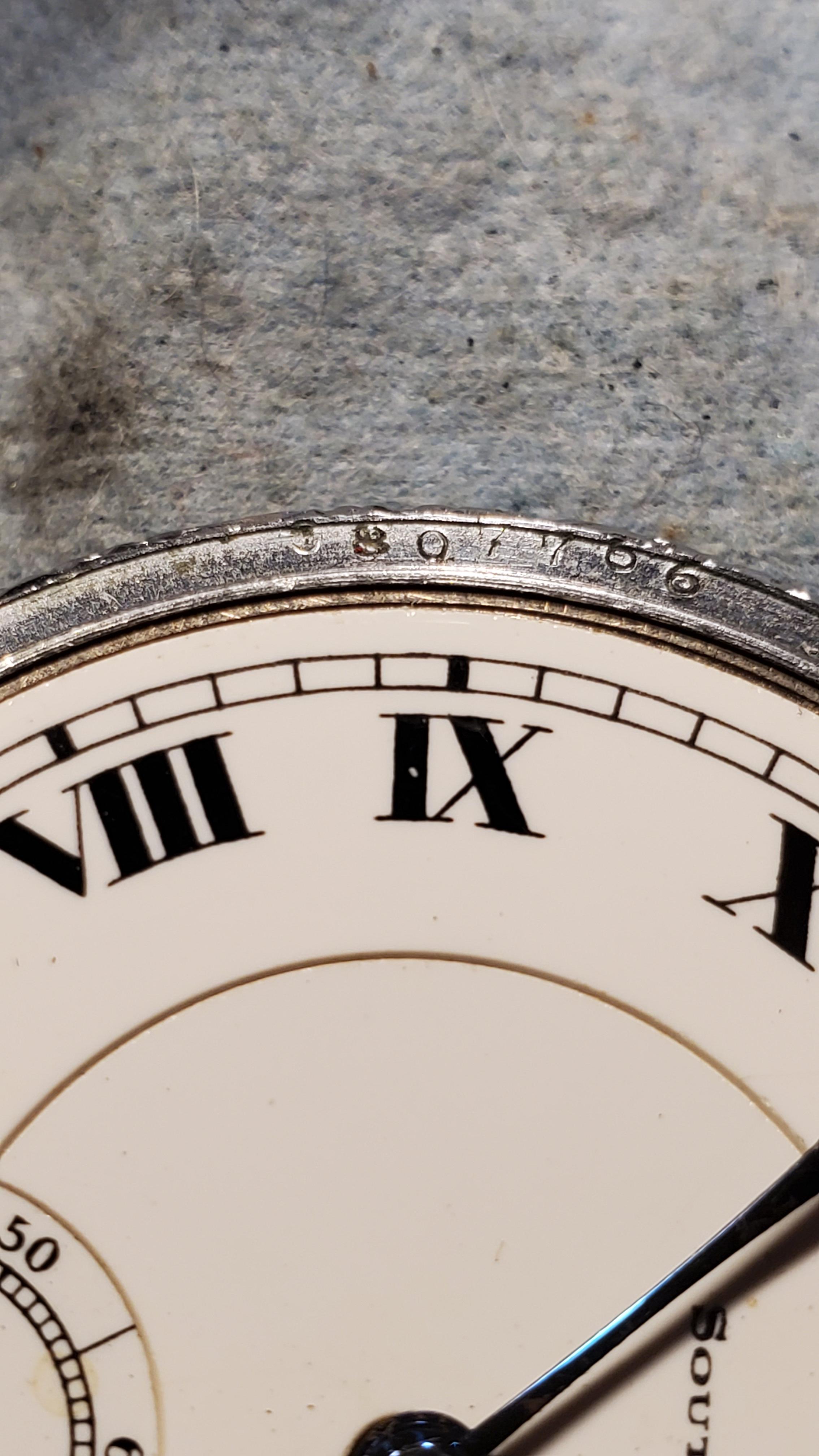

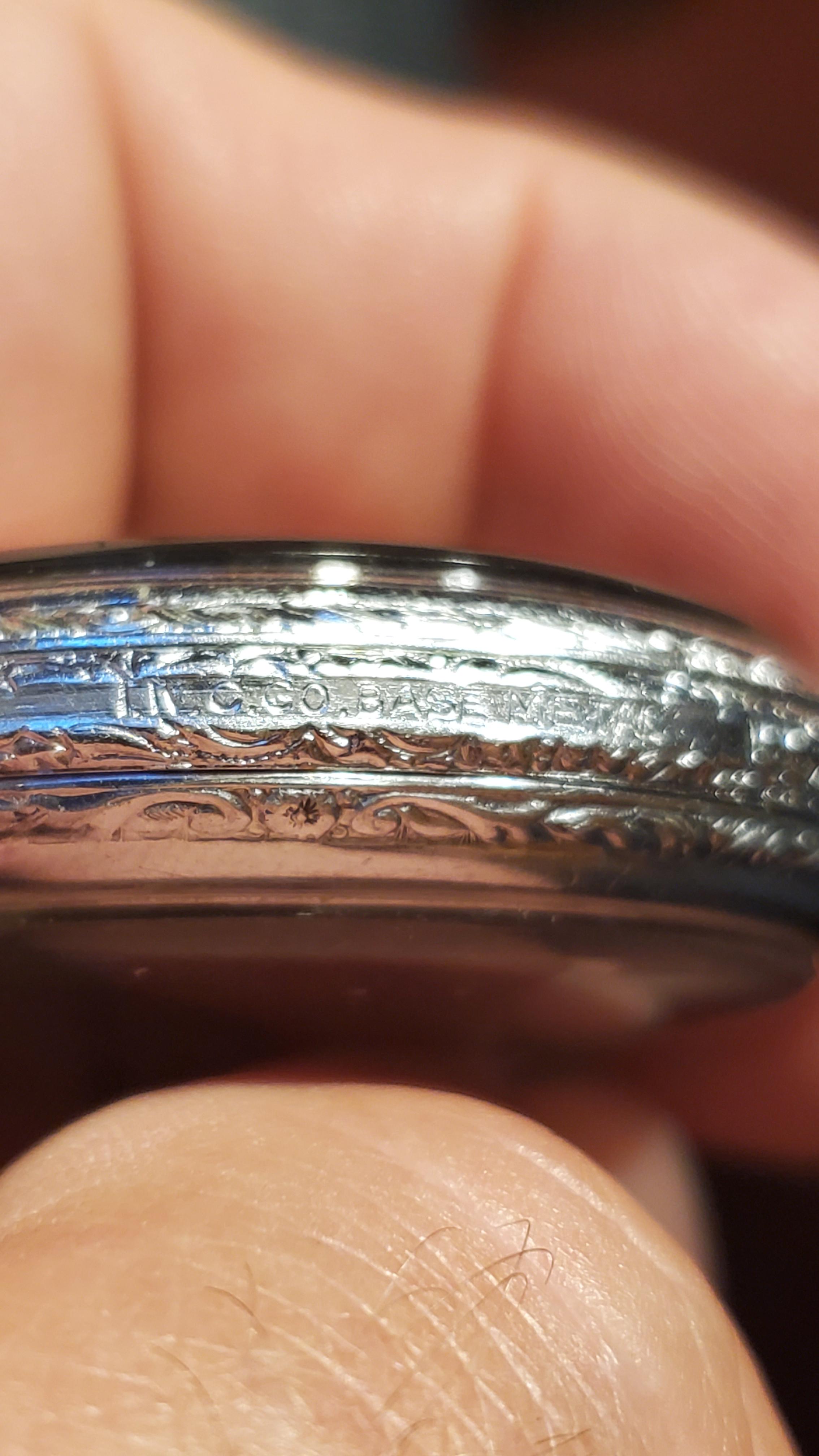

Funny, I had the exact same issue with my South Bend which is also in a Salesman's case. One screw had been replaced, and when you tightened the cover all the way, the screw head, which was slightly domed, would cause the crystal to pop out. Took a bit of close up investigation to discover what the issue was. GORGEOUS Hamilton btw!

The Salesman Case is actually from 2019 Classic Watch Case company and not a vintage case, however, no problem because it will be durable and I plan on keeping this for a very long time. I removed the case screws and the back now fits. I may just shave them down or modify the case in my lathe to accommodate the area needed for the screws. Open the crystal on your case and you will see “CWC Co “ on the top and a serial number on the bottom. Your case is also a remake of a vintage case I would bet. This company has one currently on sale for $180, so not cheap.

Geez! Those cases cost more than double what my entire watch cost!:startle: You were spot on @jdrichard, my case is one of those.
