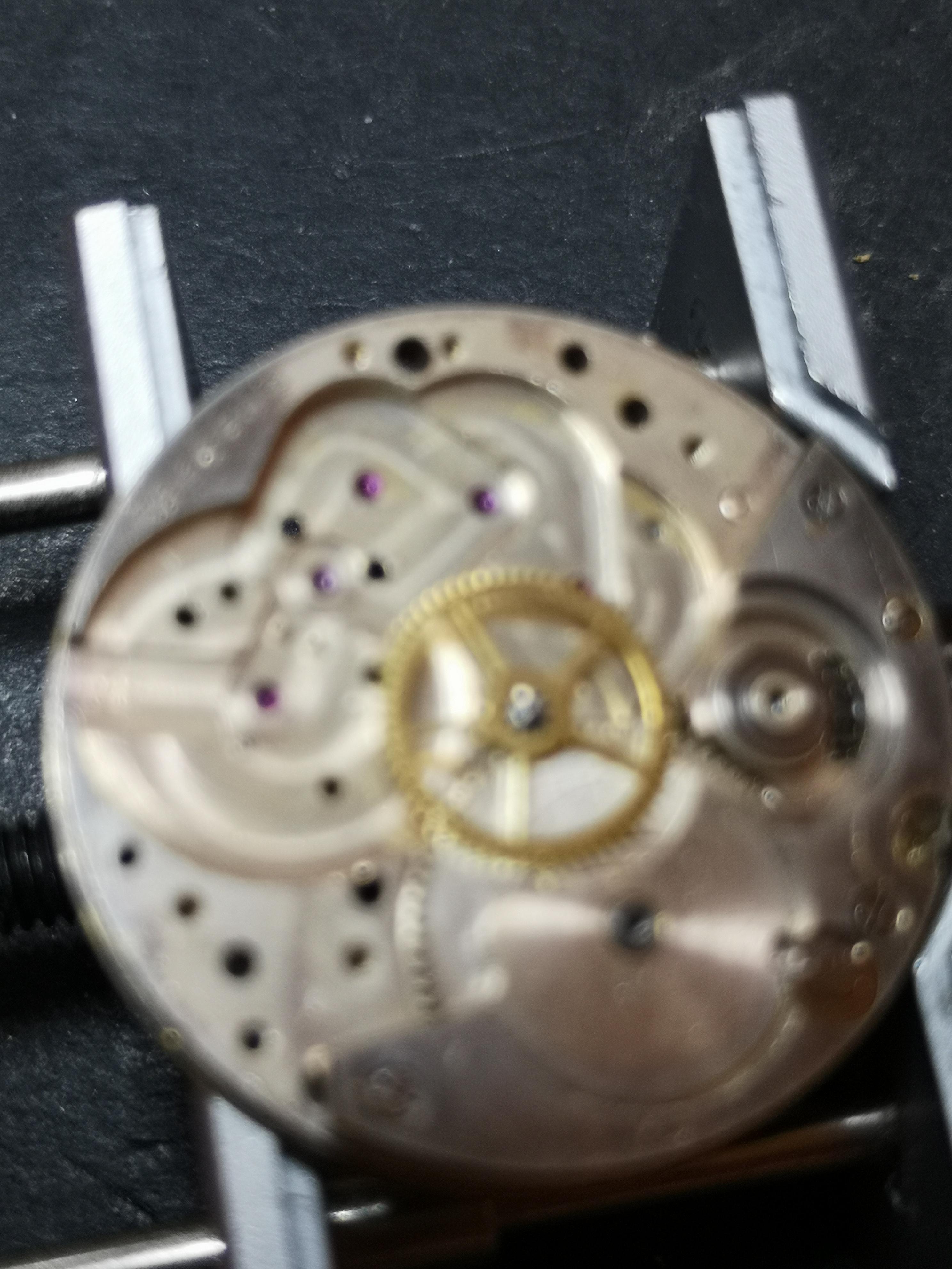

tissot cal 27
Typically watch manufacturing companies will purchase parts to their exact specifications including the jewels. This means that typically you may not find an exact generic replacement. I'm attaching a PDF of a book that explains how to replace jewels. Seitz book.pdf
