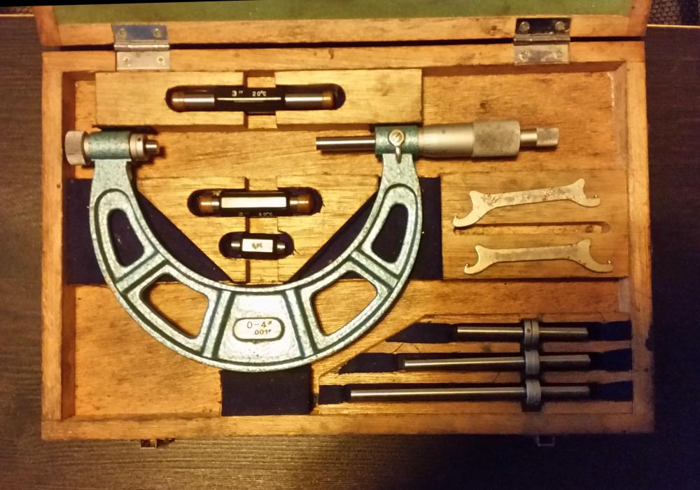

With a conventional mechanical micrometer, like the ones shown, while the zero point with the anvil closed can be set up by the operator using the small 'C' spanners usually provided with the instrument,  the ultimate accuracy along it's operational measuring length is determined by the pitch accuracy of the lead screw in the barrel, there is usually means of tightening the nut to lead screw pressure with an adjustable collet arrangement on the nut. If you are attempting to work to tenths of a thousandths of an inch, ambient temperature will make a small difference to accuracy.
I have this fairly ancient 'Draper' 0-4" caliper mic. set that has the replaceable anvils and the set up test pieces, which specify length accuracy at 20 degrees C.
Edited by JohnD

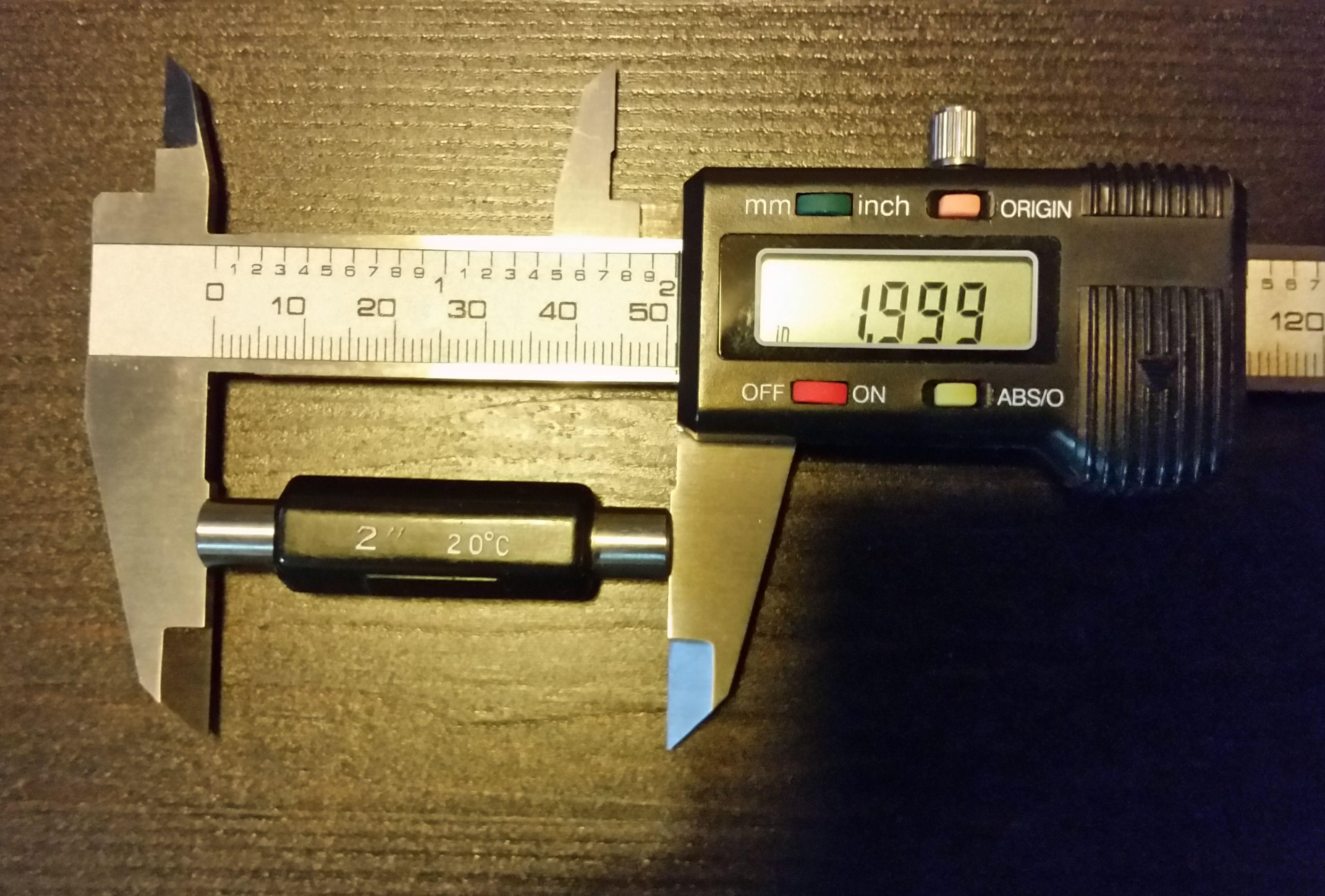

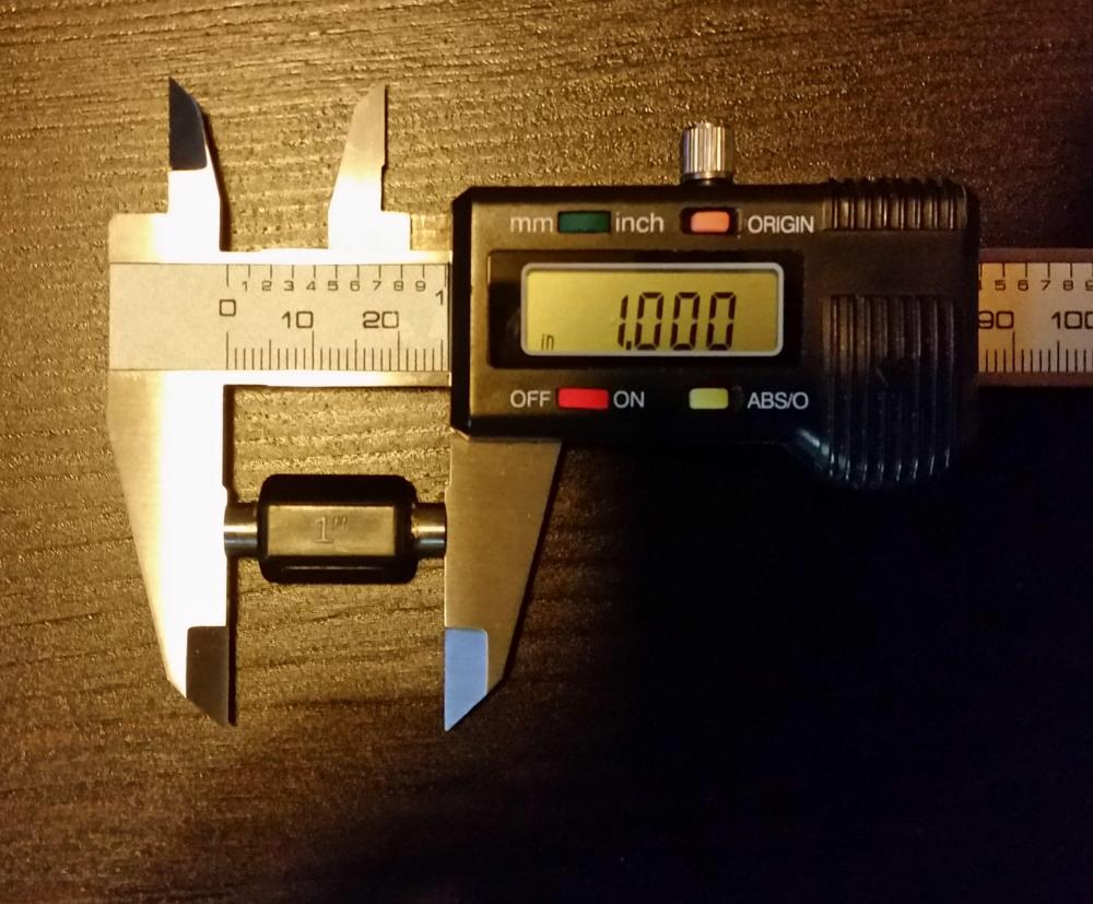

Just did some tests on my Roebuck digital caliper, using the Draper test pieces....
For each test I closed the caliper first and checked the 0.000" reading then opened it up and placed the test piece in and closed it till it was lightly clamping it...
1" Test.... spot on
2" Test....minus one thou
3" Test....minus 5 tenths of a thou
Ambient temperature 28C
Quite pleased with this :thumbsu:
