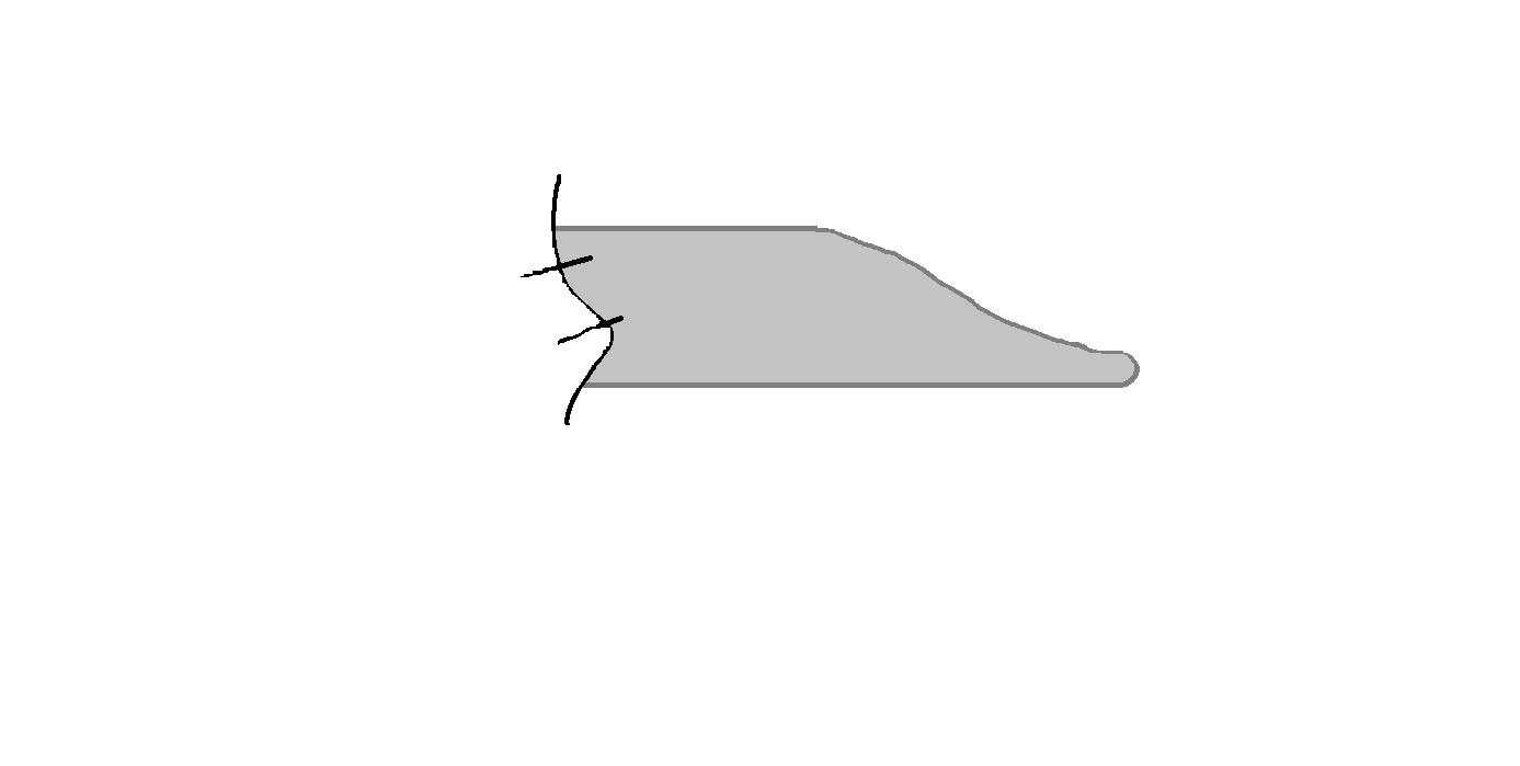

I would appreciate if some experienced board members could lend some advice regarding a work surface.  All I have in the "plans" is flat, with a border around the sides and back.  I don't know if it should be light or dark, very solid or sacrificial (replaced easily), treated with a varnish, urethane, or just oil-rubbed.  The rest of the bench so far is simply oil-rubbed.
Please; any words from experience about the work surface or any other facet of the bench moving forward would be very helpful to this beginner.
So I've completed the flat portion of the work surface.  Funds dictated no more hardwood, so pine it is.  It's somewhat soft, but is very pleasant looking.
I think I've decided upon a Roman Ogee router bit to create the "prison walls" for the sides and rear of the worktop.
They'll fit into a rabbet and will be flush with the outside dimensions of the top.
Are you going to route a little 'trench' across the front edge of the top to catch anything that trys to roll off the front?
Coming along nicely.
Now that you mention it, yes, Tmuir.  I wouldn't have if not for your suggestion.  I have router a bit that does a semicircle, I'll set it to barely penetrate the top wood.  Enough to do the job.  I'm also wondering how I'm going to slope the fronts of the prison walls downwards.  Maybe a french curve?  Template?  Not sure yet.

I've been watching this from a distance. I have done quite a bit of fine wood working, mostly of a luthiery flavor, but also some fine furniture. If all you're after is a gentle curve on a single piece like that, and you're not interested in repetition across multiple components or production run, you would probably find yourself best served (and best enjoyed) with a curved sole hand plane. Assuming you don't already have a profiled router bit ready to go (and your router is powerful enough to do such a large cut in the first place), the setup time on the router is about how long it would take to just bang out the same operation with the plane. You could just freehand whatever comes to mind in the moment, and it'll look great. As a bonus, if you can't keep it clean and don't want to follow with a scraper (same relationship as the plane to the router as below, but with sandpaper), your worst case scenario is very in vogue right now with the "hand scraped" look (even though that's not what that is).
Additionally, planes are quieter to save your ears (I saw those amplifiers on the side of the photo, so you likely care at least a little about your hearing), and the shavings fall directly down and are easier to clean than the router dust which goes EVERYWHERE for DAYS. Just a suggestion. Do not try to plane plywood... It'll ruin your iron, the plywood, and your sanity. Practice on a piece of scrap wood at least to get your iron set properly, and generally try to avoid low grade pine (the alternating hard/soft of the wood combined with it never being dried even halfassedly makes it especially challenging, and no one really likes pine much in the end). On the tiny probability that you're in the Denver area, you're welcome to come up here and I'll show you the ropes.
https://www.lie-nielsen.com/products/convex-sole-block-plane?path=block-planes&node=4072
This is a new, high quality curved sole plane. It's a little small, but it'll get the job done. This is one of the first planes I bought, and I use it to carve archtop plates. Lie-Nielsen essentially reproduces antiques, so a used one can be found and rehabbed for less, but it's a hunt and a project unto itself.
If you wanted to go convex instead of concave with your trim, you might consider a plain old block plane. Good to have even in a power tool shop. A step from that, if you're really good at sharpening chisels, you can make an ad hoc plane (there's a guy on YouTube that shows this... Something Sellers... Peter or Paul?). If you're even better, you can use a chisel freehand in a plane capacity (I did something like this just yesterday). Over a long distance and a large piece, you REALLY need to be good since there's not much keeping things straight.

Thank you for all the great information, Spectre6000.  If you haven't noticed, I'm figuring out things as I go along.  I bought an inexpensive set of router bits from eBay and will use an Ogee for the retaining walls.
For the form part closest to the front, I'll either freehand something or use a French curve, cut a template with MDF, and use a flush trim bit to duplicate it on both sides.

I made the retaining walls at first with a router bit.  I bungled up the job very well and Spectre6000 reached out a few posts above.  He introduced me to the concept of, dare I say, hand tools.  With a $19 block plane, I salvaged a burnt set of rails and made it into something that looks satisfactory.
There is something VERY satisfying and organic about that little plane.  One swipe, almost there, another swipe, that looks better, third swipe, hmm. . taking shape, next swipe. . . you get the idea.
Thank you, Spectre6000!  Because of you, I now know how I'm going to make the sides and back with only one width of 2 x 4 to keep the plywood with oak veneer arrow-straight.  Imagine that, a lap joint.  No sawdust and oldschool excitement.
