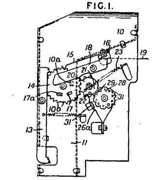

772,762. Coin-controlled savings clocks. TIME SAVINGS CLOCK CO., Ltd., and METAMEC Ltd. Nov. 4, 1955 [Nov. 15, 1954], No. 33016/54. Class 27. In a savings clock in which a control wheel 14 engaged by a pawl 15 is turned stepwise away from a position in which it stops the clock by the insertion of coins down a shoot 11 and is returned to stopping position by the clock mechanism, the coins act on a spring- loaded lever 13 and the control wheel acts on a stopping lever 18 through a pressed-out tongue 17. The lever 18 extends through the gap formed by a tongue 16 pressed out of a back plate 10 to receive the pawl 15 and carries a blade spring 19 engageable with a part of the clock mechanism, such as a pin on the balance. The control wheel is returned to the stopping position by mechanism comprising a co-axial shifting wheel 20 and ratchet wheel 21, each toothed over one half of their circumference, and a disc wheel 28 connected to the clock mechanism. One or more pins 29 can be inserted in holes 31 in the disc wheel, to vary the rate of return of the control wheel, and they rotate the shifting wheel 20 stepwise through half a revolution to tension a spring 23 until the plain part of wheel 21 comes opposite a pawl 26a, when the spring rapidly completes the revolution of the shifting wheel and a pin 22 extending between the shifting and ratchet wheels returns the control wheel through the space of one tooth. The pawl 26a is held clear of the plain part of wheel 21 by a pressed-out tongue 31. The control wheel has a wide tooth space 10b to prevent further rotation after a predetermined number of coins have been inserted and also a pressed-out tongue 17a engageable with a stop 10a to limit the return movement of the wheel.

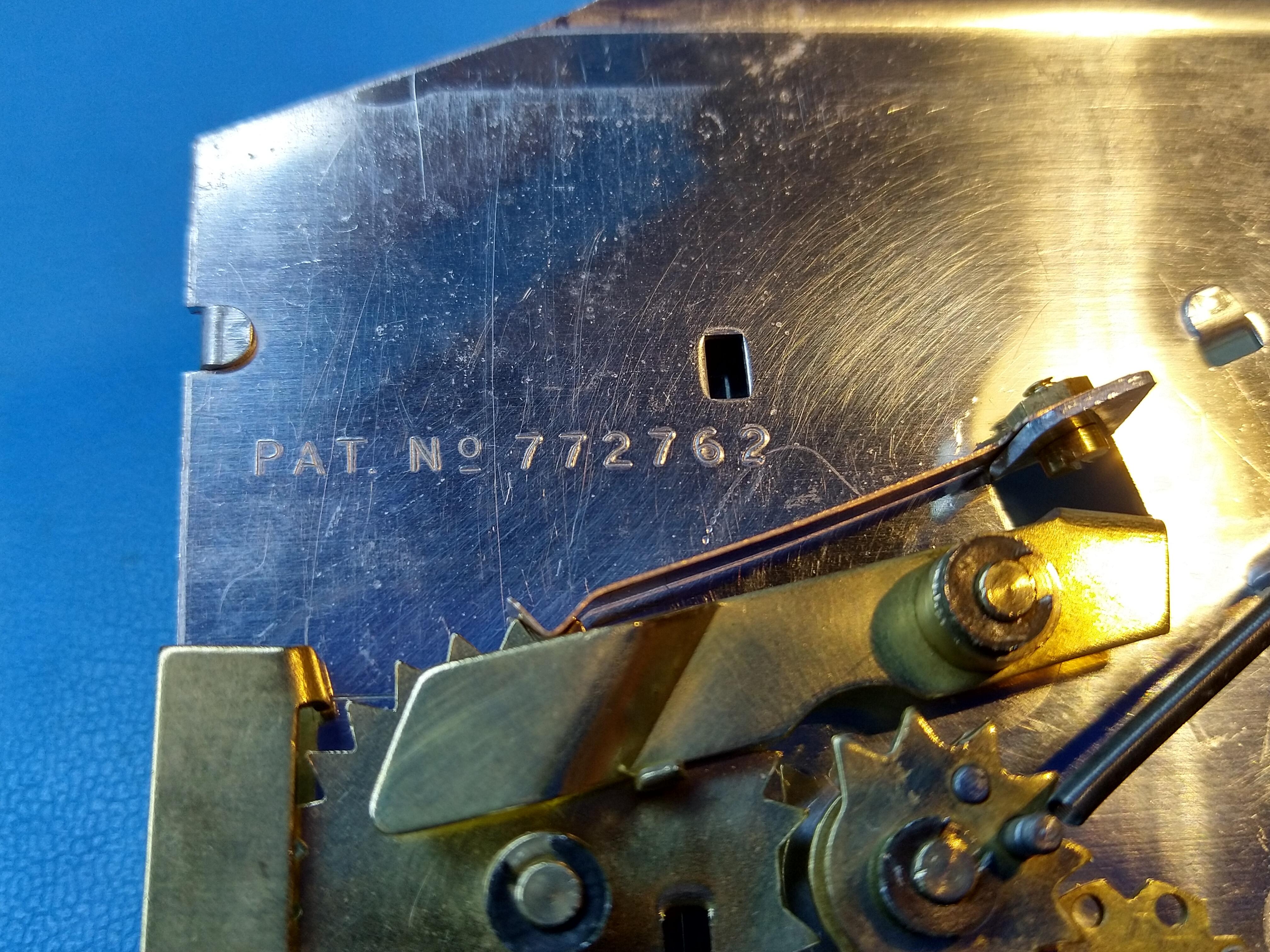

This is where I found the info: GB772762

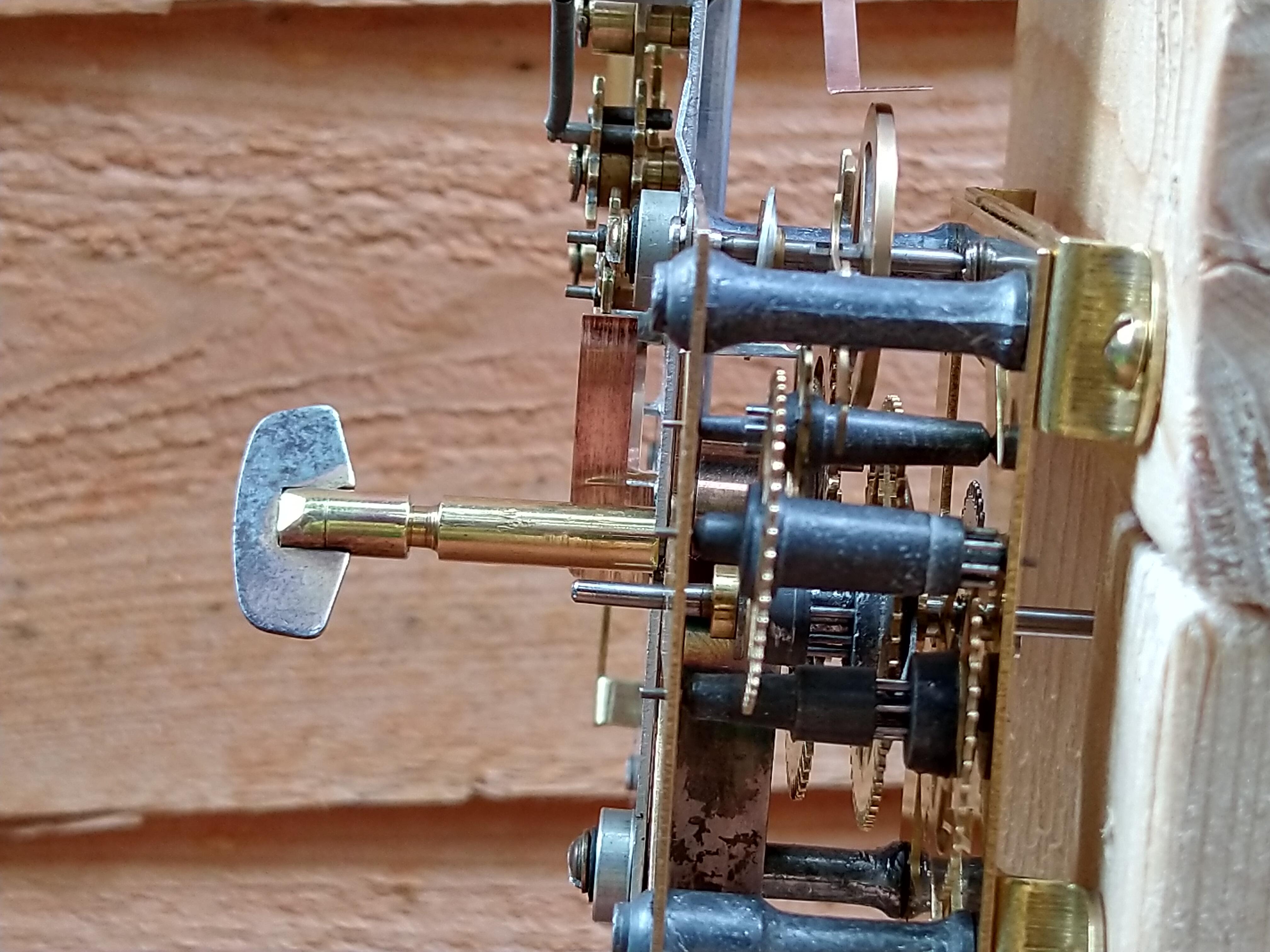

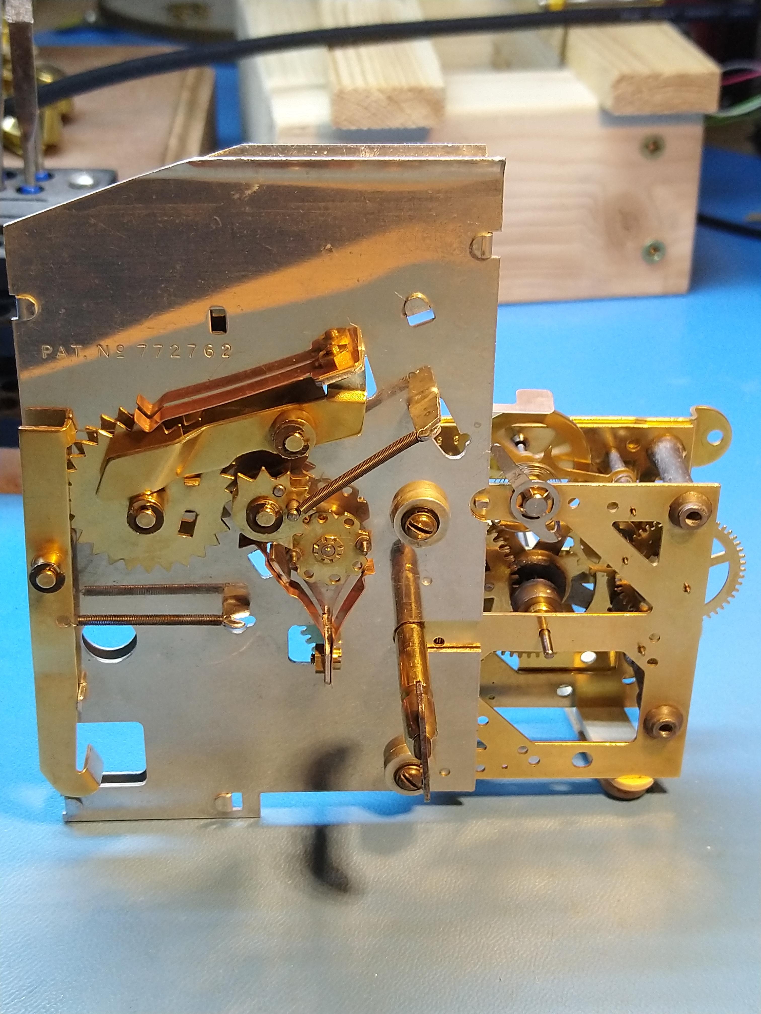

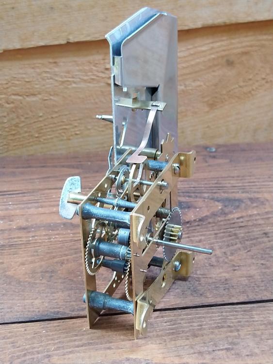

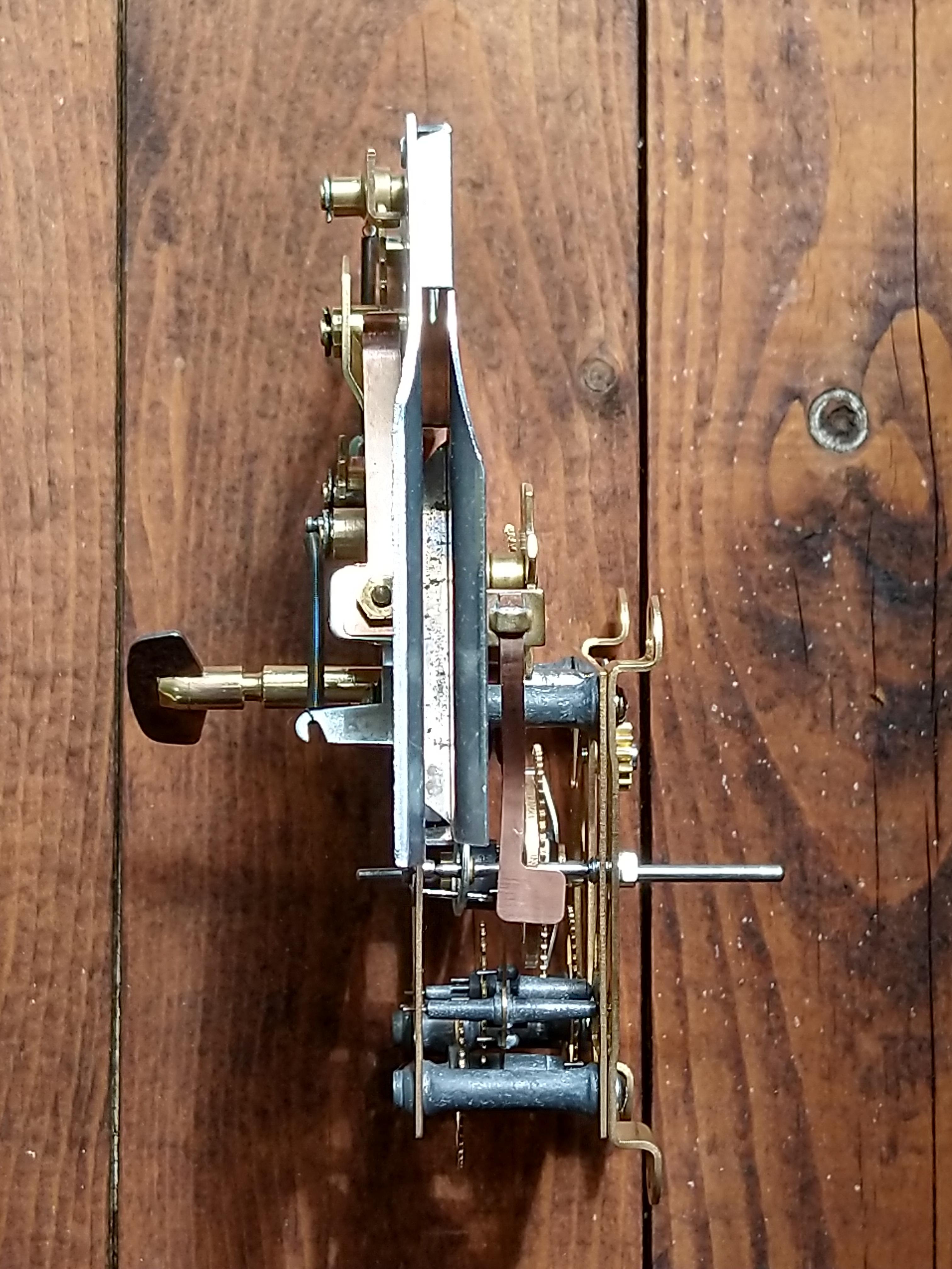

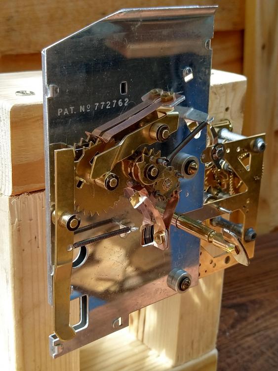

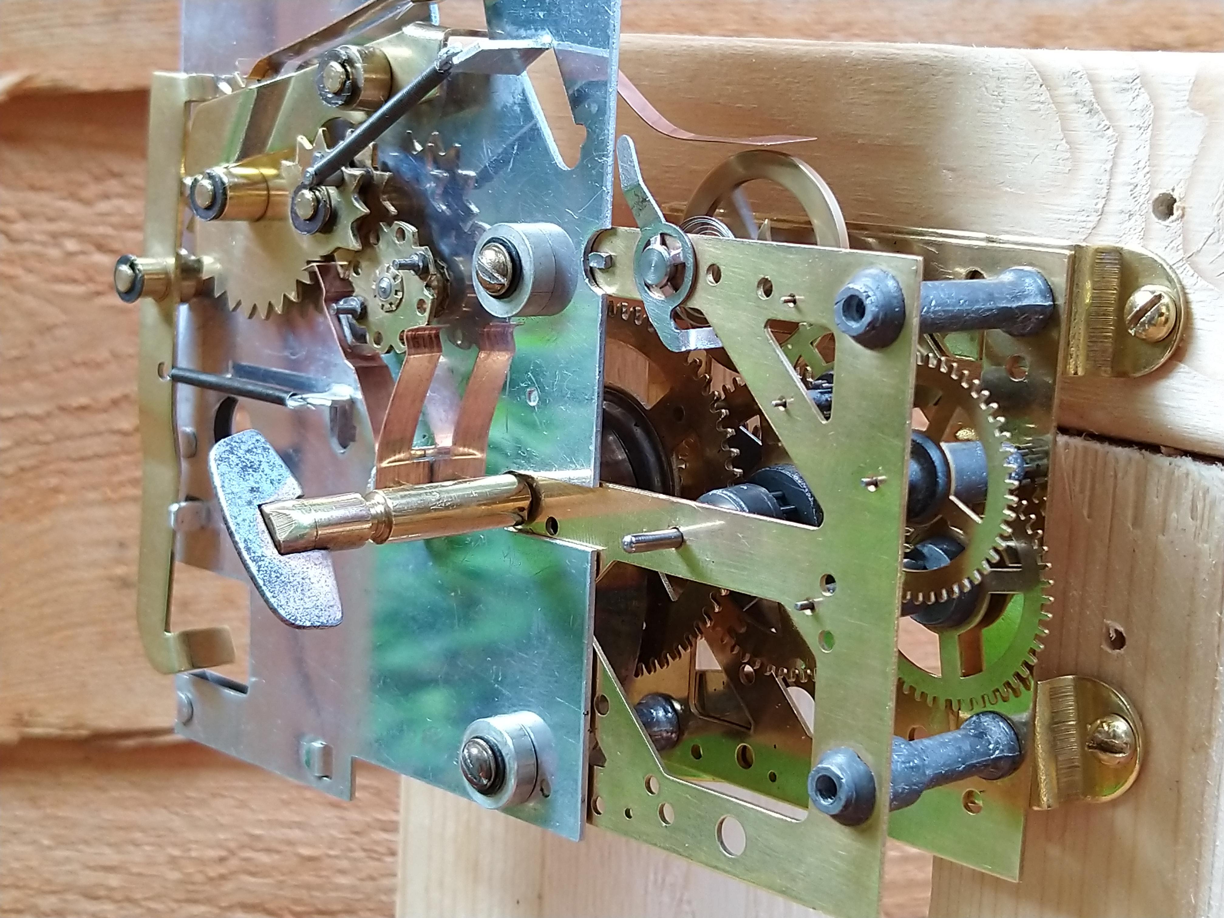

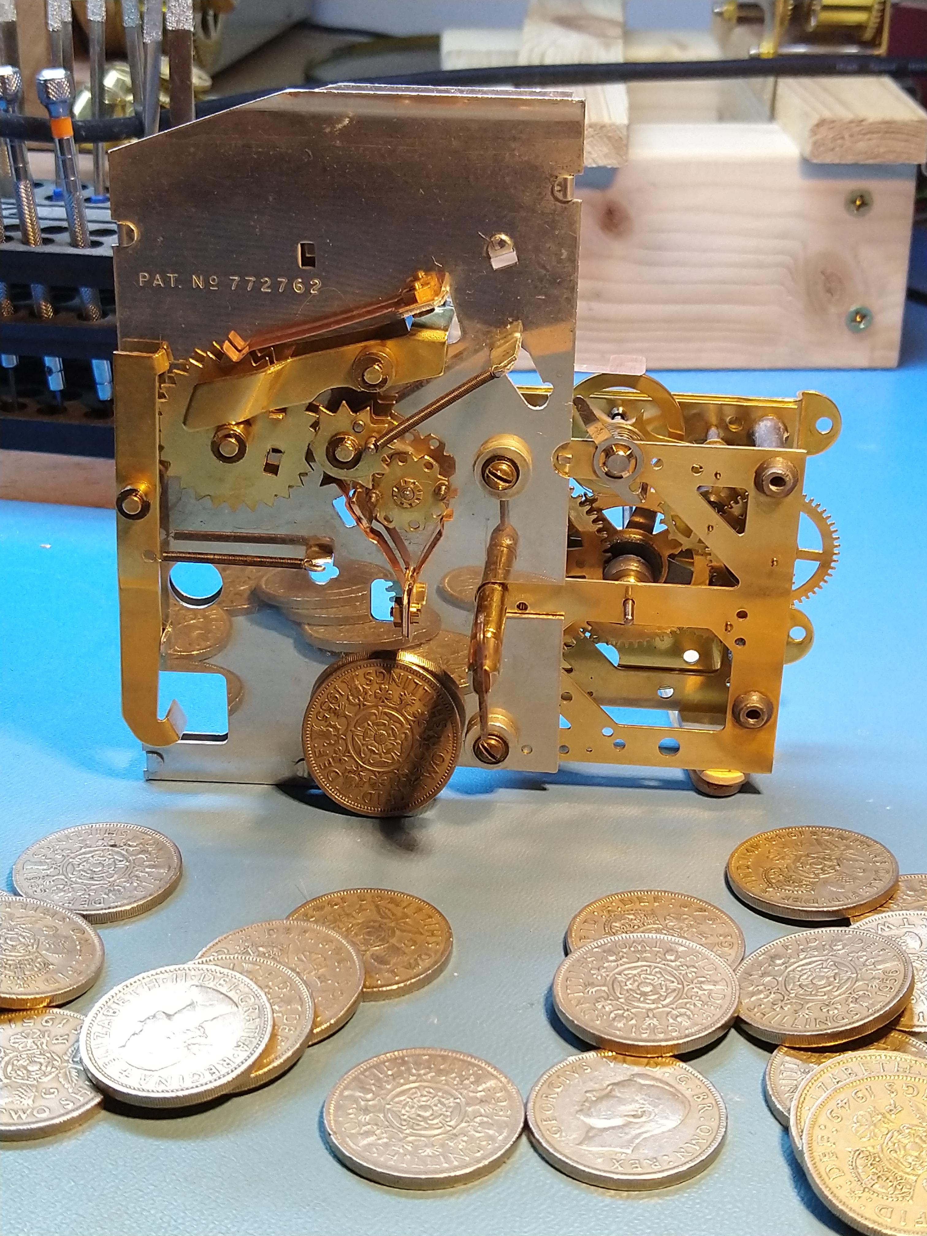

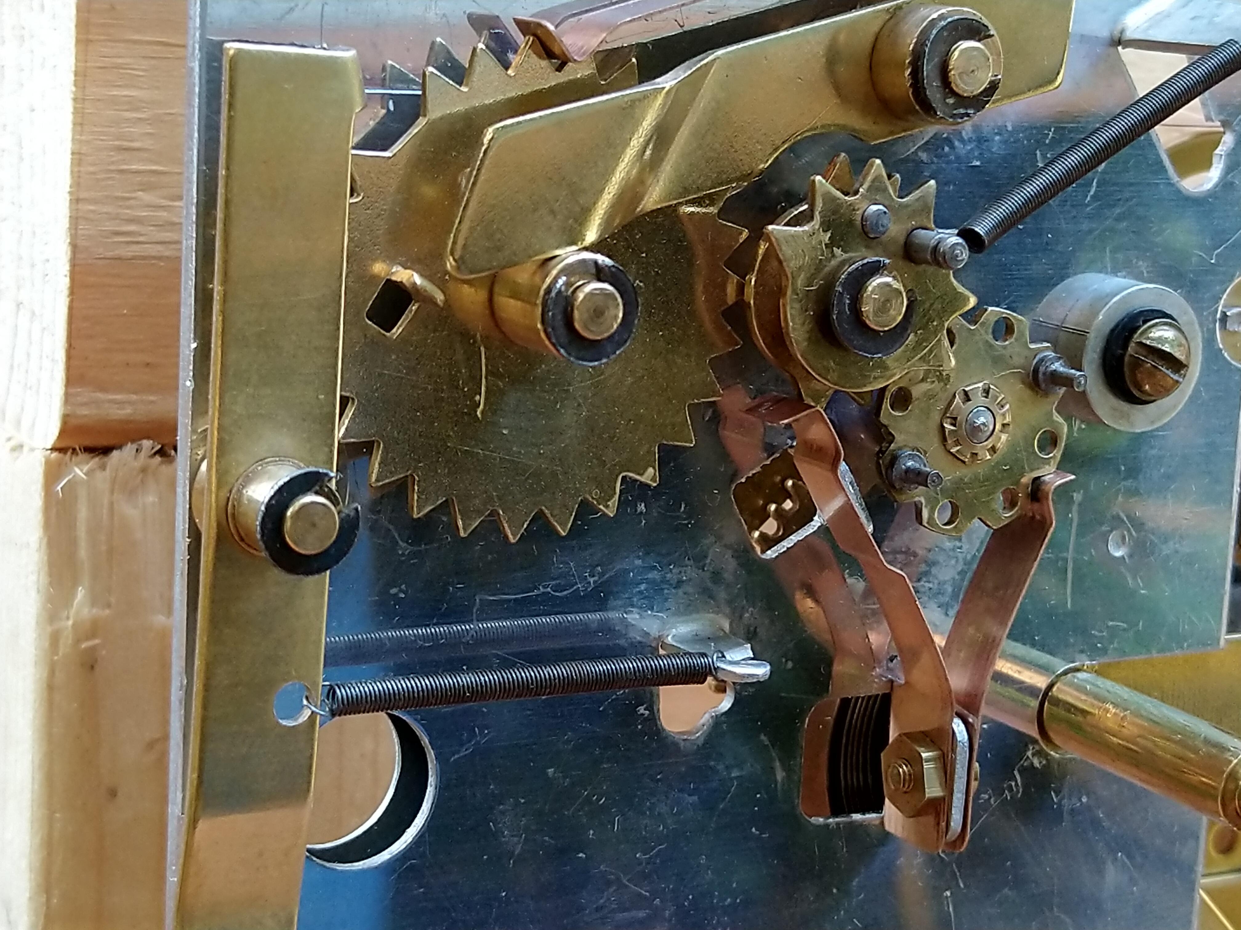

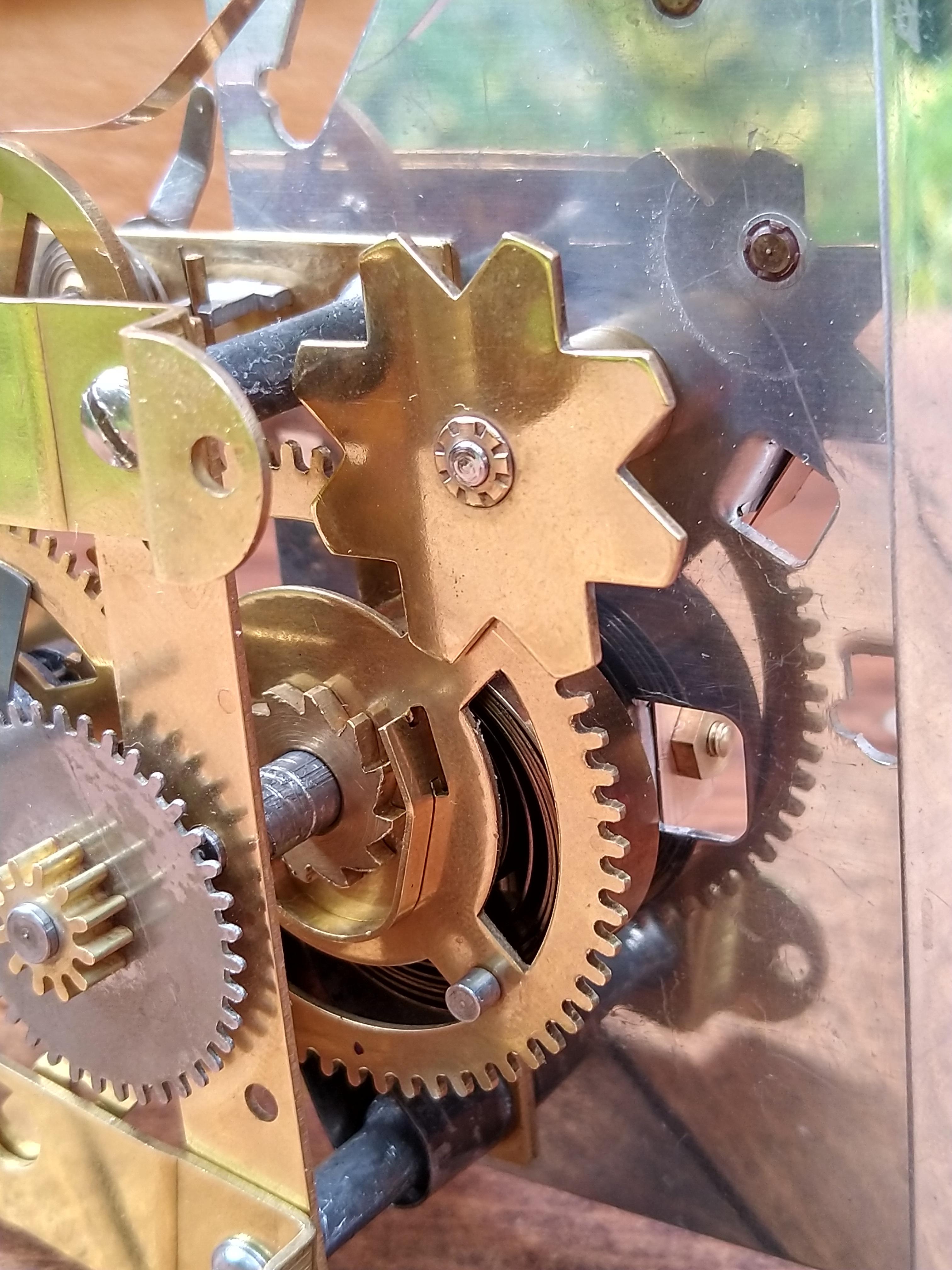

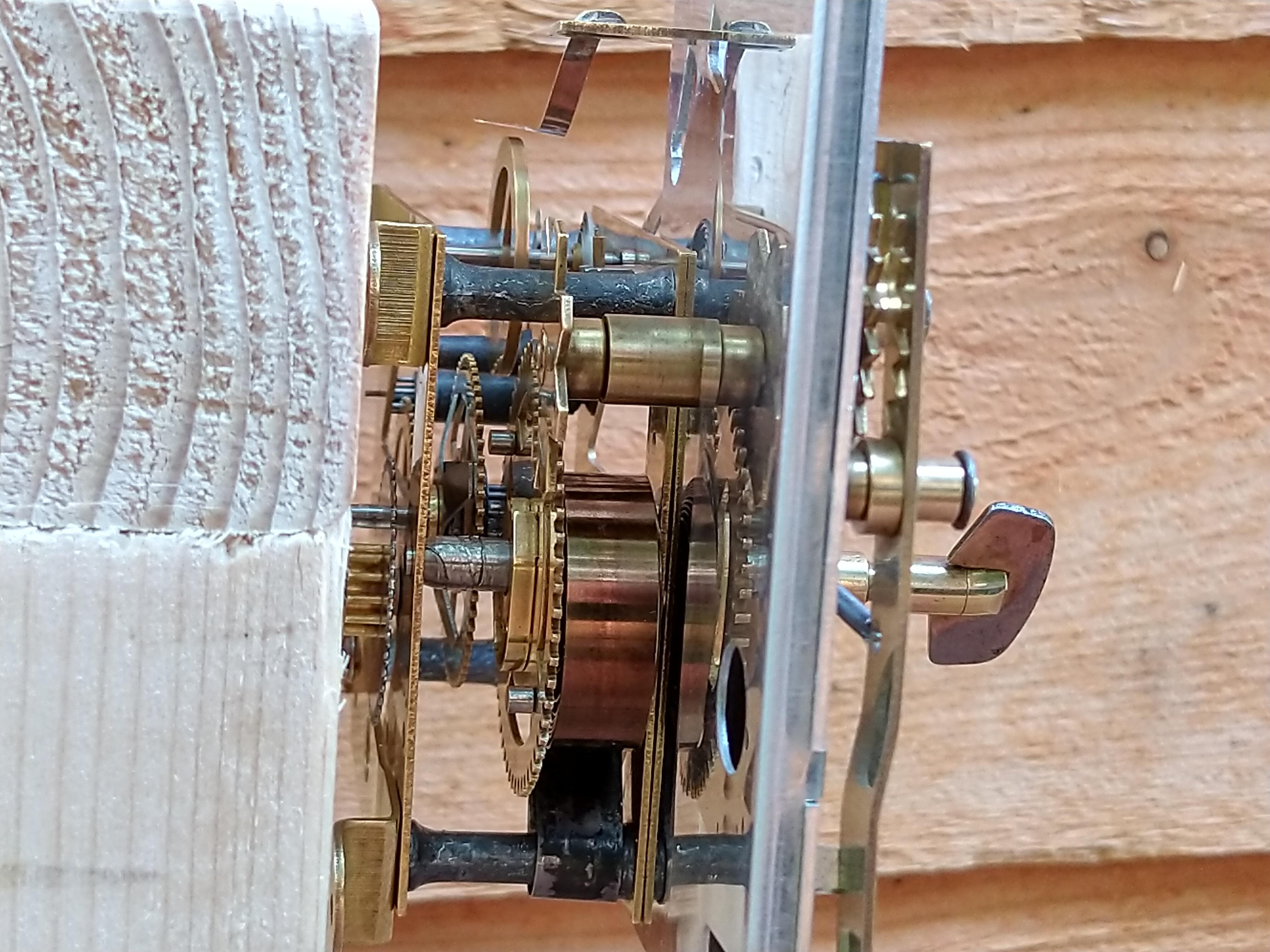

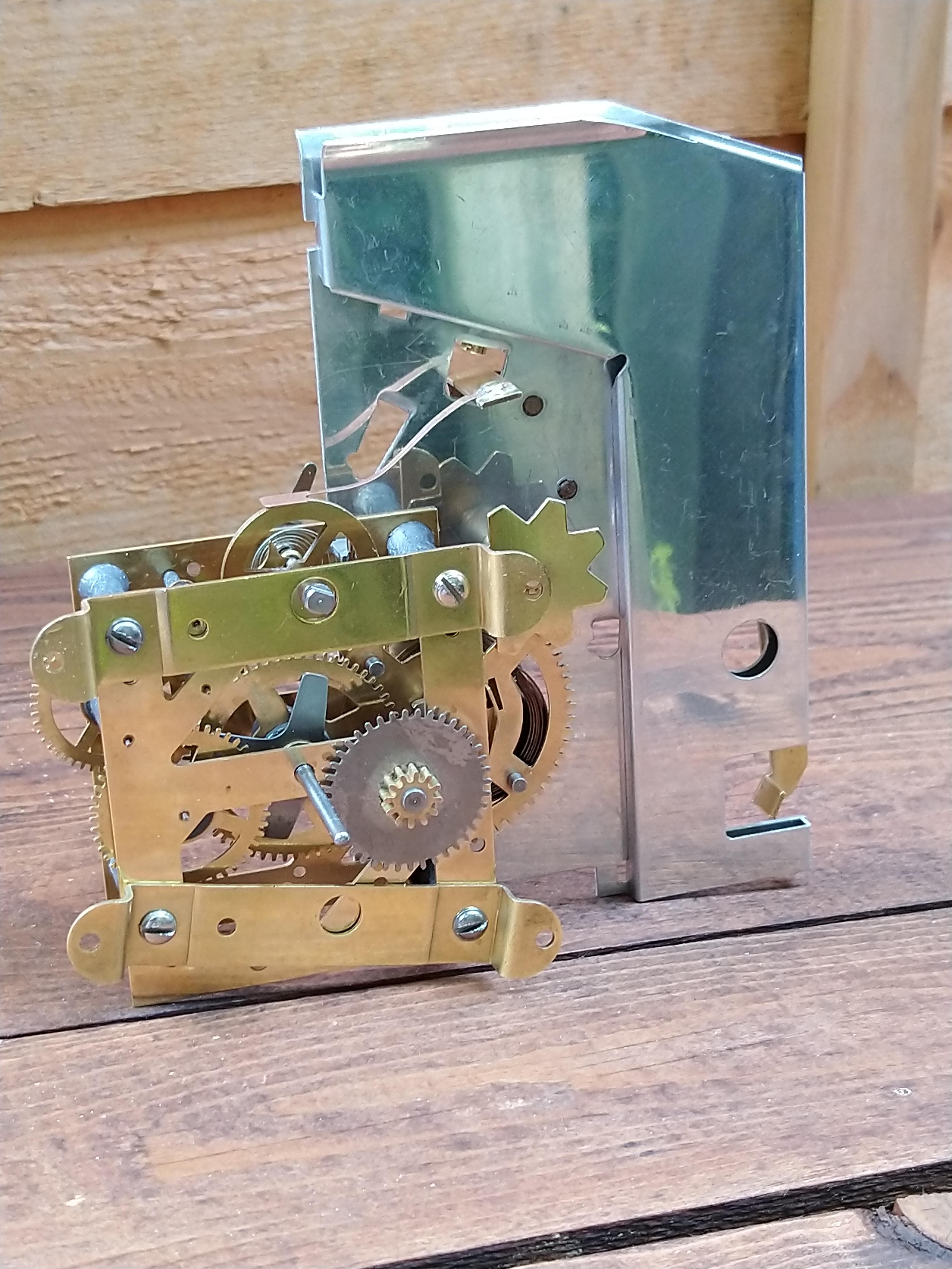

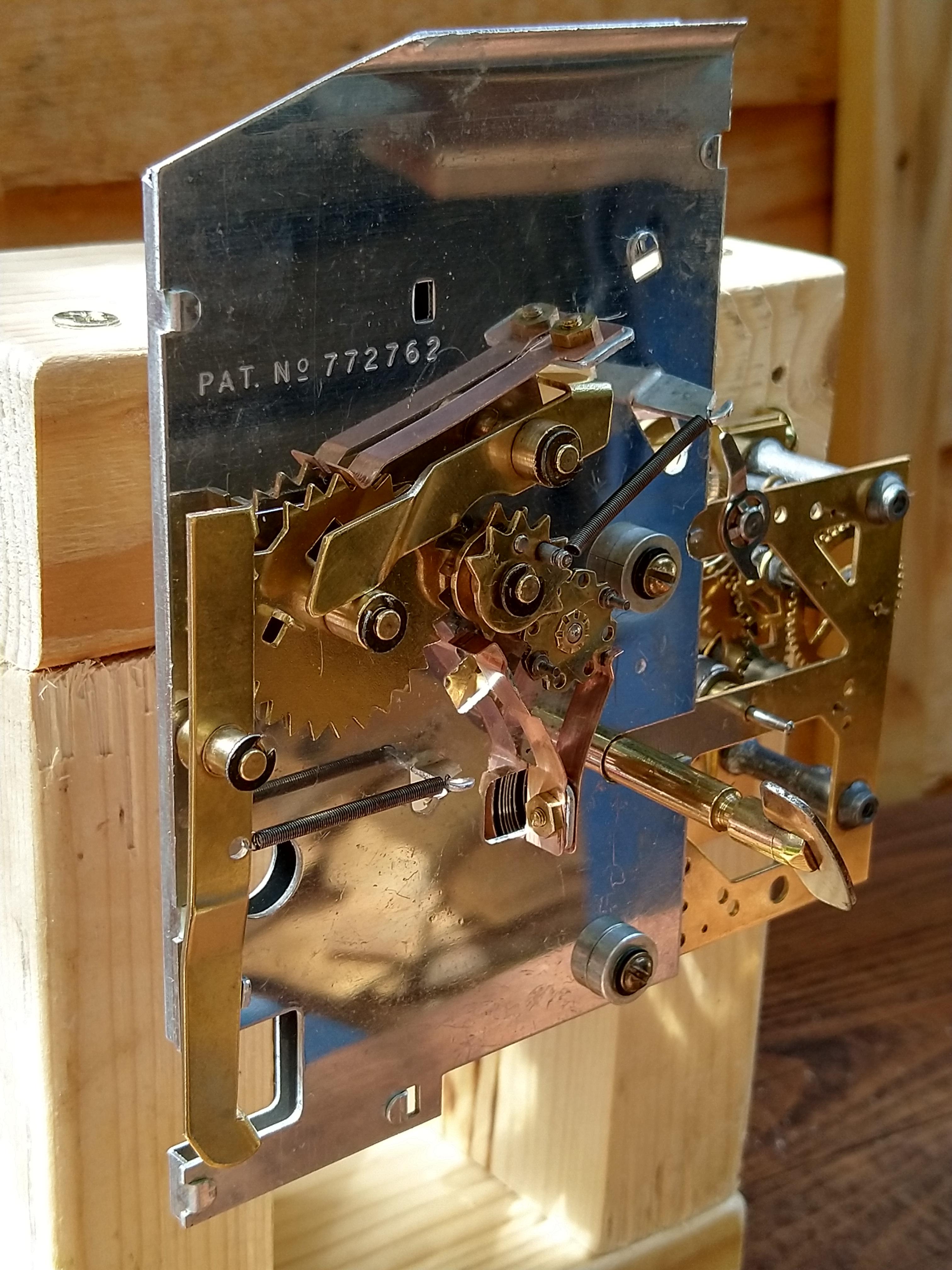

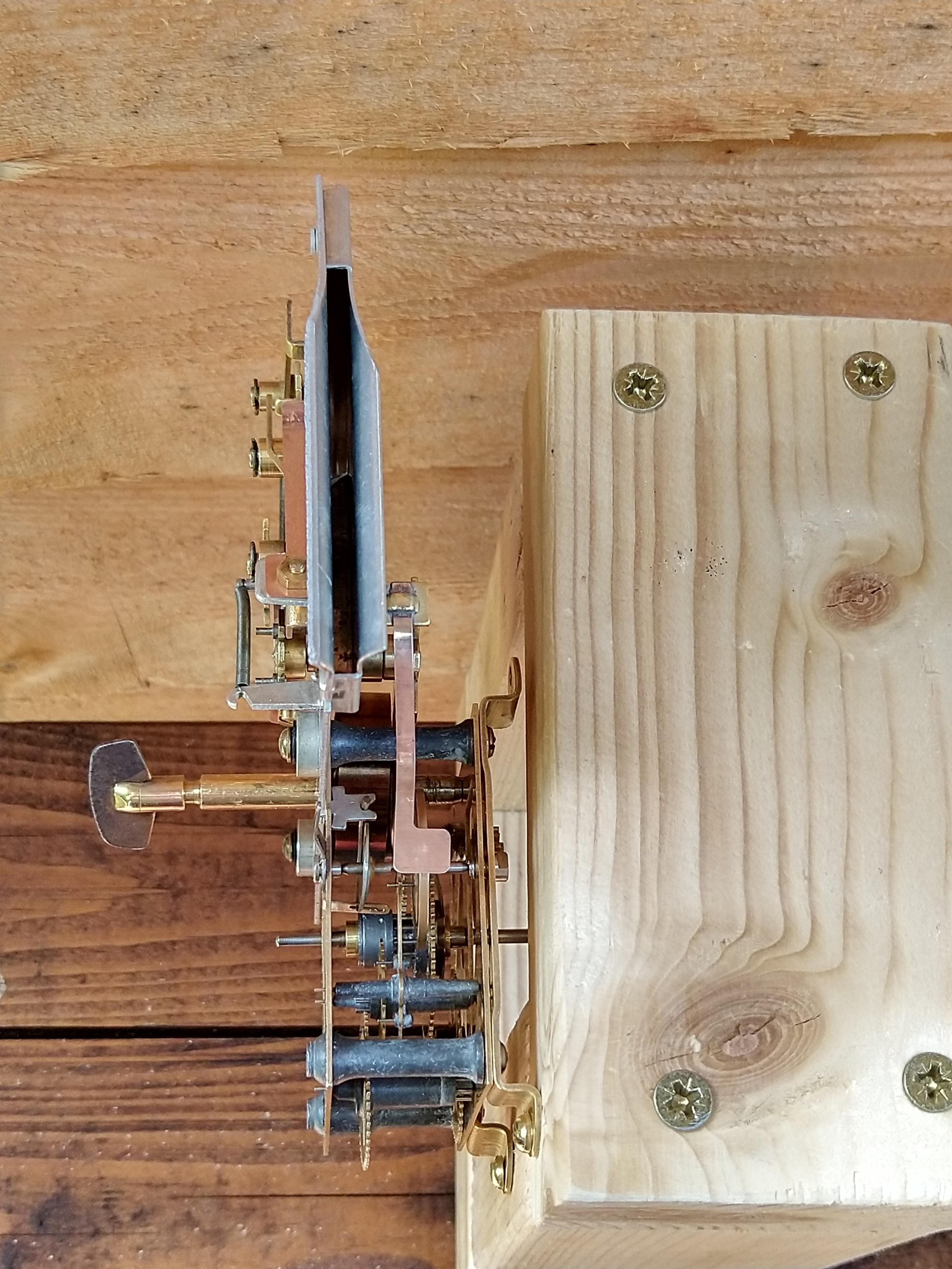

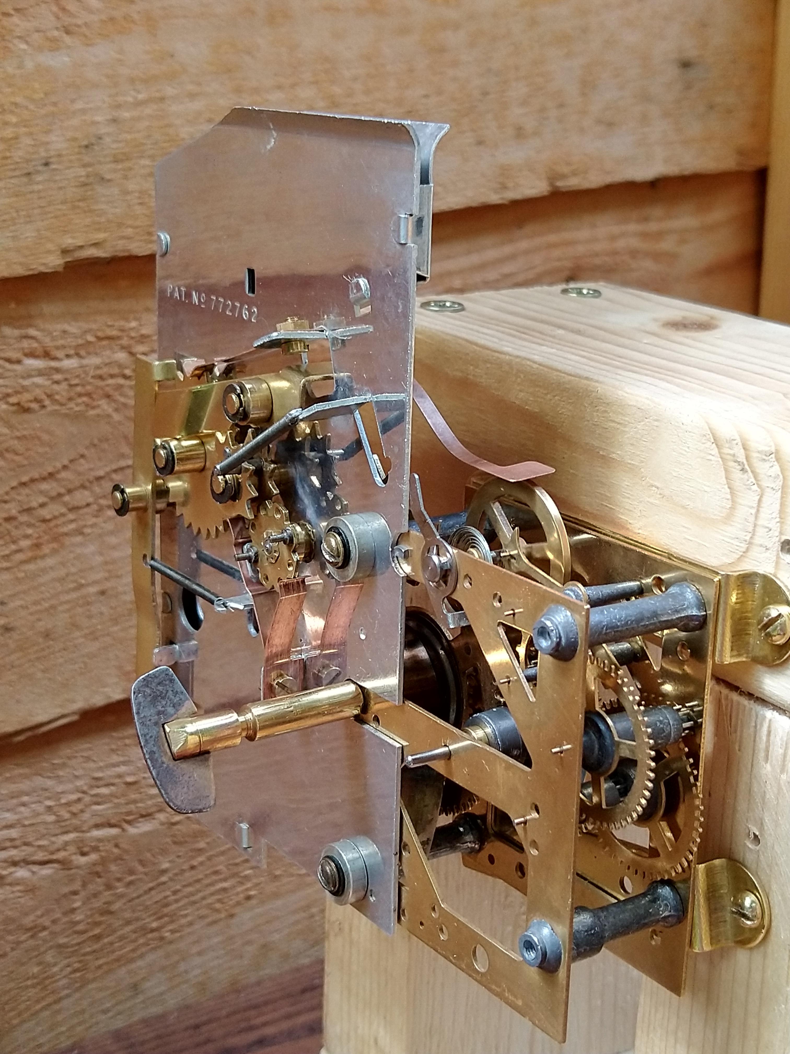

I made further progress with the Time Savings Clock - i will have no problems with finding time anymore!! :woohoo-jumping-smiley-emoticon:
How the coin mechanism works is described above, not like I had a clue when I read it. Basically the clock mainspring barrel operates/drives the coin mechanism. Or with other words the mainspring barrel manipulates the coin mechanism to stop the clock running by tapping/locking the balance wheel in a timely manner. When you drop a coin into the coin mechanism you unlock the balance wheel. You can use maximum 17 coins to allow the clock run, the 18th would go to the piggy bank, but it would not give you extra time with the clock. Now I have to put it back into the case, the task I don't like at all because that is just work and cleaning, no fun at all.

Hi  Nice one Luiz    a worker, Check the beat it looks a little out watching the escapewheel.  Will last another 50 years .:thumbsu:
Thank you. How do I do that? How to check and how to correct? Setting is same as watches? Turning the hairspring on the balance arbor? And how do I check? I have that Chinese No 1000 timegrapher, but it is for watches.

I was thinking while i had some relaxing moments in the garden and i just realized that I still cant set the beat. So you amplify the sound of the tick tock and then you just listening to it and set the beat like that? I don't think I could do that, not with my experience, I am good in airguitar playing and in air drumming, but not with the tick tock. Or do you use SW aid to set it?
I've been following this thread and watching its progression. That hairspring needs slight adjusting, you have to much touching it needs to be even and keep its shape no matter where the regulator is. Poor action on the balance, which suggest the pivots are slightly blunt or the cups are not smooth or both. The movement is in beat as it starts off well. Have you oiled the cups and the escape wheel? if so what oil did you use. Congratulations on your achievement.
Hairsprings are killing me and I have difficult times with them. I seem to hear some extra little noise when it operates so yes too much touching i think. Pivots seemed to be pointy/ok when I checked them, but again I have no experience as what is ok and what is not. I have not checked the cups, i did not even know that I have to check them. Is it possible to smooth them out? How? End shake seemed to be ok too. I used J.D Windle's clock oil for the clock movement and some J.D Windle's Turret clock oil here and there and molykote dx for the coin mechanism. I hope I don't have to take it apart once again, but will do if needed, this is all fun. :)

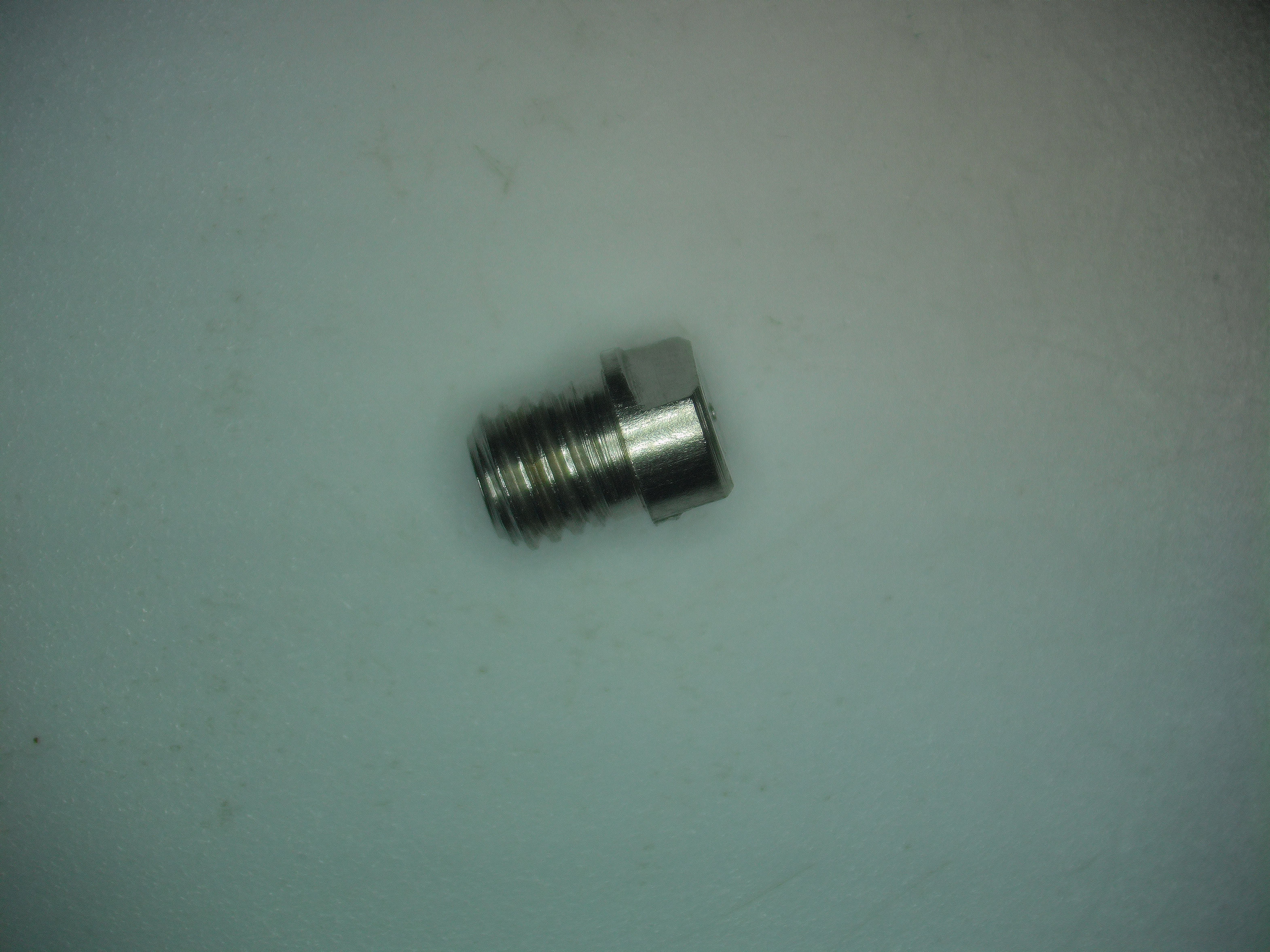

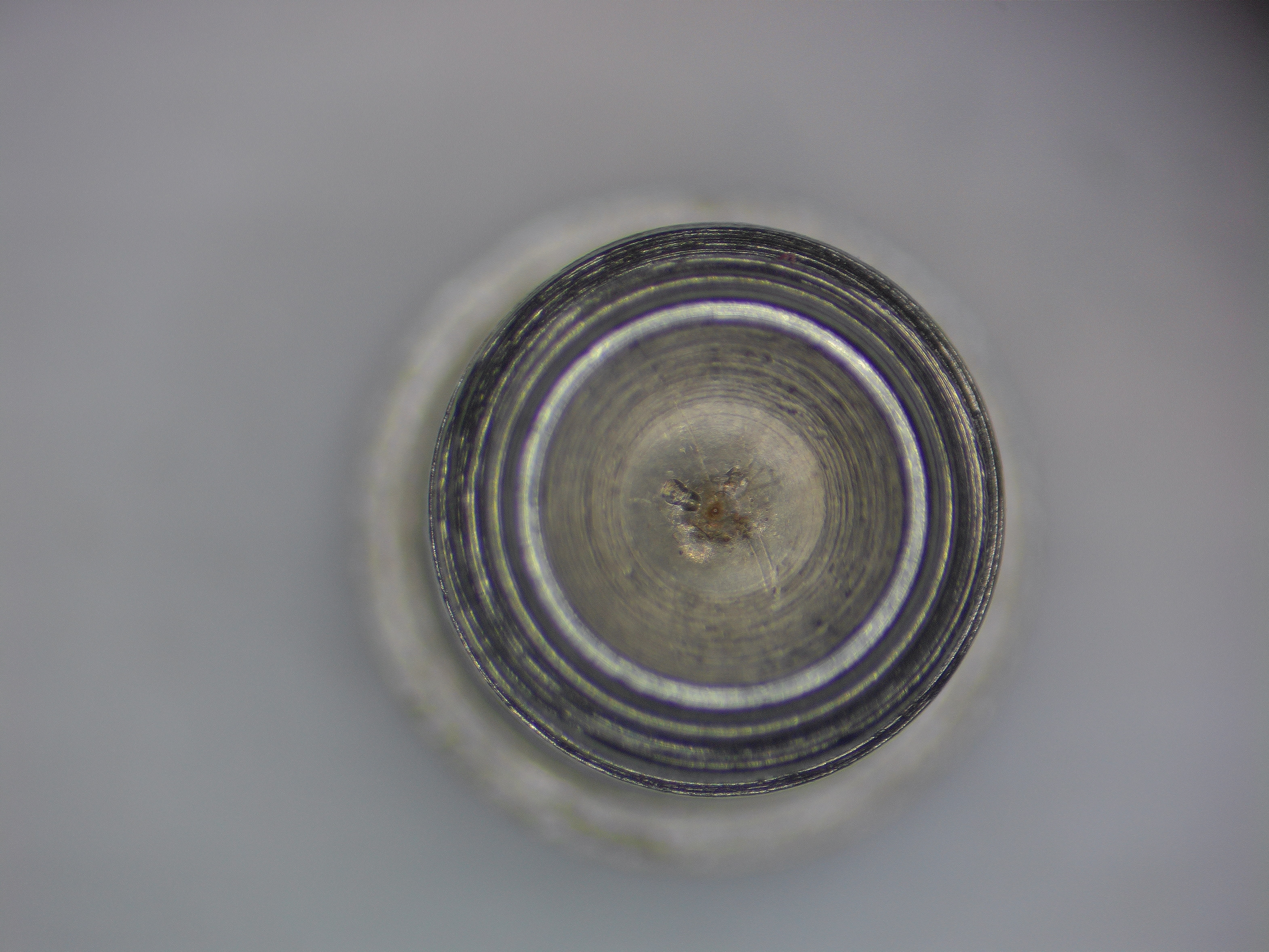

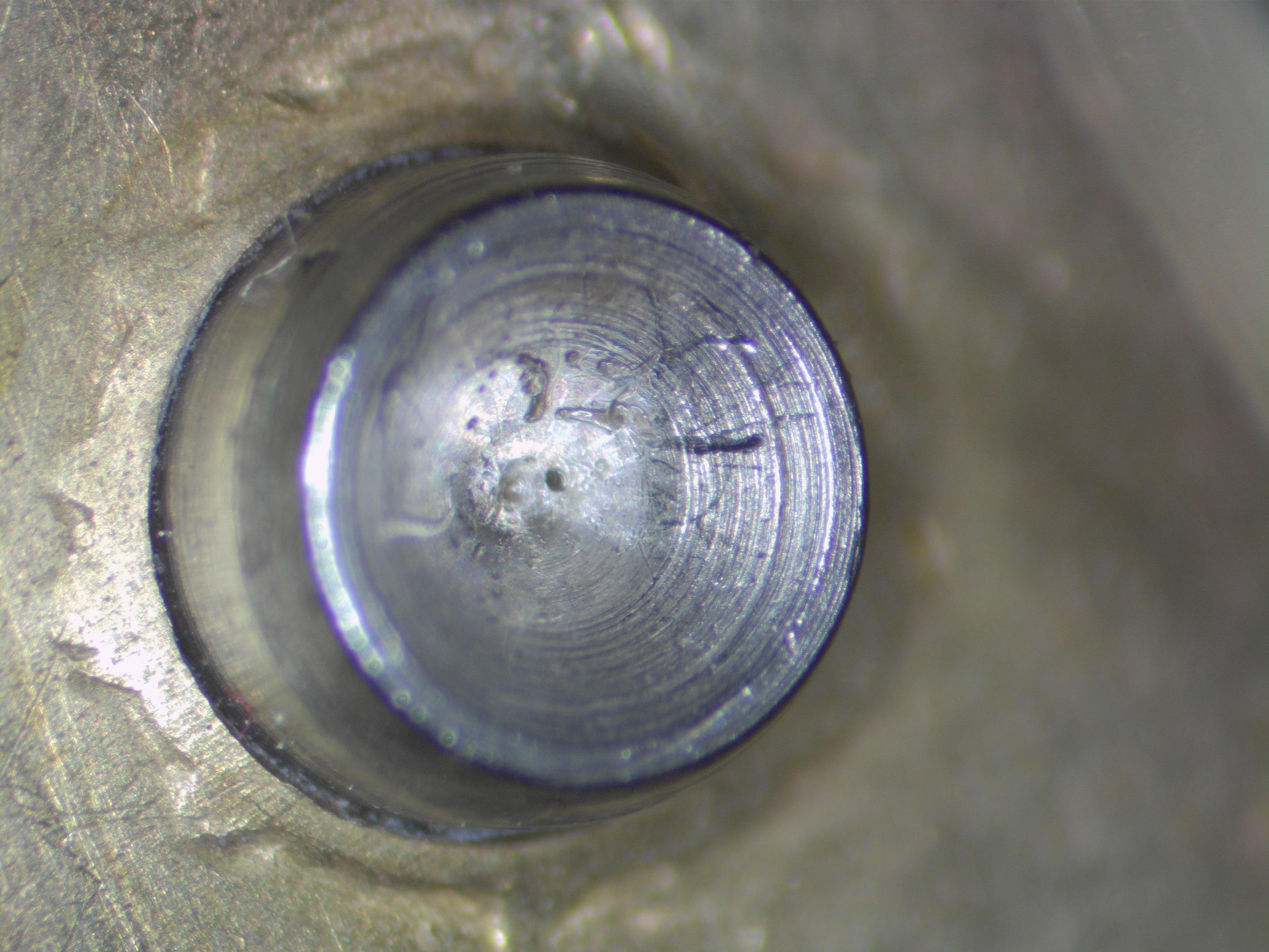

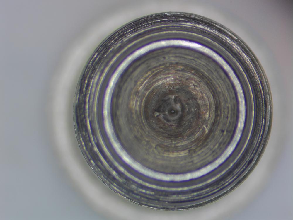

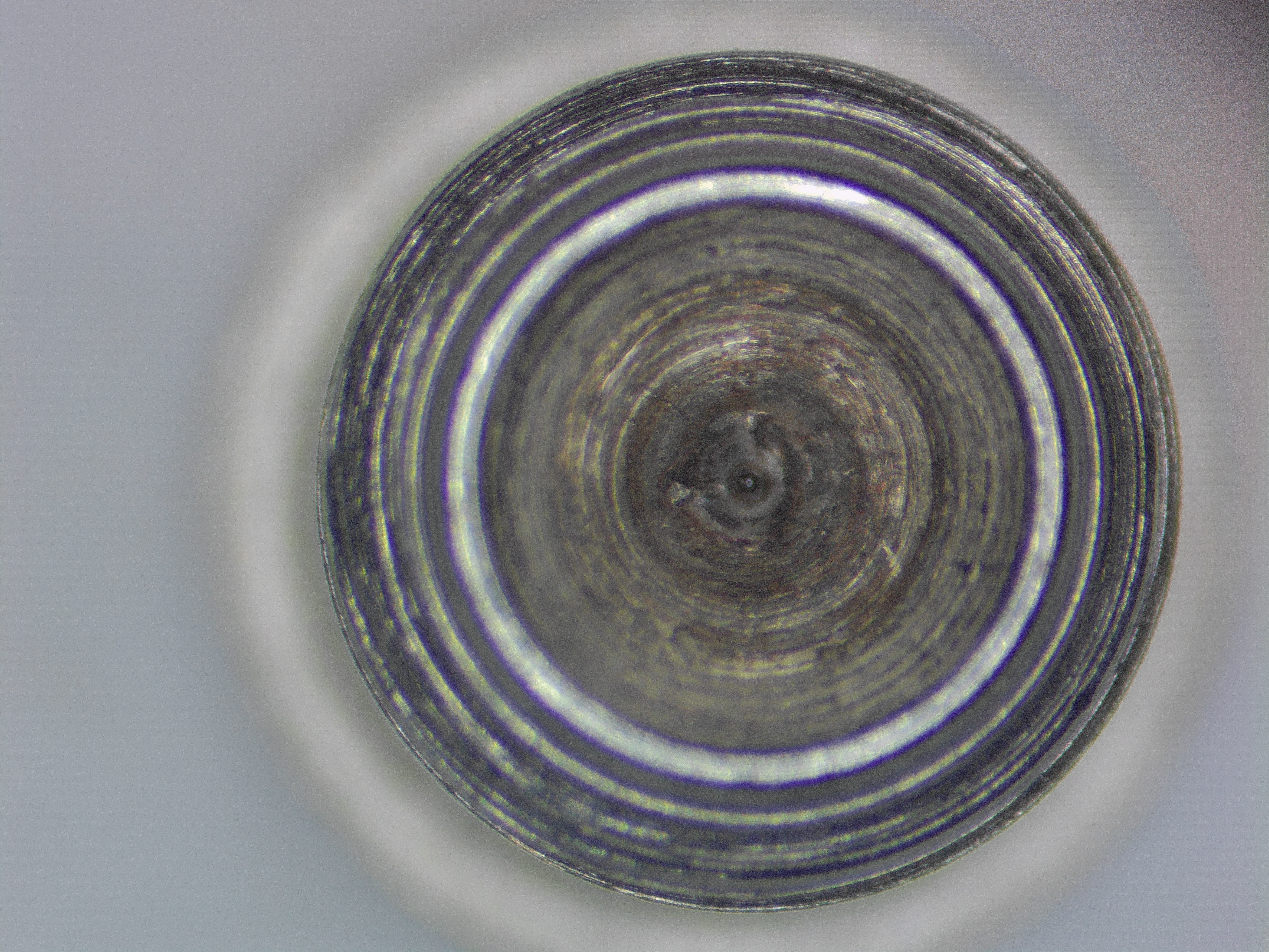

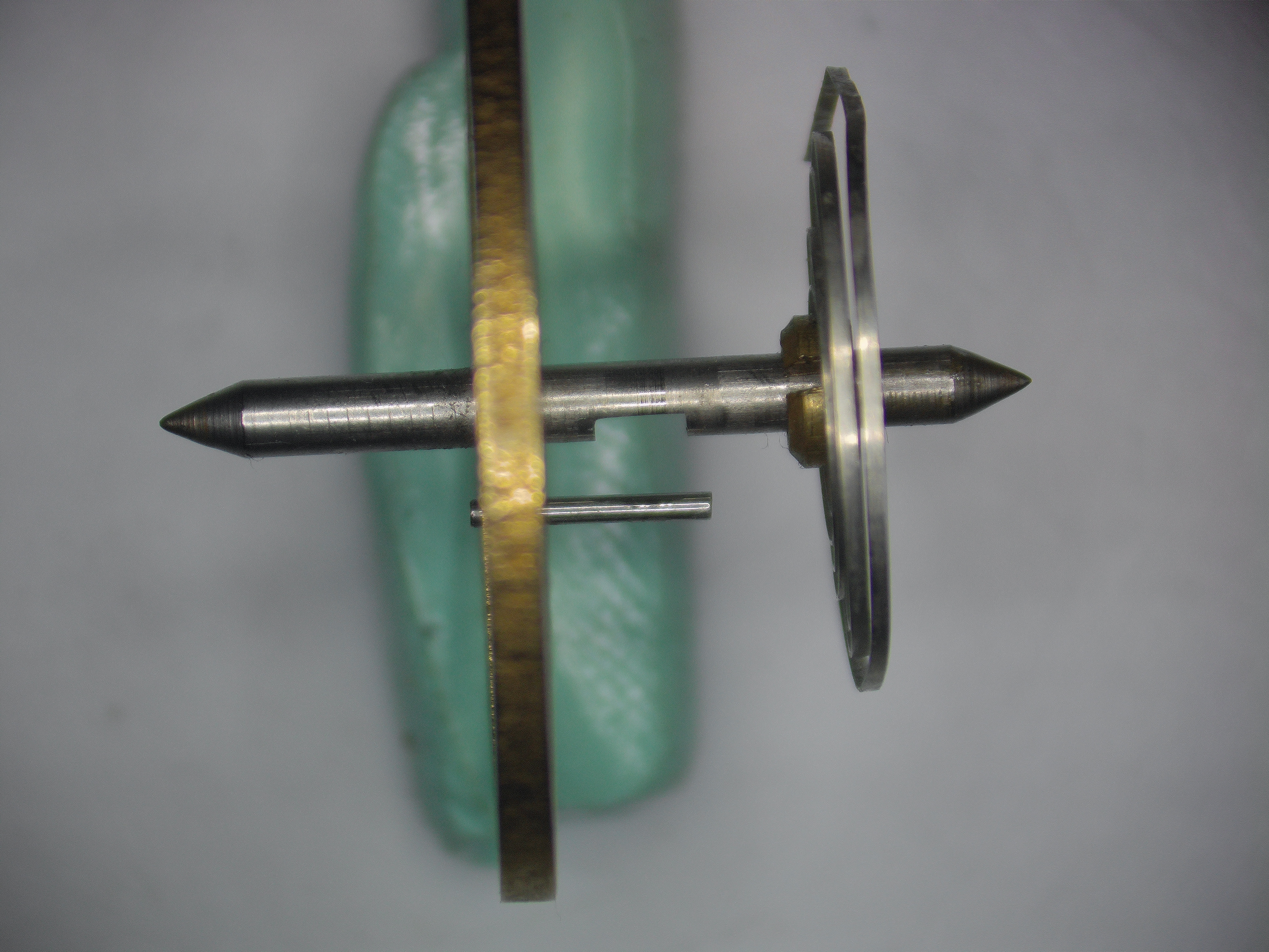

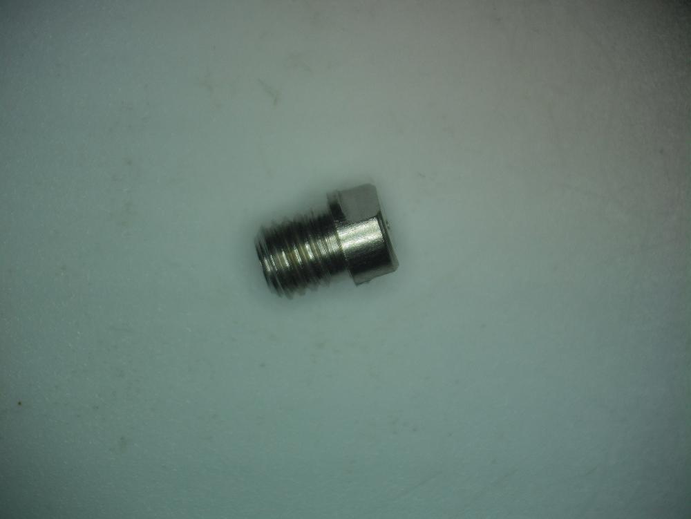

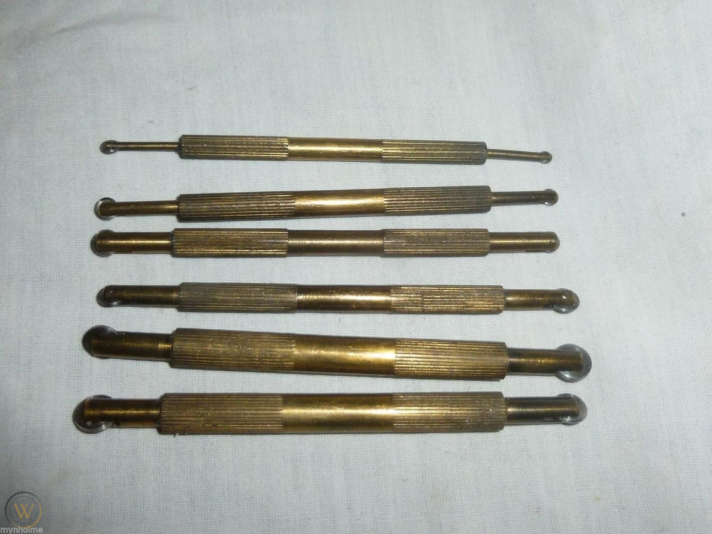

I had a few minutes to take out the balance wheel to take a picture of it. What do you think? Not too bad not too good? Shall I use my unimat as a pencil sharpener? I wanted to use my incomplete screwhead polisher ( screwhead polisher ) as suggested by @Tmuir , but I dont have the right sized collet.
31 minutes ago, oldhippy said:

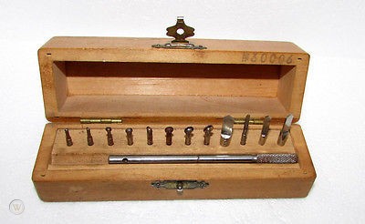

You can buy them at most clock suppliers they come in various sizes, you just pick the one that best fits the cups you have, you should be able to hold the drill in a pin vice, those cups are not made of hard metal.
Could you please give me an example, picture or link? I have already tried to check out websites for countersink drill bits but only found some very expensive sets and I am not even sure if they are for the task I have at hand.
This is the sort of type I had and yes they are expensive.  Bergeon tools are very pricey. I have seen them on ebay, look for watch/clock tools vintage. You can buy new from https://www.hswalsh.com/categories/roller-sinkers-and-countersinks or https://www.cousinsuk.com/product/countersinks-bergeon
A suggestion from me would be re point the balance pivots and try the balance and see what type of action you get, if its good then leave well alone, if it is still bad then you know what you will need to do. Those tools not only are for that sort of work but they come in handy for making oil sinks when it comes to re-bush and removing burr.
Too late, patience is not my virtue, I may have made a mistake here. Found a bit what seemed to be suitable for the job in the box of my cordless rotary tool. So started rotating it, it was very difficult to see any result by rotating it by hand, almost nothing was visible so started to use the rotary tool itself. And now the silvery surface started to become yellowish. Is this thing brass with a hard surface coating? I guess I ruined it now. How is this thing called, and can it be bought as new?
