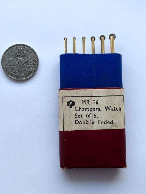

I was thinking about those roller sinkers, they would do a semi circular shaped hole in the material while this pivot hole i have is cone shaped, would that not be an issue to have a semi circular shaped hole instead of a cone?
By the way I found this video:
https://www.youtube.com/watch?v=riXlvBfYN8Q
this way you could create a cone with any angle I think.
No you just rotate it 360 degrees until the cup is clean. They are called balance sink cups for 30 hour windup movements. That video is good that tool is OK providing the hole you are going to countersink has a hole. In you case it won't work. Looks like Marc can help you out. Well done Marc.:Bravo:
