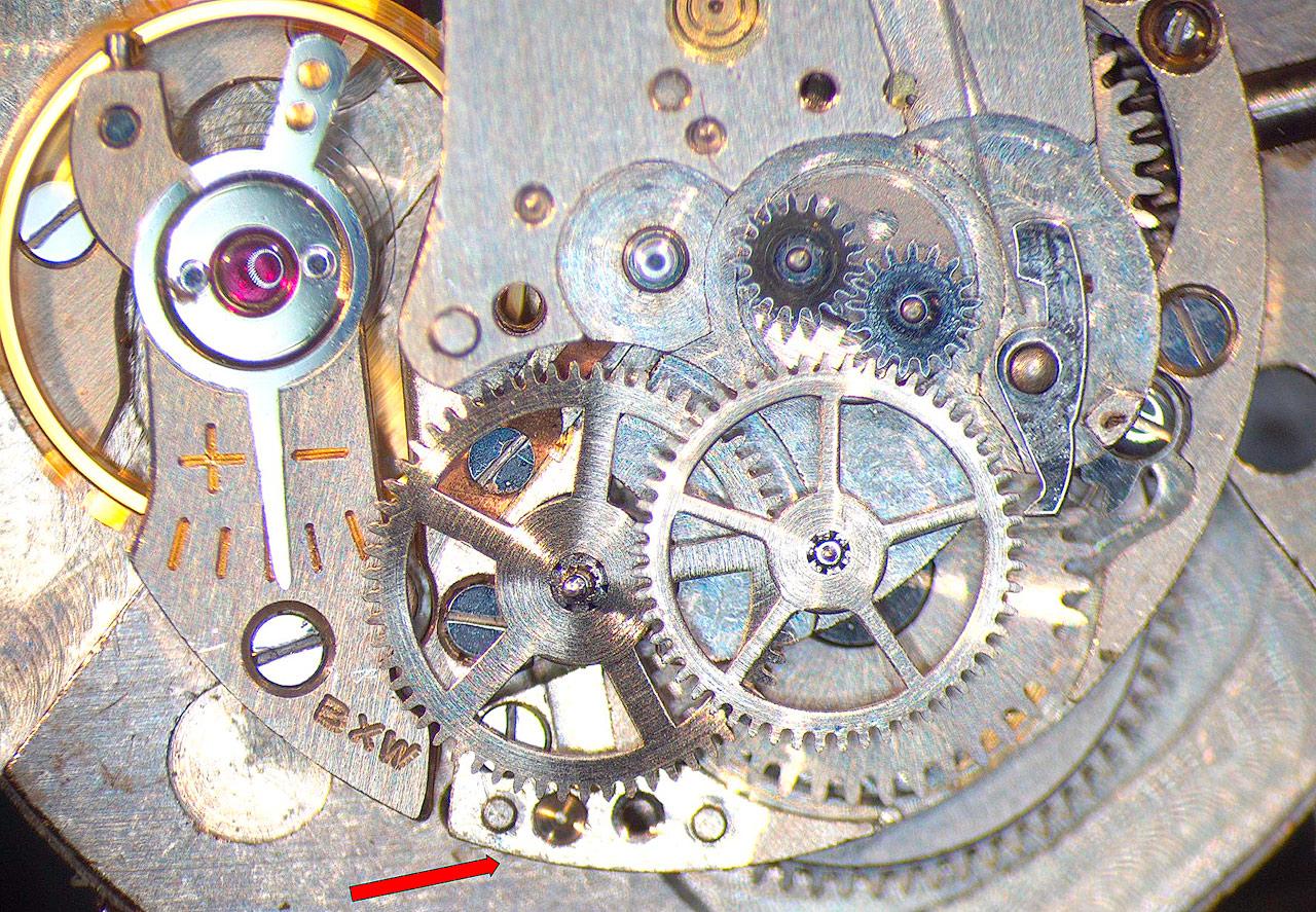

Help determining part name?
Hello, I am working on an AS 1320 (Bulova 10BRC, 9AS) automatic movement and have found it to be missing a part for which I cannot find a name. I have looked at the 10 BRC automatic assembly parts list and the parts list for the movement itself and still cannot locate it. Here is a photo with the missing part outlined in red.
It is a spring-like device that prevents the automatic assembly's third winding wheel from engaging the ratchet wheel when the mainspring is fully wound. If anyone could tell me the name of this part so I could order a few replacement parts, I'd really appreciate it!

Plot twist, the Bulova 10BRC doesn't use the Breguet spring! Although it's based on the AS 1320 the Third Winding Wheel is constructed differently and the spring isn't used. The 1950 'Bulova Self-Winding Watches' manual shows how the automatic works functions and lists all of the parts. They also latter released an addendum to clarify the recommended oiling in the 1952 Technical Bulletin No. 2 (attached).

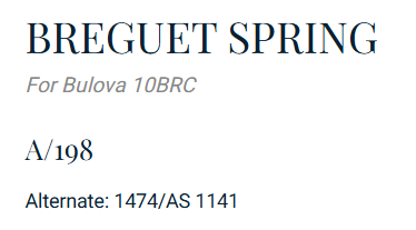

Strange how it's on the parts list then?
I saw that and thought the same. I believe it's an error. I have two of the 10BRC and neither have that spring. I've looked at a number of the 10BRC movements on the web and can't see the spring. The Bulova parts list and description of how the automatic works functions does not mention the spring either in the parts list or when describing how the automatic works functions. The lubrication recommendation does not mention lubricating that spring, while the AS 1320 technical documentation does.  I believe that the different construction of the Third Winding Wheel in the 10BRC compared to the AS 1320 is why Bulova did not include the spring.
So is that just an empty space on the 10BRC?
Yes, it has a cutout for the Breguet spring (photo), the screw hole and the steady pins but no spring. The pinion on the bottom of the Third Winding Wheel on the Bulova is solid with the wheel and engages with the Ratchet Wheel. On the AS1320 it has a clutch wheel that can slip and disengage from turning the wheel when the watch is manually wound and it needs the spring to keep it engaged with the wheel. I'm not sure why this is necessary as the the auto works will also disengage from winding the rotor when the movement is wound because when it is wound the alternating disc rotates away from the rotor.
