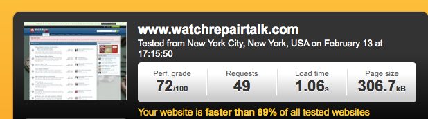

Another problem with Cloudflare today. Things are a bit slow. It's a bugger to be honest.
Update - Removing congestion from IAD.
Feb 12, 20:32 UTC
Update - We are actively working on alleviating network congestion in some of our European datacentres.
Feb 12, 19:59 UTC
Identified - The issue has been identified and a fix is being implemented.
Feb 12, 08:50 UTC
Investigating - We are investigating network issues in Frankfurt, the colo has been rerouted.
Feb 12, 06:29 UTC
Cloudflare has had a lot of problems recently - I wonder if it has anything to do with them providing CDN for the pirateBay. If it carries on then I will stop using the CDN.
Don't think so - mainly referring to the general slowness of the site a few days ago. It should all be resolved now.
I have taken my other site off cloudflare to see what difference it will make before I make a decision about WRT. hopefully it will be better from now on.
