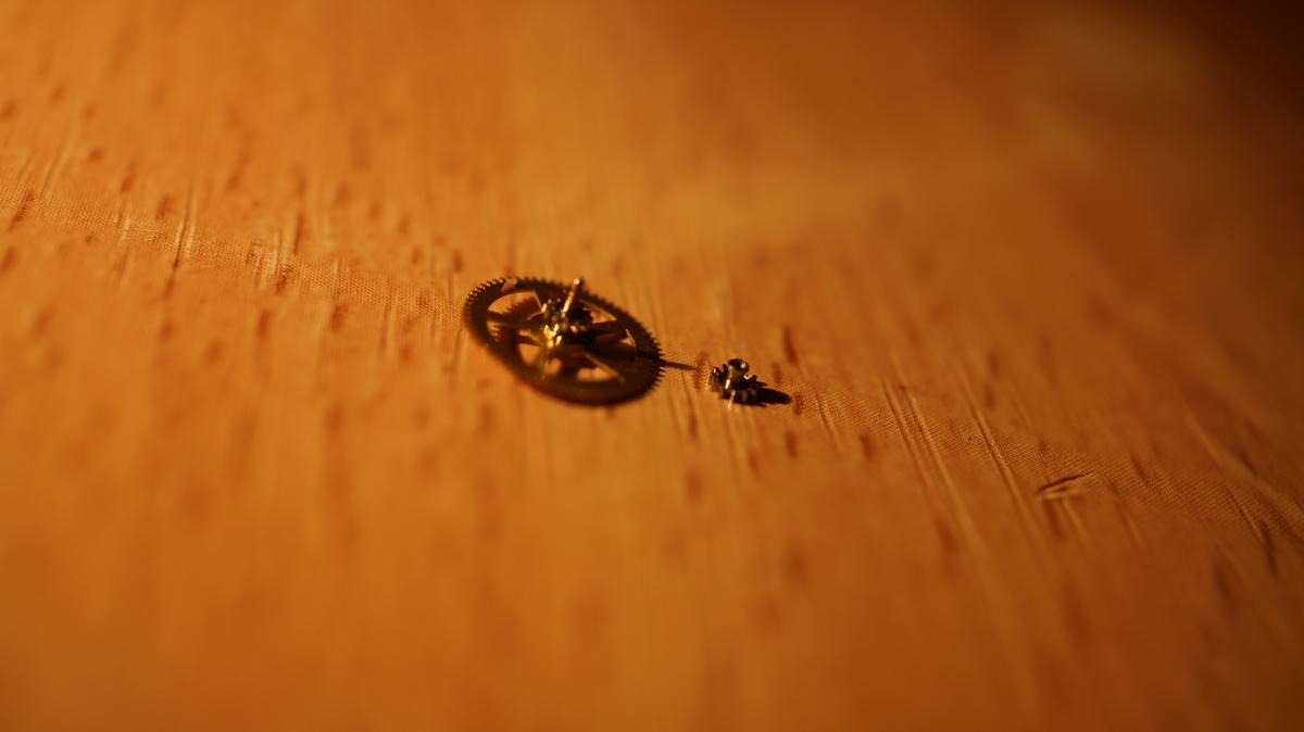

Having trouble with a serviced AS 1882 . This watch is only making a lot of trouble . At first i bought it and it didn't work so very well . Tried to service it but it didn't go so well . Something wasn't right  . Could get the part together . So i bought a nice looking watch with the same movement cheap . That movement is now serviced and running strong . It works ok in the timegrapher . But the hands won't follow the movement . The hour and minute hands stops or is slow . But the second hand works and keeps ticking .  I will soon get an old movement that missing some parts .Which i have from the first movement . Going to get that movement serviced and see if i can get it to work in the other nice looking watch . What is the trouble with hands ?

The cannon pinion is needing tightened. There are various tools available for doing this, have a look on EBay you should be able to pick one up cheap.
+1 for Geo's reply - I've had this problem with a number of movements over the years. Slow or wobbly and unpredictable movement in the minute hand - corrected by either tightening or replacing the cannon pinion.
Hi Rogart, I have become abit of an expert on the AS movements after purchasing a Mido with a similar problem, 3 movements later I got it working!. It is the small gear on the end of the Large driving gear that needs to be tightened. Its part number 201/1. The Canon pinion is driven from that along with the date change mechanism. Cousins have the parts list if you search for AS1882.

Just to make sure i do the right pinion i took a picture of it on non working spare part movement i had  . Could take that pinion if it's nice and tight too . The one to the right is the cannon pinion ?
I prefer using the cutter style tightener, same as geo's. I find you get the most control and it is nearly impossible to fudge it. I still slide the CP down an old oiler first, but the screw on the cutters make it impossible to crush the CP in any case.

Have fix the cannon pinion and it has been ticking with some odd hands i had in a box . Just to see if it works ok . Now i can put the datewheel and date mechanism back again . Had to do it a few times and had to support  the wheel from the other side when i pushed it on . Looks a little strange with hands .It's 8 a´ clock
