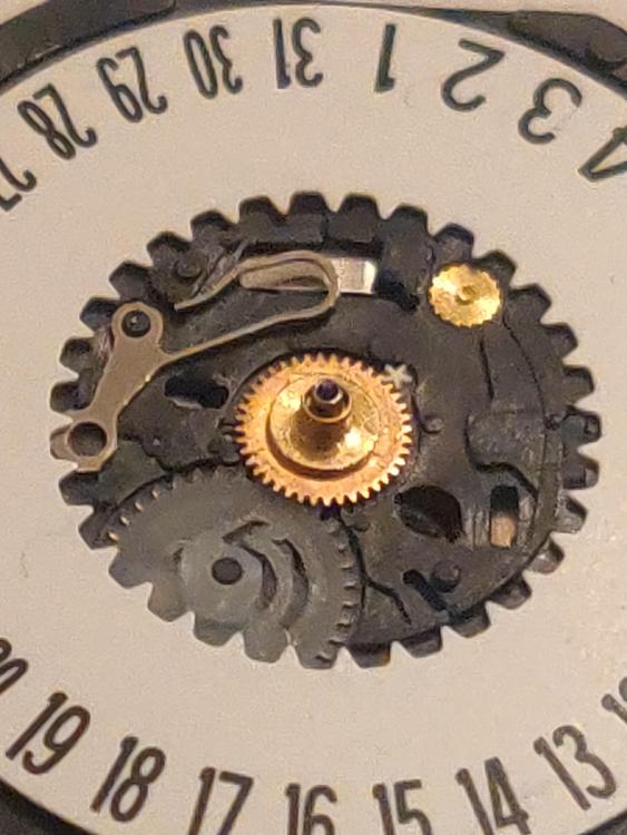

I have a VX32E watch whose date is stuck, it doesn't change either by stem or even when the 24 hour cycle completes, any suggestions how to rectify this
Edited by Rishah
Could be a number of things. How about removing the hands and dial, that's if you are comfortable with that. Post a few photos, so we can have a look for you.

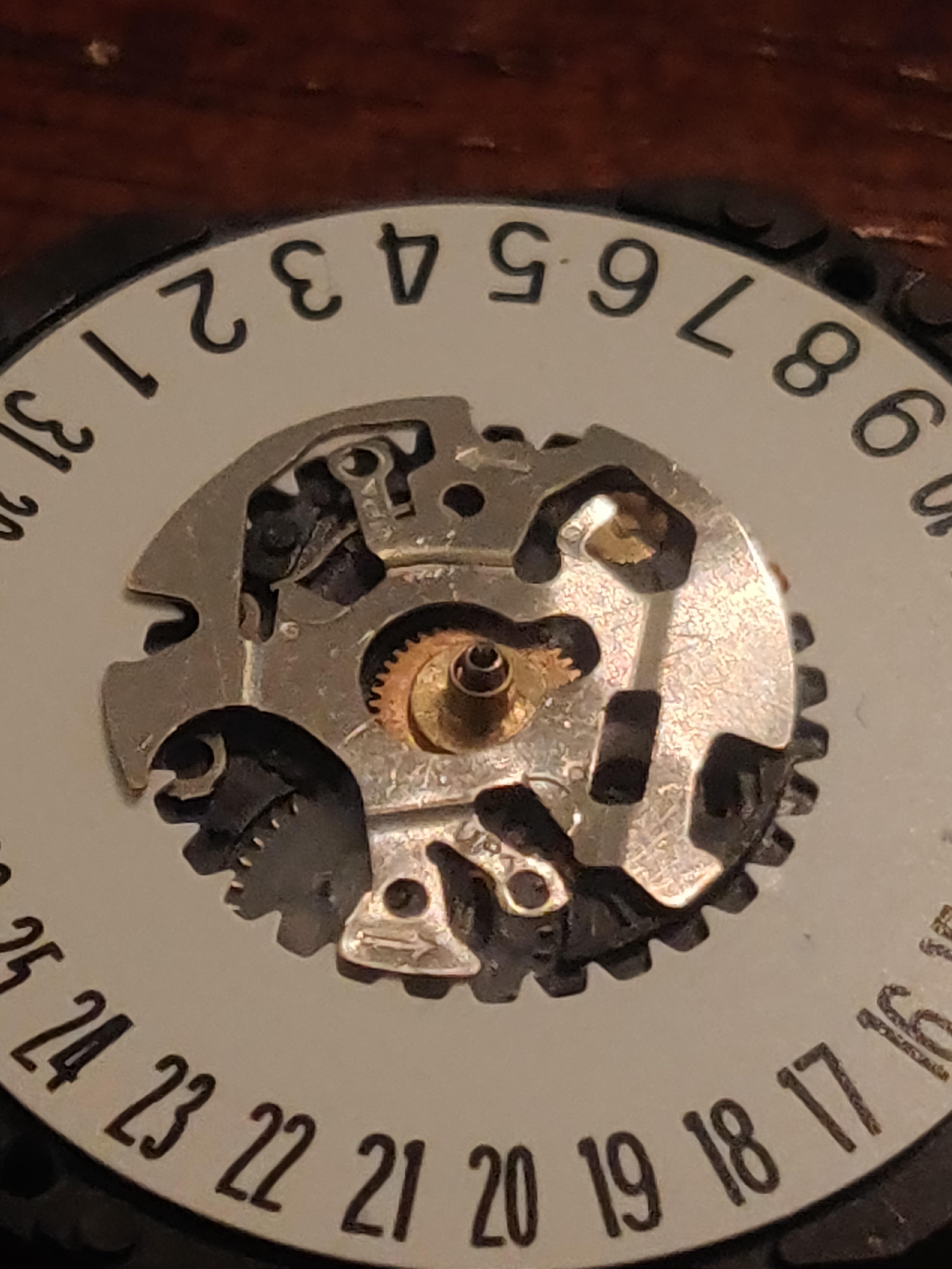

25 minutes ago, Rishah said:
Placed everything like this but the top part keeps popping out , any suggestions
Looks like some part is broken or reassembled incorrectly, being the cost of a new module less than 10 Euro it might be an option to replace it completely.
Edited by jdm
That's what I was thinking as well , just quick question the watch I am working on has date at 5 PM mark while the available movements have either 3 or 6 option, which one to buy
It depends on the shape of the date window, the one is your picture is actually date at 6.
