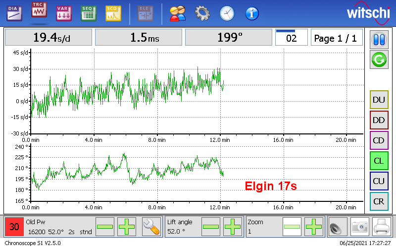

4 hours ago, VWatchie said:
As I believe John mentioned, when agitated, the deviations even out and that's why even my Vostok watches (being somewhat erratic in amplitude and rate, and being badly poised, as most Russian watches are) are surprisingly accurate (approx. +2 to +3 s/d)
watches are interesting in that they will average out their imperfections over time. then things like poising errors they get averaged out on wristwatches because you're moving your arm around if you stayed in one position then poising errors be more of an issue.
one of the biggest influences of amplitude versus timekeeping is the regulator pins. The example picture I have shows what happens if they hairspring isn't centered versus amplitude. then I don't have an example of it but the farther the regulator pins are apart the worst timekeeping will be with amplitude. Which is why the regulator pin spacing is critical if you want to have proper timekeeping.
timing machines are also interesting in that they tend to average out instantaneous things. If you're watching the graphical display in pay attention to the amplitude oftentimes you'll see it fluctuate up and down but you may or may not see that effect on the timekeeping.
But what about if you have access to a different kind of a timing machine like it work something dreadfully expensive?
these examples were just convenient the fine I think somewhere I may have a much worse case example where things were much more dramatic but still this will make a point.
Vintage Elgin 17 size who knows when it was last serviced. Timed and six positions overall I think it looks quite good considering the age of the quality this watch. But notice as the amplitude drops even dial up and down there is a pivot issue and you can see the amplitude drops the watch slows down a little. Going into the crown positions with amplitude crashes we can very clearly see timekeeping is not happy. I suspect if I close the regulator pins a lot of this would go away.
Then on the time plot feature we can see two separate wheel issues and its effect on timekeeping.ย  the longer time interval is typically the center wheel pinion meshing with the mainspring barrel and the other is a faster movingย  wheel pinion combination. It's a very clearly you can see power fluctuations in amplitude. You can also see timekeeping issues but realistically still really good with considering these are only looking at a plus and -15/2 for that amount of amplitude fluctuation.
What if we don't have regulator pins? Like a Rolex watch it too has a wheel issue or several issues perhaps. But notice the overall timekeeping even the effect of amplitude on timekeeping because it's scaled differently of the Elgin it is really really tight but still you see there is an effect of amplitude timekeeping issues.
Somewhere around here I know I have more files I do know I have at least one watch as much much more dramatic. But still you can see the effect of amplitude versus timekeeping with and without regulator pins.
