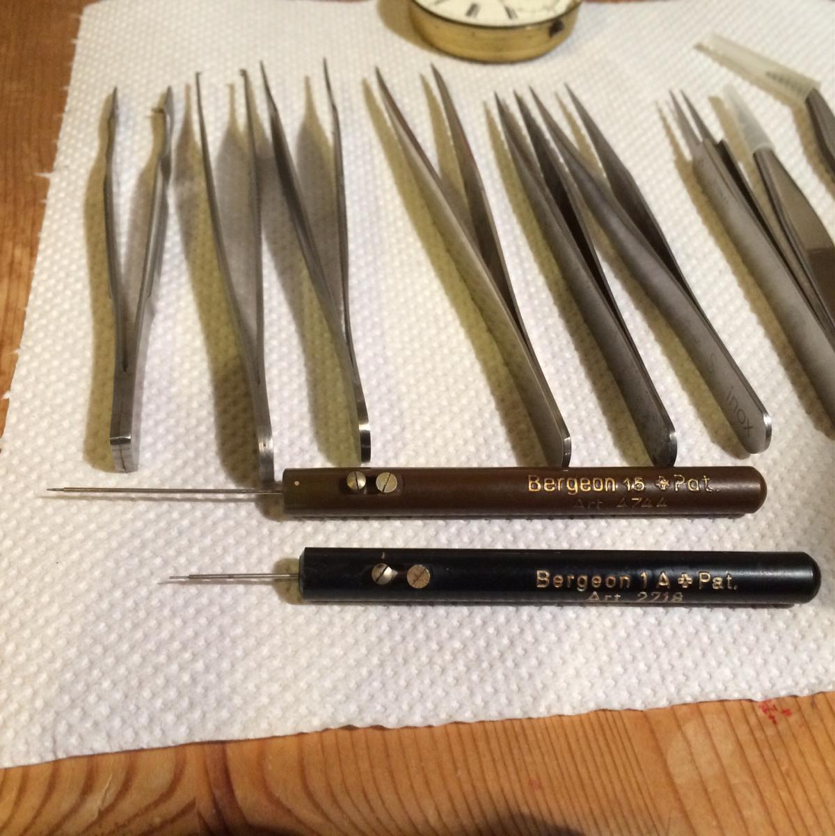

Here's the instructions, and you should be able to purchase spares for them.
Sorry about the quality.
Edited by Geo
You will need the reservoirs and the needles. If I was you, I would only worry about the black one - it's the only one I personally find useful. Never got the hang of the green or red ones so I ended up loading them on eBay. But the black one I find very useful for end-stones.
