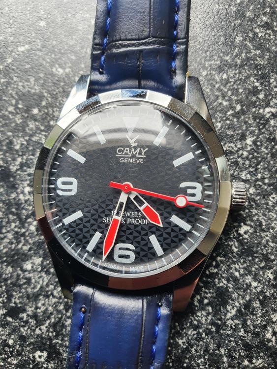

Bought this £4.00. I bought it because I read that Camy Geneve have good movements. This one doesn't reek quality to me, am I wrong? 20220523_163332.thumb.jpg.7564162e00338987c06a56a8761bd224.jpg

No Richard, you are quite correct Camy have always been a good quality brand. You do know what you have here though dont know šŸ¤¦ā€ā™‚ļø. I'm ever so pleased you only paid 4 quid for it though.

As for the Camy, yes I know what I have.  I bought it without seeing the movement because it was £4. I wouldn't spend good money without seeing inside.

I don't know whether to service it for the practice or hit it with a hammer.Ā  The case is decent though.
Well it depends. The basic movement is fine, but this looks like the last gasp of the FHF 9X series ( I think it is probably an FHF 97)
Earlier versions were much better engineered, but by the time this variant came out, probably around 1980 the quartz crisis had taken hold, and the engineering was being "en-cheapened" as much as possible.
http://www.ranfft.de/cgi-bin/bidfun-db.cgi?13&ranfft&2&2uswk&FHF_97
If you clean and service it, it will probably run reasonably well (assuming it hasn't been previously butchered in the back streets of Mumbai of course).
Is it, or was it ever associated in any way with "Camy"? Probably not, but it does have a certain charm and was, in my opinion worth the not very much you paid for it.
"Swiss Made"? Kinda, sorta, maybe, but with a slightly spicy past.

I still quite like it. It's actually running well.Ā

I got this for free with some other watches.Ā  It was free for a very obvious reason.Ā  The dial, hands etc nearly fooled me. Hehe.Ā
Decent movement, I'll do something with the dial.Ā

Is this a genuine crown though?Ā

Unlikely. Pretty much any "Faulex" will have a fake crown. There is probably a factory in China dedicated solely to making fake Rolex crowns.
The movement is a new one on me. PRIM 68 (I think).
Interesting that the Chinese didn't invent the counterfeit Rolex. I have one with a niceĀ ETA 2789 inside.

Looks a decent movement.Ā  Running well but needs a service.Ā

I like the dial. It looks quite reasonable quality, and may be the original Prim dial, just overprinted with Rolex etc. I would keep it as is, its an interesting conversation piece, and its not as if changing the dial is going to add value to it.

Yes I need to do something with the dial.Ā  I gave it a quick xlean last night hoping the lettering would come of but no.

Pictures with glass off, yes a decent dial. Crap hands.
Prim started off making a copy of the Lip R25 which they called the Prim 52 so far as I can tell.

They then seem to have gone on to develop their own movements.
If you want to upgrade the hands, ranff lists the sizes for the PRIM 68 as
Hands
1.40 x 0.80 x 0.18mm
I suspect the originals will respond well to a gentle polish though.

Probably, the second hand is loose.
