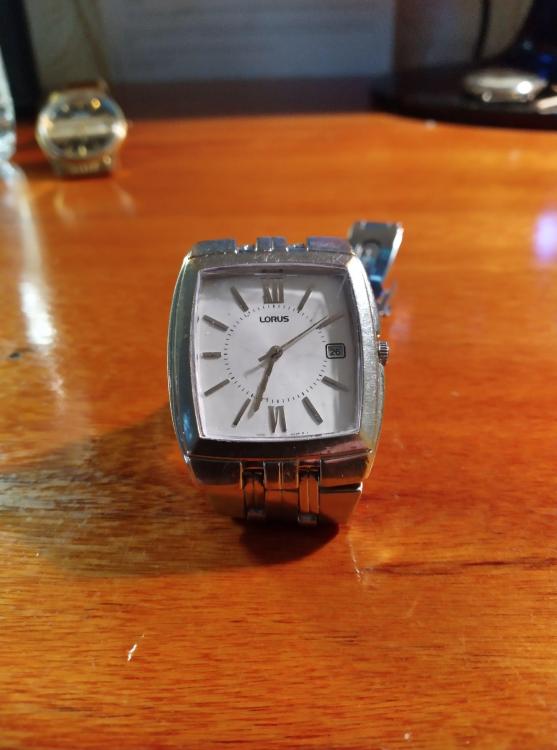

The Lorus looked sad, no crystal and bent hands. I've straightened the hands-ish and fitted a temp crystal made from a DVD disk to see if it worked. Surprisingly it's working.

Cousins probably have the crystal, but it will almost certainly cost more then the two watches combined. I like the DVD crystal idea, I may borrow that.
DVD's are actually 2 discs, easy to separate but a b***er to get the material off. I tend to have a few hanging in the garden, the weather fetches them clean. Otherwise boil them up in a pan (Mrs eezy now has a nice blue ring around the pan ?). They cut and pare easily with a craft knife.
