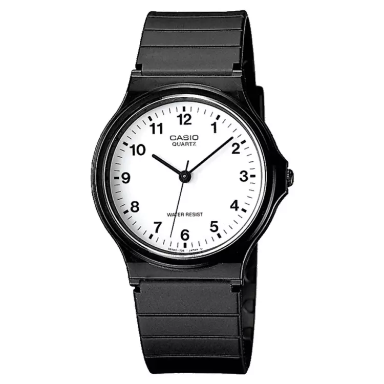

The 0.99p Casio MQ-24 turned up.
It is brand new, never worn, still with the plastic protection film on the front. RRP is apparently £59.00 but you can pick them up for less.
It did however have a flat battery, but since I have a bunch of brand new AG4, I picked up recently, that wasn't an issue.
Guess what I will be wearing in the garden tomorrow.

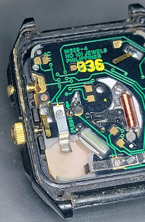

I had a spare 5 mins yesterday so I took a look at the first of the "three for a quid" I picked up recently.
A new battery, a new strap and a fumigation of the case and it looks like new.
Perhaps its most impressive feature is the lume. In the dark, it lights up like Hollywood nuclear spill, and even in daylight it has a slight glow. Well worth thirty three and a third pence I would say.

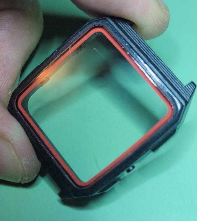

The second "three for a quid" got a new after-market band. I was going to go with a black one but plumped instead for a bright orange.
Described as "High Quality Rubber Wrist Strap For Casio MW-59 MW59 MQ-24 MQ24 MQ-71 MQ71 MQ-76 MQ76 Replacement Black Bracelet WatchBand Strap" on AliExpress, it cost a mere £1.75 plus vat, free shipping (as I was ordering other stuff, so combined shipping was free).
Add in a battery and I now have two MQ-24s that look like new.

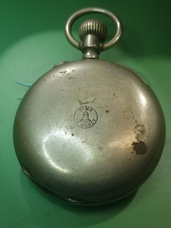

I don't know the manufacturer of the "Time is Money" pocket watch.  My first experience with a pin set movement.  Pallet fork is all metal.  A few jewels are evident.  Time sets fine.  Trying to wind the mainspring has no resistance, so maybe a broken mainspring.  Balance seems good.  Looks like a mucky mess around the ratchet wheel.

Oh wow! I didn't understand the "Time is Money" comment until that last photo. That is interesting... We need a date on that. Reminds me of this 19th century portrait of a guy with Jetsons glasses (actually for protection from the harmful effects of the light from whale oil lamps, whatever those effects were purported to be):

It's also on the back of the case.
