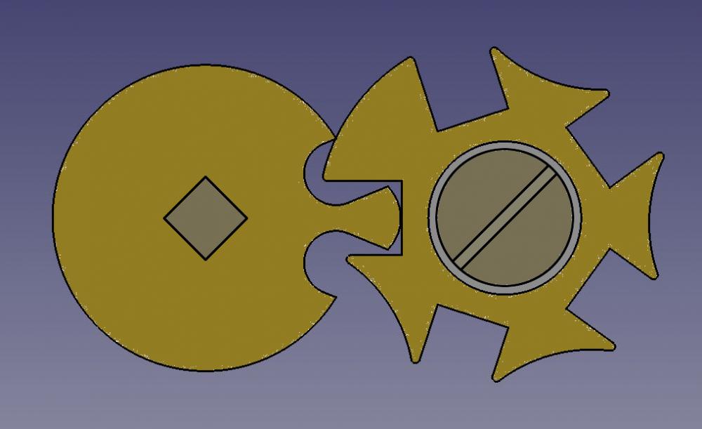

A quick question for the pocket watch experts -In a Maltese Cross or Geneva Stop Work (as seen on this watch), what is the likely cause of being able to wind a short distance, but then hitting a dead stop, as if the stop work has kicked in.
Is this more likely to be dirt, or a broken spring?

I had a look through my various books and a trawl round the internet.
The way I understand the Maltese cross stop works is as follows.
When correctly positioned, the stop works will allow the barrel to be wound a complete revolution for each square cut out in the cross. In the case of the one in the diagram above that would mean that the cross allows four complete revolutions of the barrel before the stop works is impeded by the lack of a further cut out, assuming the barrel cam is turning counter clockwise and the cross therefore turning clockwise in this case.
If this is the correct, then the cross needs to be returned to the zero position if tension is let down on the main spring, otherwise, if the spring was previously fully wound, then the cross will immediately impede winding as the stop works would still be in the stop position.
In other words, there may be nothing wrong with the main spring, it may simply be the case that the tension had been let down at some stage before I received the watch, and therefore, with a little light lubrication and the correct re-positioning of the stop works, it may in fact be fully functional.
Does anybody know if my analysis is sound?
EDIT: I also noticed that most of the pictures I have posted of the case have a very white/silver appearance. This is due to the cold white of the light I use for inspection. The case is in fact a much warmer rose gold coloured. I'll see if I can get some good pictures in daylight once the watch is running.
I’d go with that theory.
once it’s all apart you can assess the mainspring condition and that will either prove or disprove. But I think it’s a sound theory.
