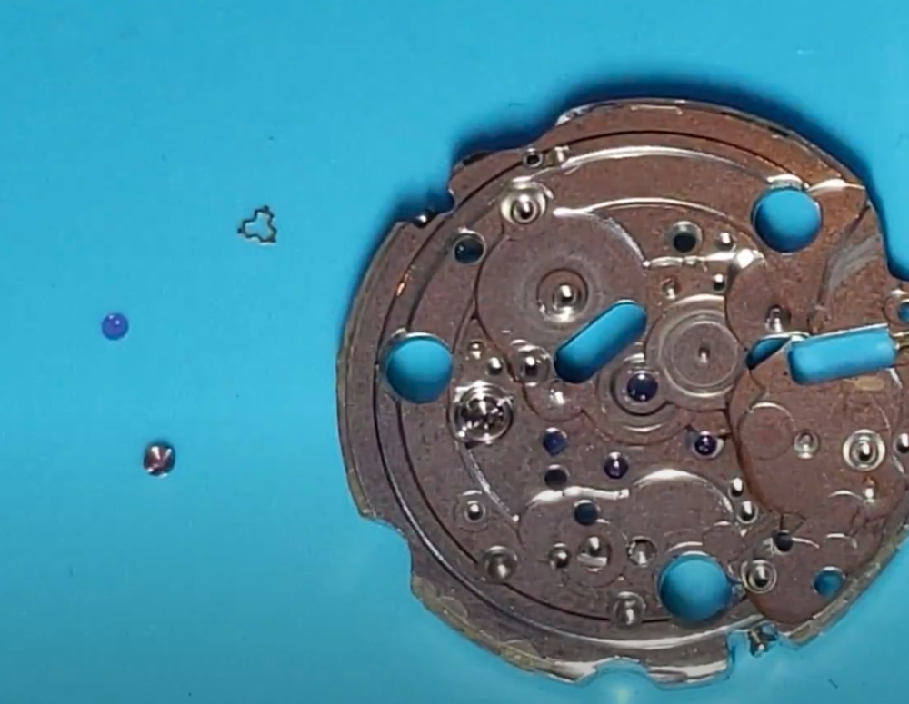

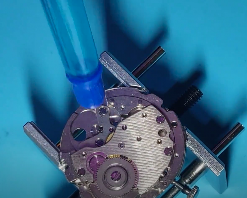

Hey all, I've since re-attempted this and have an update.
Since I lost a couple tiny screws, I ordered another "non-working" watch with a 6309 movement that was actually working, albeit with an extremely low amplitude and wonky timekeeping.
This time I have some better lubricants at my disposal. Using Moebius 9010 for the high-friction parts and 9104 for everything else. I also have 8301 grease, but did not actually clean or open the barrel this time.
Upon visually inspecting the balance I saw it was violently bouncing up and down, so I decided to swap in the balance from the original 6309 movement. I also noticed the oscillating weight on the newer movement had lots of corrosion, so I replaced that as well.

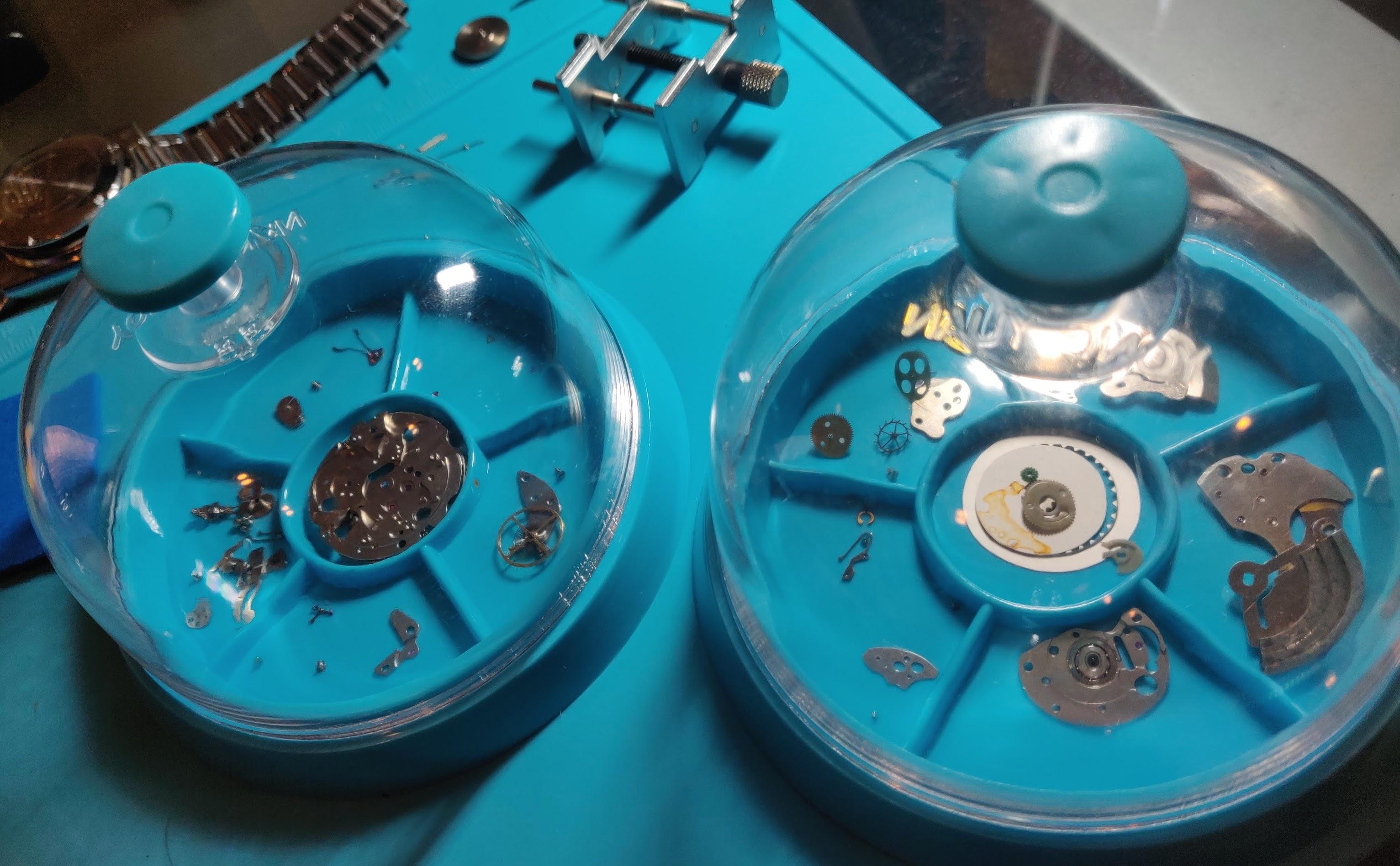

This time, I learned some lessons from the cleaning and tried to keep parts and their screws together in their own tiny baskets during cleaning.
I used dish soap and filtered water for original rinse, then did a bath of filtered water to rinse, then a dip in isopropanol to displace the water.
Then I went through the individual baskets, making sure nothing was left hanging in the mesh or something, and put them back into a cleaned parts tray as they were before. I found the brass color of the baskets made it hard to find Diafix springs when removing as they tend to get stuck to stuff - I have a couple other baskets coming we'll see if I can find a better solution there.
The day wheel had lots of gunk on it which I tried to spot clean but was unsuccessful.

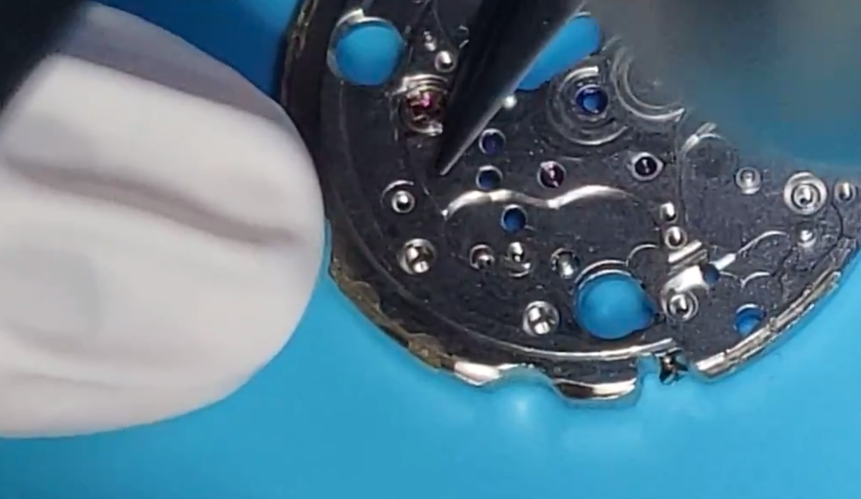

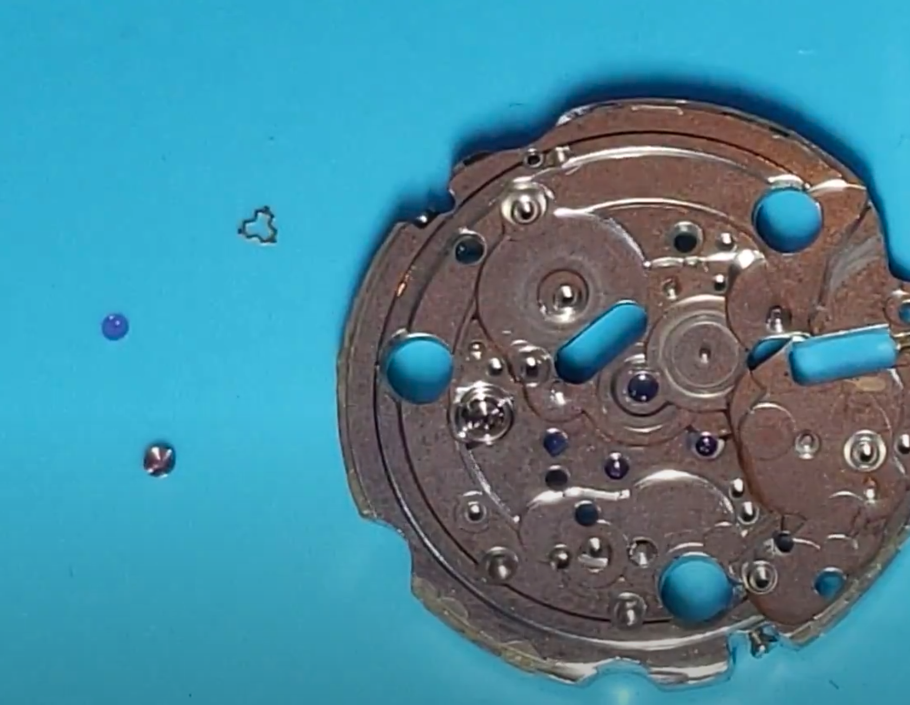

Then, I got to working on assembly. This was my first time taking apart the Diafix settings, which was really interesting.
1480888442_ScreenShot2020-07-19at18_07_49.thumb.png.df0c8399e0e9247e51756f6a954a2173.png
It took me a lot of fumbling and stumbling, but eventually I got them oiled and re-inserted on both the main plate and balance pivot.
Question: Does the cap jewel have an orientation? From what I could tell it looks like it is flat on both sides but I wasn't sure even when looking with magnification. Does it matter as long as old oil is cleaned off both sides?
Anyway, here is me finally getting the spring in on my first attempt after ~15-20 mintues:

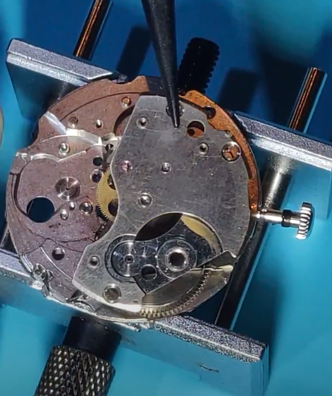

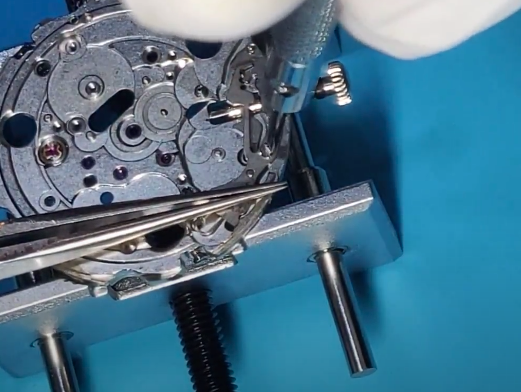

Here I am working on the setting mechanism. Two mistakes I made here:
1) I didn't make sure the setting lever spring was meshed with the setting lever
2) I thought I used the correct screw, but it turned out it was just sitting in there loose, so eventually when it all came together it fell out and I had to retrace my steps to fix the setting mechanism :)
1646422217_ScreenShot2020-07-19at18_13_20.thumb.png.cb14d6bf91ae463bd350347a854f1a21.png
Placing the bridge over the gear train and barrel:
1668162830_ScreenShot2020-07-19at18_17_10.thumb.png.39ed8d11149c3049f85d51a2ee52392a.png
Once I had the ratchet wheel, pallet, and pallet cock in, I wound the mainspring a bit and gave some puffs of air to make sure the pallet was locking and releasing properly:
74517393_ScreenShot2020-07-19at18_19_23.thumb.png.8ee468a92ba34d1d70fb194d51c4fad7.png
After this, I just placed the balance temporarily to make sure all was in order and sure enough it started ticking :)

1) I installed the automatic works minus the oscillating weight (saved this for the last step so it wouldn't get in the way
2) Calendar works with a lot of trial and error realizing I mixed up a screw in the setting mechanism
3) Re-set the hands and tested out date/day quick-set and setting the time
4) Put the watch in beat - this was interesting as I was having a hard time, I think the stud carrier and adjustment lever were waayyy out of whack. At one point I just visually looked at where the pallet stone is at rest and tried to orient it to be perpendicular to where the pallet fork is. After a while (I think the lubricants needed to be "broken in") I started getting much better, consistent results - but something was wrong.
As was suggested here I took a look at the movement of the hairspring by filming the movement of the balance wheel. I noticed the "terminal curve" (I think it's called) did not look good and just tried to get it to a place where visually it looked straight by adjusting the stud carrier and adjustment lever.
This somewhat miraculously produced a good result, once it settled in and I made some micro-adjustments, I got the watch to ~205-220 amplitude, +/- 10s/day.
I think the low amplitude might be caused by the mainspring, as I left it as is and didn't even open the barrel to visually inspect. I have another 2 of these 6309 watches, so I'll try cleaning the mainspring on my scrap movement and make sure to do that in my next service.
