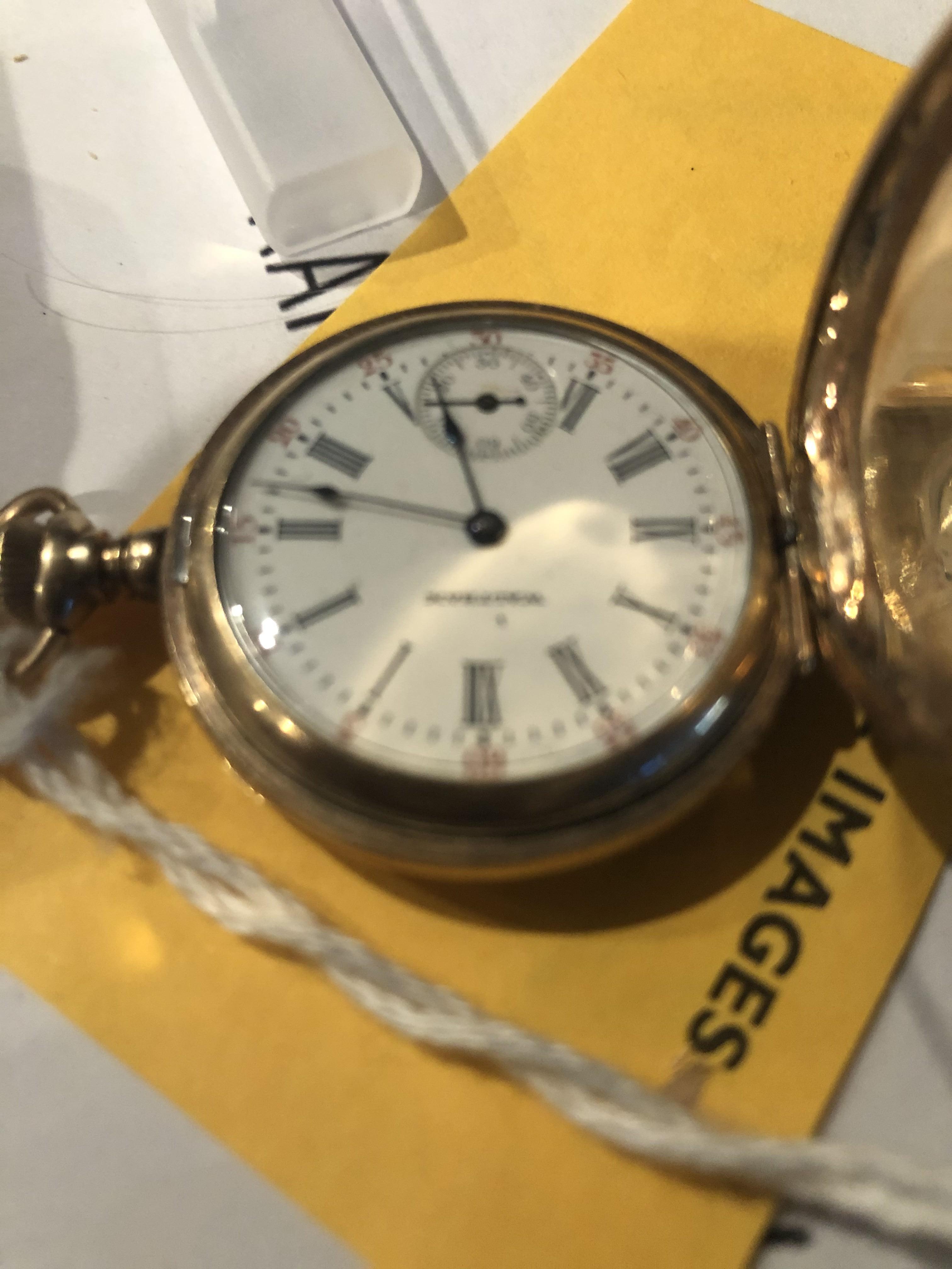

Waltham pocket watch not running

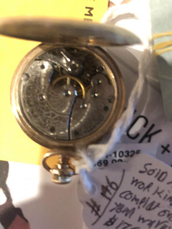

The stud screw is shared off, or it is missing. You have to remove (to press out) the stud from the stud carrier. This means to support the end of the stud carrier on the edge of something while holding the cock in a manner that the balance will be free to fall down and to press on the stud with proper tool. But I don't expect the balance to fall, as the spring is possibly wrapped above the cock. So, if this is true, try to gently "unscrew" the spring or in some other kind manner to release it, then show pictures of the damages. If it is still OK, then consider it as a miracle. -
