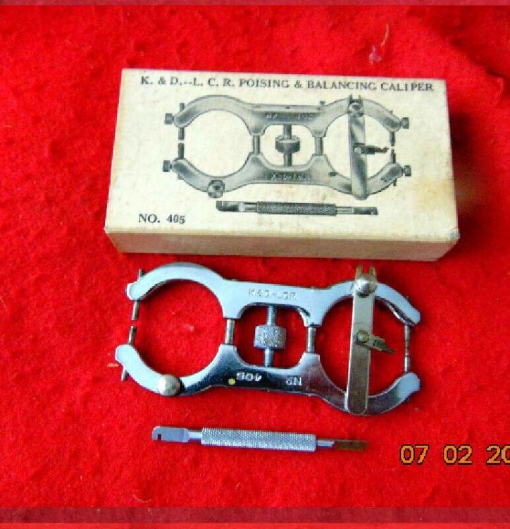

Hi well done so far Now you need to learn trueing the balance in the calipers and poising the balance.  Firstly you need a pair of truing calipers or a truing jig so as to get the rim running flat then poise the balance in the jaws to check if there are heavy point, either of these being out of true will affect the timing rate . Pictures of the tools  below.:thumbsu:

I won this on auction a couple of days ago. It is on it's way. I suspect that the set screws are missing judging by the picture on the box, but I can sort that out once it gets here. It otherwise looks complete to me. I'd eventually also like to get the other model you show but is not in the foreseeable future. An ultrasonic cleaner will come first.
Hi  you are nearly therewith the tools. the little wrench is for tweaking the balance arms,  Unusual for the staff removal tools to distort the balance they are supposed to keep the arms flat to the stake during removal of the rivit.
