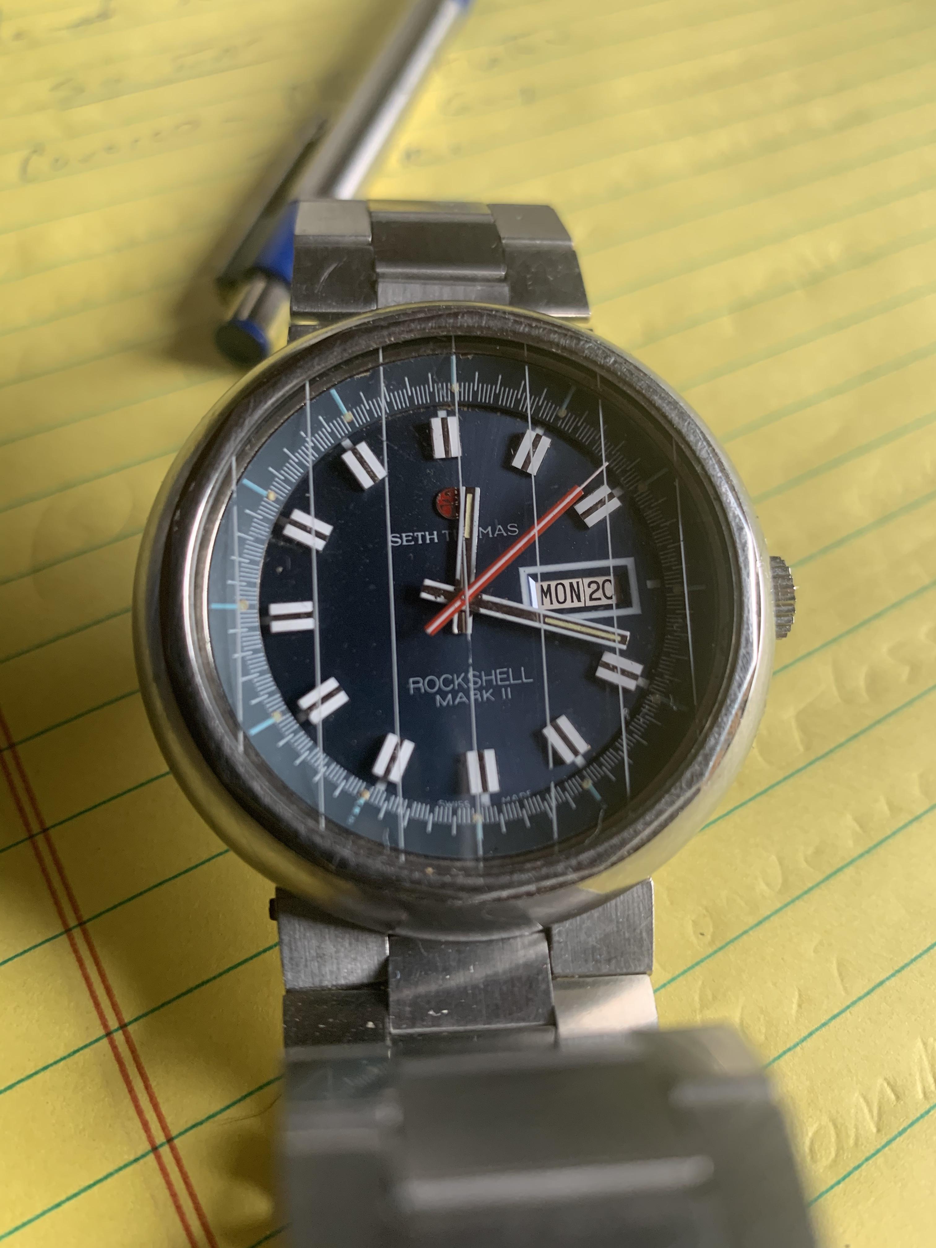

Roamer (set Thomas). Rock shell 2
My suggestion would be as you are in USA to take a look at Sherline because they are in USA & still in business & you can not only buy the lathe but also a milling attachment & a manual or computer controlled indexer either separately or as a complete kit. I don’t have Sherline or have anything to do with Sherline but a lot of people doing watch & or clocks use them to do some very nice work , have a look at Jerry Kieffer on NAWCC. https://www.google.com/search?q=mb.nawcc.org+Jerry+Kieffer&rlz=1C9BKJA_enGB1138GB1138&oq=mb.nawcc.org+Jerry+Kieffer&gs_lcrp=EgZjaHJvbWUyBggAEEUYOTIHCAEQIRigAdIBCTI4NjI2ajBqN6gCE7ACAeIDBBgBIF_xBf8MHBWZkt3l&hl=en-GB&sourceid=chrome-mobile&ie=UTF-8 Dell
