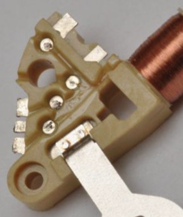

Hi Guys,
Apologies if this has been answered elsewhere - on the diagram above what exactly is meant by "1: Control coil"?
If one (let's say me) were to have an open circuit between these two points, what does that mean?
Best
Bob
4 hours ago, bobtheterrible said:
if one (let's say me) were to have an open circuit between these two points, what does that mean?
So my interpretation of the question is that you level watch that doesn't run and the coil is open?
Hi @JohnR725, that's right. I have a non-running 9162. I have checked continuity and resistance across the points in the circuit diagram above and was reading open on 1.
I was trying to assess which part of the module this represents in case it was salvageable (i.e. bad transistor resistor etc...) if it is absolutely beyond repair I can put it in the box labled "hopless" and look at a replacement module.
So all you know at this point is that either the coil or where it connects to the pads is damaged.
I think a closer look under the microscope would help.
Failing that it depends where your are in the world and how much you're willing to spend to attempt the repair.

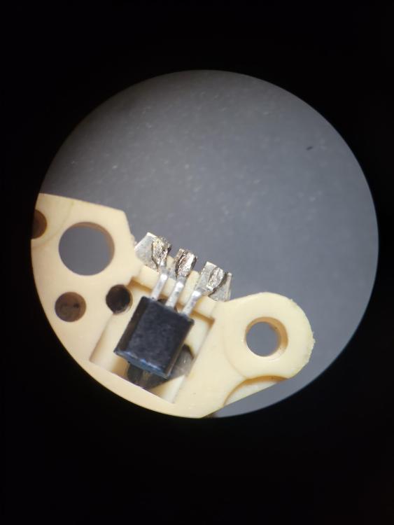

OK, some pics from under the microscope. It all looks OK, so I'm guessing there is a break somewhere in the coil. I hadn't realised up until this point that the transistor pins are reasonably accessible - maybe when I'm feeling brave I will attempt to desolder it.
@JohnR725 it's interesting what you mention about equipment. I'm using consumer grade multimeters. My okish digital multimeter gives no resistance reading while my super cheap analogue multimeter at least shows something.

Thanks @AndyGSi I had seen the "scratch" but could not see an obvious break - I could perhaps attempt some conductive paint?
As for the solder joints - now you point it out, I see the dry joint in the middle. If this were the only problem would fluxing and touching with an iron reform the joints?
Conductive paint would just short everything broken together so don't think it would work.
Yes a drop of flux and fresh solder on the iron and it should reflow OK but you need to be careful with the temperature so not to melt the plastic.
