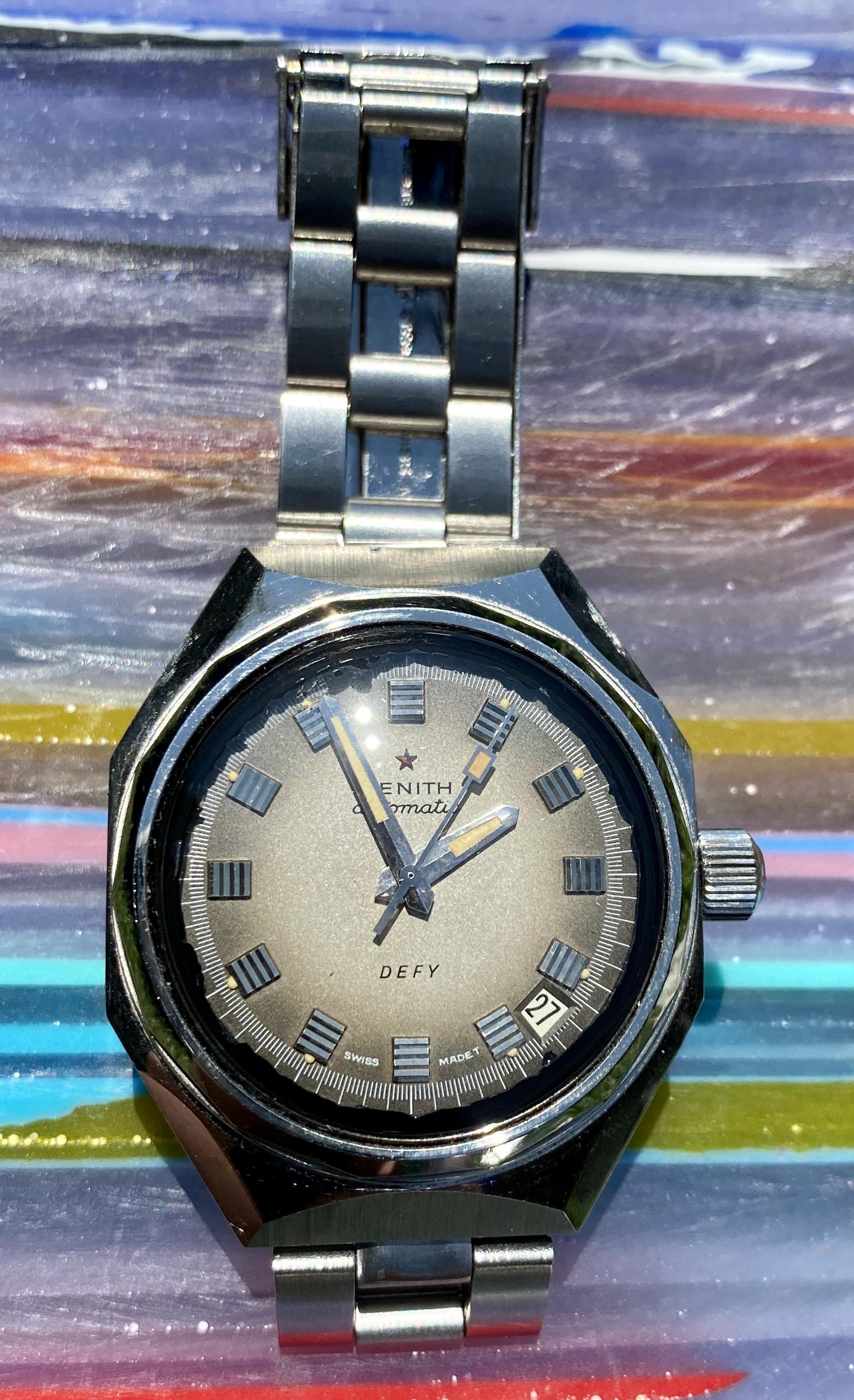

I'd appreciate any advice you might be able to share here. This watch is well beyond my ability to service, and I'm having trouble determining what the correct path forward is. Thank you in advance for any suggestions on how to best proceed. I'm pretty freaked out.
Background: A few weeks ago, I bought a nice unpolished, 100% original Zenith Defy A3642. This watch was purchased new in Paris in 1972 by the seller's father, who recently passed away. Per the seller, his father wore the watch only briefly after purchase and put it into a safe where it sat for 40+ years. One of the reasons this watch was so attractive to me was the fact that it was pristine, and I planned on having it completely overhauled. I posted a little while back asking for input on a deteriorated crystal gasket that was visible in this watch, realized that it was beyond my skills to fix (in part because I couldn't find the correct Zenith caseback die), and made sure to discuss it with the watch repairer I sent the watch to. I sent the watch to someone who sounded to me to be quite qualified to overhaul this watch. He is described as "a highly-decorated skilled master watchmaker with over 37 years of classical watchmaking experience. Having been the Technical Director of Vacheron Constantin, among many other prestigious positions at brands such as Girard Perregaux, Breguet, Richemont, and more, [Name] can handle every watch complication that comes his way including tourbillons."
Unopenable Caseback: I received this status update tonight: "[Name] is trying his best but it looks like we may have to deny service as we are having a ton of trouble getting it open. Caseback gaskets have seized up and the watch is not water resistant so we cannot boil it off. We are gonna give it one last shot tomorrow."
Given the visible deterioration of the crystal gasket, I'm not surprised to hear that the caseback gasket has deteriorated as well. When I received this watch, I failed to open its caseback with a rubber ball ... but I didn't think that it would be described as unopenable. Has anyone run into this situation before, where a deteriorated gasket has jammed a caseback to the point that it couldn't be opened?  I hope that the issue isn't just that the shop doesn't have the correct hexadecagonal Zenith case back opening die. (I asked for confirmation that they have the correct die, and hope that I didn't offend them by asking that. It just seems like a fairly esoteric tool.) Are there any slightly more aggressive techniques that might work? Boiling the caseback off doesn't sound like a particularly safe technique, and I'd be OK getting some scratches on the caseback if that were the only way to get it open. What about gently heating the caseback to try to get the rubber gasket more malleable? I guess this is one of the hidden risks of buying a watch that looks pristine but obviously hasn't been serviced in decades.
What's the Plan? This watch was a significant purchase for me. It's not a watch I'm trying to flip. I had (briefly) considered mailing this watch to the Zenith factory in Le Locle for service, but had ruled it out as likely to be significantly more expensive that other options with a significantly longer turnaround time. Given the puzzle of the unopenable caseback, this is sounding like a better option. It would probably be very expensive, but I imagine that the factory would have an original NOS caseback they would happily sell me for a very high price if there's no non-destructive means of opening the caseback.

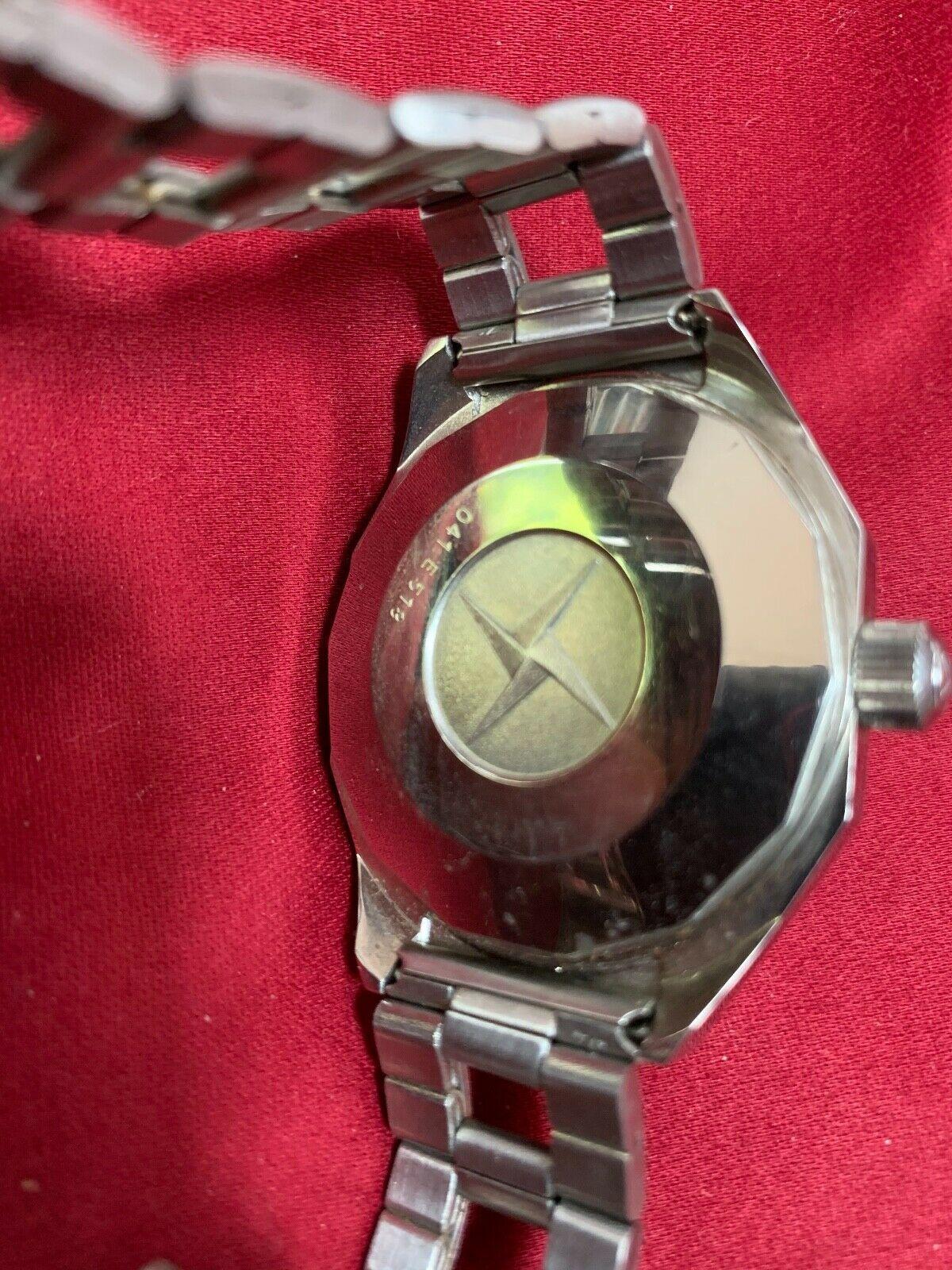

I don't suppose we can get a picture of the back of the watch?
I didn't take a good picture of it, but here's the picture from the seller showing the 16-sided caseback.
What has happened is the case back gaskets has sort of disintegrated and turned into tar like substance. It holds the case back on really really tight.
What you need is somebody who has a case back opener like the one below. What makes this holder interesting is you can hold the movement very securely in the vice. You change the jaws to the flat ones as you basically Have flat sides to grab. The lower it down and as the video shows you can move the or spin the locking ring which locks it in place. That means everything is Held really really secure and then you put a heck of a lot of pressure on the handles and if you're lucky the case back will start to rotate. As soon as it rotates a little bit then you twist the locking ring a little to release it and slowly can Remove the back. Sometimes though you might have to put a penetrating oil on the edge hoping that that might make things better.
Others in the past in this group have suggested things like gluing or epoxy glue something I a really big not and using a suitable ranch.
https://www.nielsmachines.com/en/precista-generic-bench-top-watch-case-opener.html

I have also encountered front loading cases with backs that appear to unscrew, but in fact do not. Check with a microsope to ensure there is actually a break between the front and the back, and that they are not actually case as one piece.
