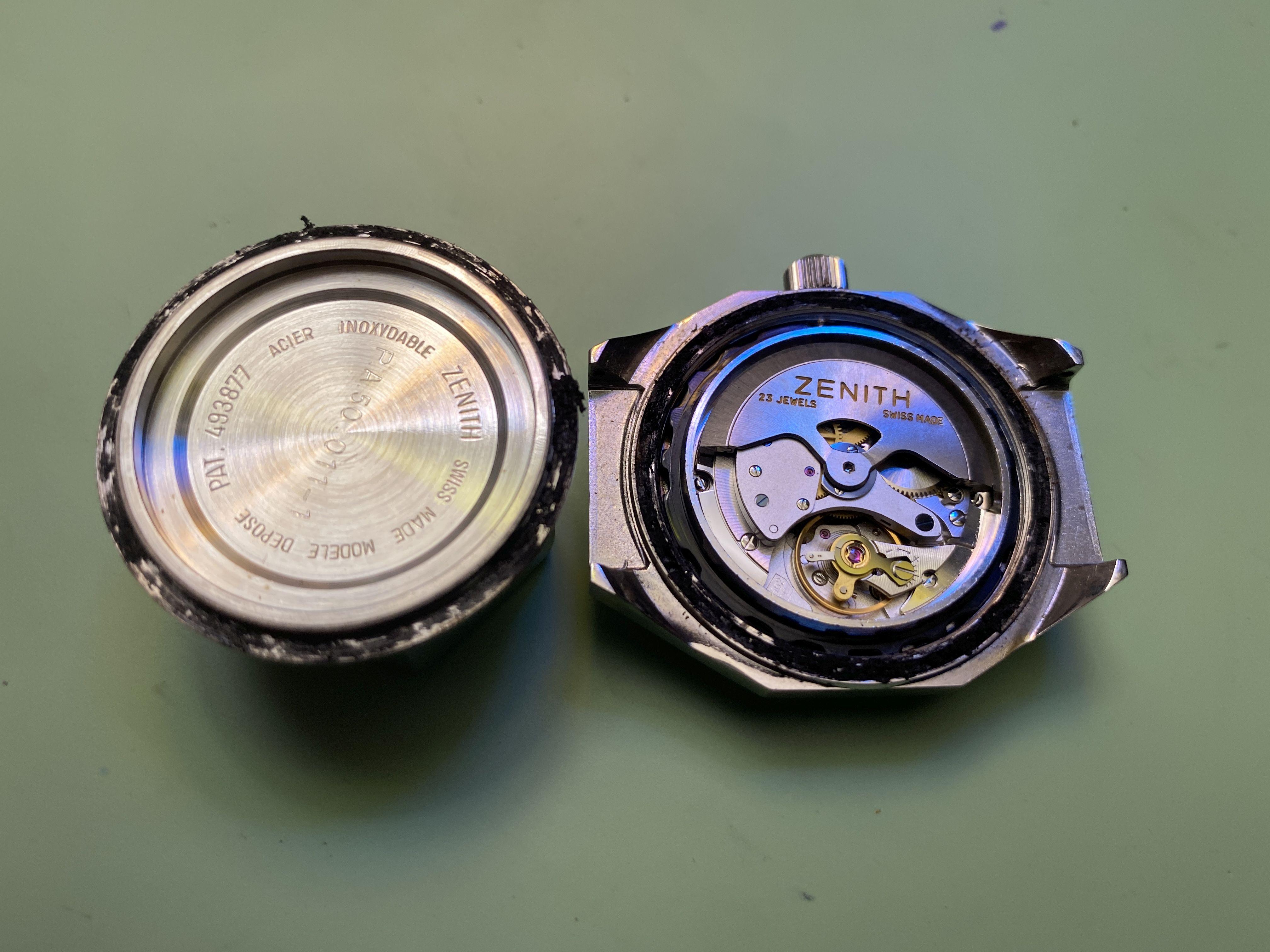

I've had several watches with incredibly tight case backs. The glued nut and wrench has worked for me 100% of the times so far. I don't use a case holder when using the wrench as you can break it, instead I wrap it on a piece of fabric so I don't hurt my hand when holding it. Then I let the case back on pure acetone until the CA dissolves.
@aac58, thank you for your optimistic suggestion! From a lifetime of Games Workshop miniatures, I'm really comfortable working with superglue and acetone.
I don't know if I'm strong enough to grip the watch by hand like you suggest. I'll be giving it a try by hand before I buy a Bergeon 5078 or a Jaxa 5090. I'd hate to spend the money on a vice only to break it on its first use.
Have used the glued on nut method myself and had no problem getting the back off or removing the nut leaving the case mark free. Warming it up as mentioned before may just help to soften the deterioated gasket before removal making it a bit easier.
If I were you, I'd probabl aim to take the back off myself and see if you can find someone reputable who can do it for less than half of what you were previously quoted. It's a conventional automatic, so shouldn't be tricky.
I had a titanium case with titanium back (dumb) that galled and would NOT come off. Gasket was actually fine; Ti on Ti galls, and is as good as welded.
I got it off by using a can of "air" blower, inverted to release the super-cold fluid. This shrunk the back enough that the (correct) tool could get it free. Once it was off, I polished the threads on the back and case; applied Aerospace anti-gall compound and reassembled.
Moral of the story is: try freezing it off. A piece of dry ice will probably work.

I'll try the freezing, as well as heat, if the super-glued nut trick doesn't work immediately.
I've been quite tempted to send this watch to the Zenith factory in Le Locle. I just have a hard time swallowing the estimated $1,000-2,000 cost and 9 month time commitment for a factory repair.
I'm confident enough in my skills to pull the gasket gunk out, provided it hasn't flowed into the movement itself. I'll also be looking at whether I can *gently* pick off any crystal gasket gunk that is stuck onto the dial. Beyond that ... I'm sending this watch to someone good, not butchering it myself.
I should have the watch back in hand on Wednesday. Updates forthcoming.

@Tudor I take your point completely. I'm definitely not trying to cheap out on this watch. I *am* however, now obsessed with the idea of getting it open myself.
Here's the current status: I received the watch back from its service today. I could not see any signs of damage from their attempts to open it, which is good. I've glued a 1 1/8" nut onto its back. I centered the nut as best I could, and it's glued onto a very flat and smooth portion of the back. (I had tried to get a bigger nut, but this was the best I could do. I'm sure that, if this method will work, it will work with a 1 1/8" nut.)
The glue is curing for 24 hours, and at that point I'll be working to open it with a 1 1/8" wrench on a case vise that I've mounted in a bench vice. Hopefully the case vise will be ok, but if it's not I'll brace the watch with some wood on the bench vice. If my initial attempts are unsuccessful, I'll try careful heating at a single point with a soldering iron and/or the liquid from a can of Dust-Off to cool it down at a single point.
Fingers crossed, and I'll keep everyone updated! Thanks all for the encouragement and talking me down from a cliff of despair.
Well, that was so easy as to be anticlimactic.
I figured 30 minutes was enough curing for a glue I would be removing with acetone anyway, so I gave it a shot using my desktop jeweler's vise (cushioned by some soft plastic). I wouldn't have tried this without a case vice except that I noticed the design of the lugs gave two nice reinforced perpendicular surfaces that would fit easily into a jeweler's vice without significant risk of damage. Slow, even pressure with a 1 1/8" wrench opened the caseback on my first attempt. Easy peasy.

5 minutes ago, Rafael said:
Nice job dude. I would send this picture to your previous watch guy.
Already done. To be fair, I wouldn't expect a watch repair shop to have tried this method since it has a (small but non-zero) chance of damaging the case.
Now that the back is off you can clean up the gasket mass.
Now that the backs off we can see the watch I would probably drop the word vintage off for the description. Anytime you use the word vintage in watch repair the price goes up considerably. If there's fear of availability of parts the price will go up. So if you're just getting an automatic watch serviced the cost should drop by quite a bit.

It should be straightforward for anyone working on it. I’ve found in the past that I’ve had to use acetone or petrol to dissolve the old gasket. I have a suspicion that gaskets dissolve like this when exposed to the wrong types of oils/greases. Which is why I always use actual silicone grease.
Good points all.
After a quick dip in acetone, the nut popped off easily using pegwood.
The softened glue came right off using pegwood as well.
I'm currently cleaning the deteriorated rubber. It's coming off pretty easily, but there are some stubborn spots. Solution? More acetone and pegwood.
