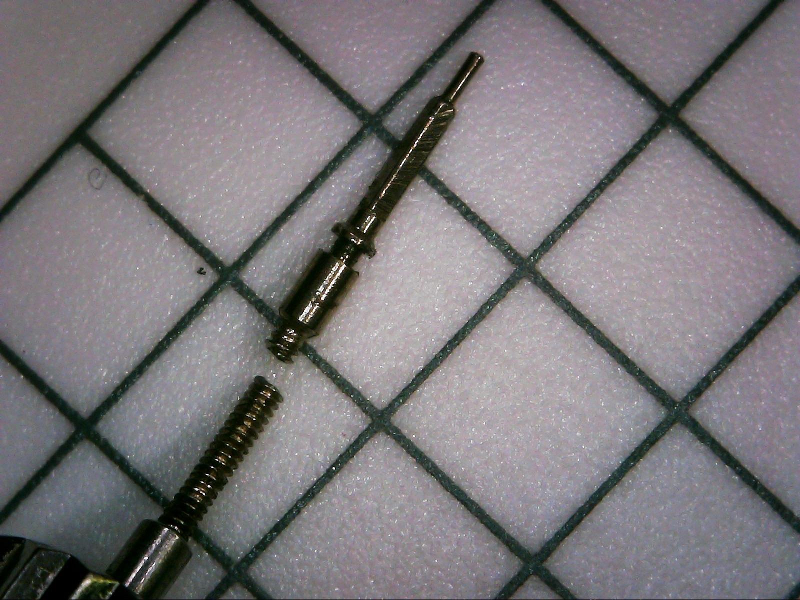

Hi , Can anyone identify this winder stem and advise where I can buy one please. it comes from an Ingersoll Chronograph movement 4511. Many thanks
Tricky, If i'm not mistaken this is one of those chinese tourbillon movements. I can find no other information about it, parts don't appear to be sold anywhere obvious.
I'd suggest you probably have two avenues.
1. Get a stem extension. There's really not a lot of thread left on the tip of that stem, so it's not ideal, but it might work. Stem extensions can be obtained by virtually any watch part supplier.
2. Cousin's has a page of chinese stems with detailed information about the various dimensions, you might be able to take measurements with a vernier guage, and it might match up with one of the stems offered there.
https://www.cousinsuk.com/product/chinese-movement-stems?code=DG2803401
Brilliant advice many thanks
If you choose to use a stem extender, you best solder the joint too, since not much thread is left.
Make sure to clean and rinse the stem, as you instal the extender, you be left with a groove between the two pieces,  solder it, to strengthen the joint.
Many thanks for all of the help with this question. Stem extension did the trick brilliantly. Completed and fixed with some thread adhesive and it appears to be holding well.
