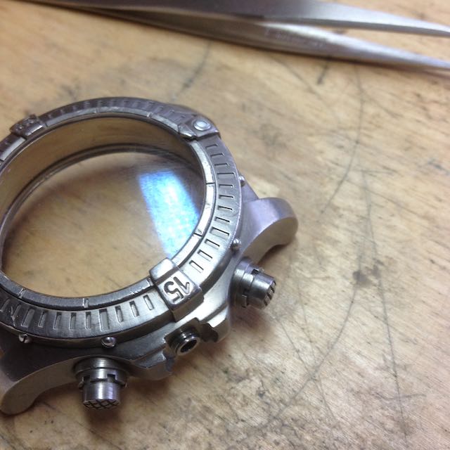

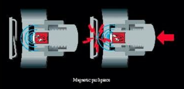

Ok been working on this problem this morning. Apologies first, the pusher has NOT got the detachable magnet as I first thought but the end of the pusher is however detached. The magnetic pusher style is only for their quartz movements.
However the part that I received from  the USA was not correct so I had to straighten the existing parts. See pics attached but basically after stripping the pusher I could see using a loupe that the bend was where the pusher screws into the cap. Despite adding heat the shaft of the pusher still would not move, or to be precise I was not sure if it was moving or braking. So I decided the best option was to straighten it still attached to the pusher cap. I clamped the pusher cap in a a hand held vice and slowly & very gently straightened using a punch that only just fitted over the shaft. Then re-assembled silicone greased the tube & o rings re-fitted & job done. Just need to service the watch now !!!!

Good job CB, I do that all the time, you just got high tech for me on this one...I use pliers and eye ball it, trial and error so to speak...so far so good for me...cross your fingers! Your "walkthrough" will be very helpful for me next time I tackle one!

Thanks Bob, me to but my Rolex needed servicing & now this is my son's Breitling so really sort of been pushed into it. A big learning curve but enjoying it so far anyway.
