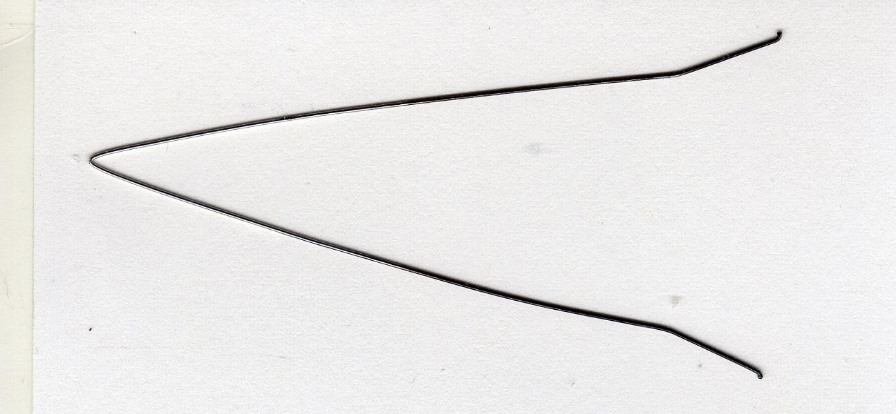

There's this other hack tool that appears to be some kind of thin wire. I don't have an extra stem to try the stem mod tool, but if I tried the wire tool, where exactly would I try to engage the set lever? And it's difficult to tell exactly what kind of wire that is.
What do you all think?

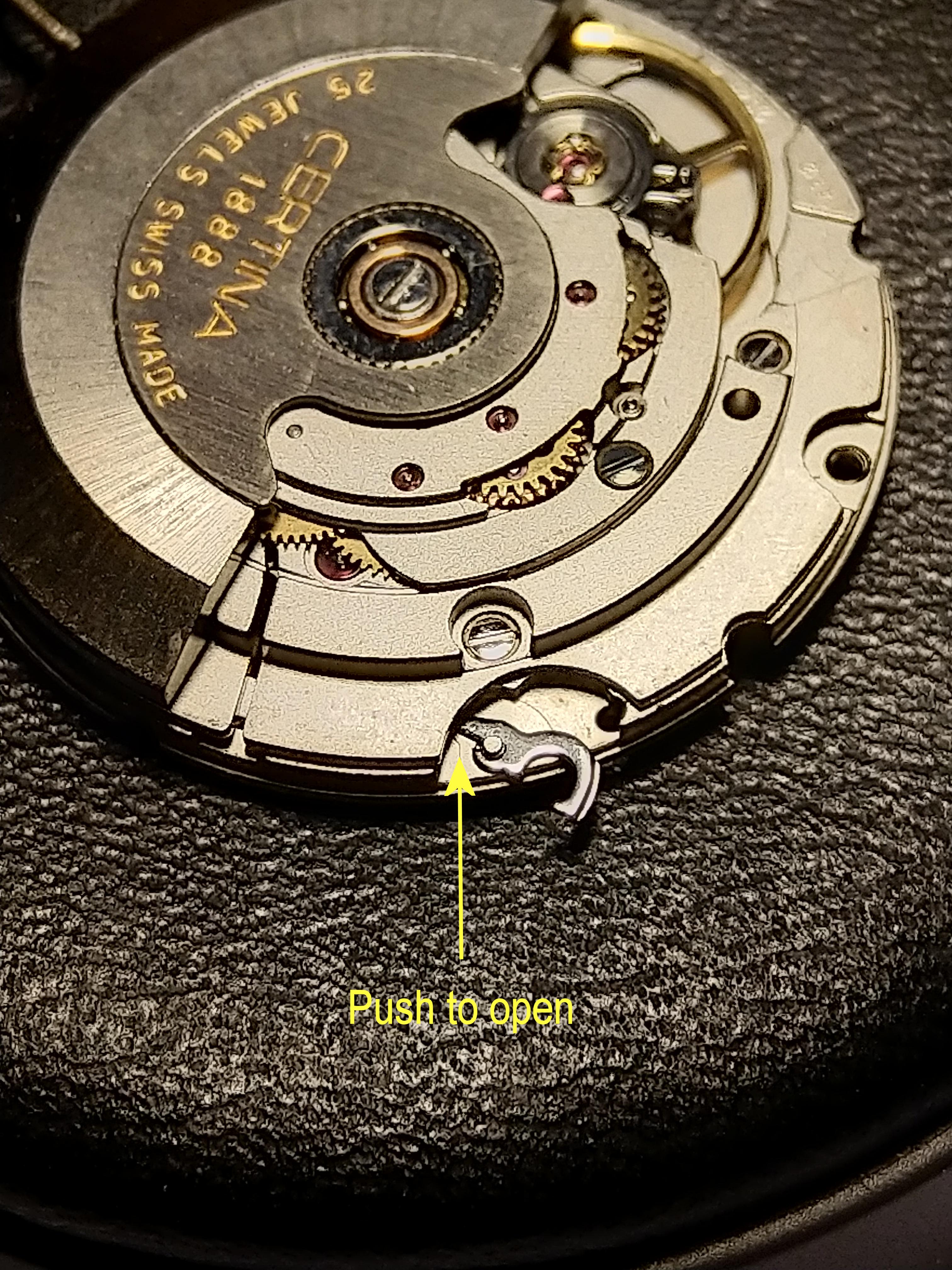

I very seldom post pictures without saving them in a PDF but since the pushing the pin too deep is a common accident I will do a small walkthrough in the wrong section,  guess one can show what happens in one picture but not how to correct it.

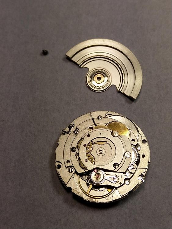

To begin with I usually just take off the oscillating weight, just to ensure it will not be in the way in the movement holder. It is kept in place with one screw.
Since the stop lever is operated by the sliding pinion, we will assume the lever is still in place but is not working because of a faulty keyless work.

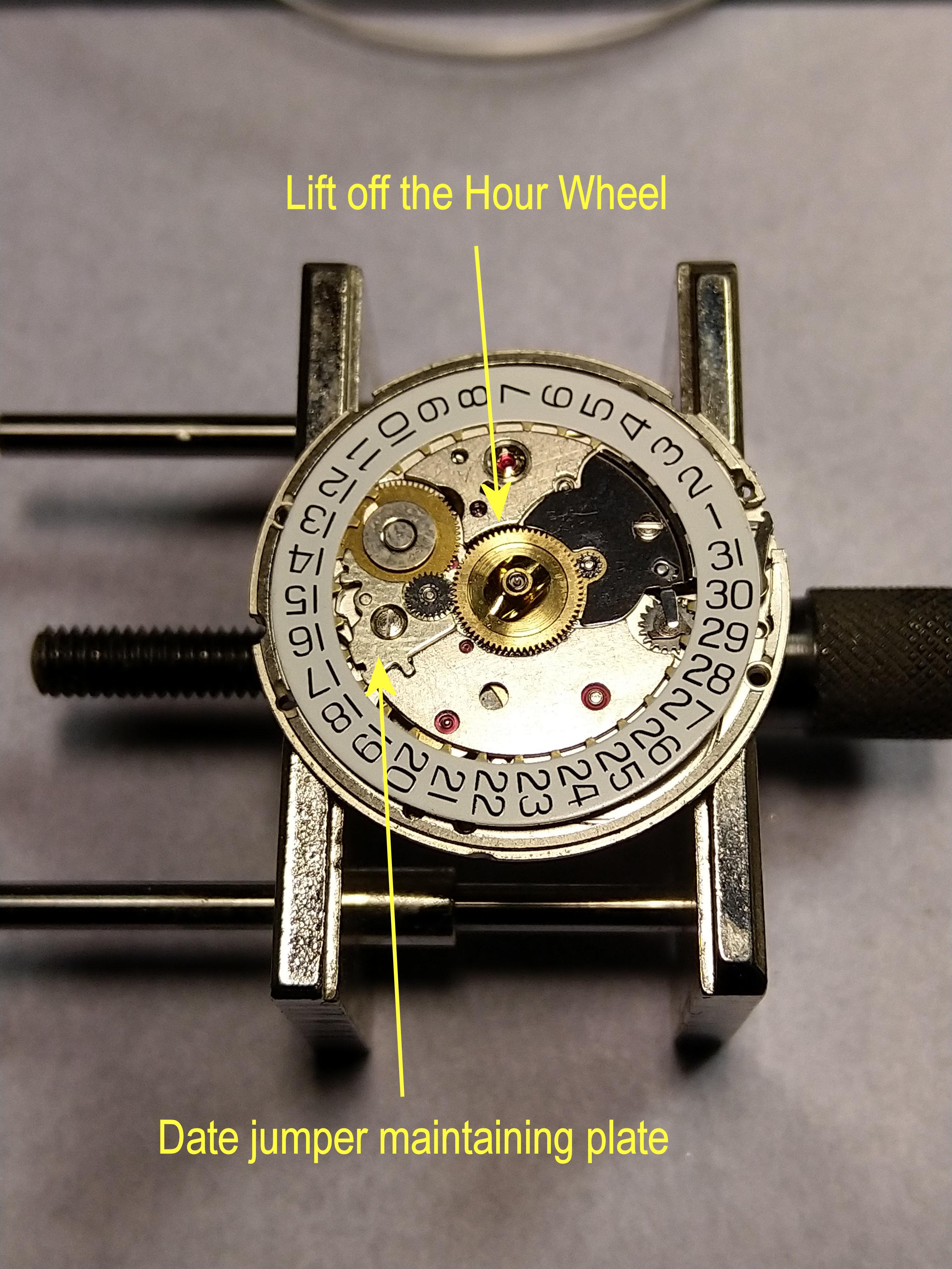

Now one can safely put the movement in the movement holder. I now lift off the hour wheel.

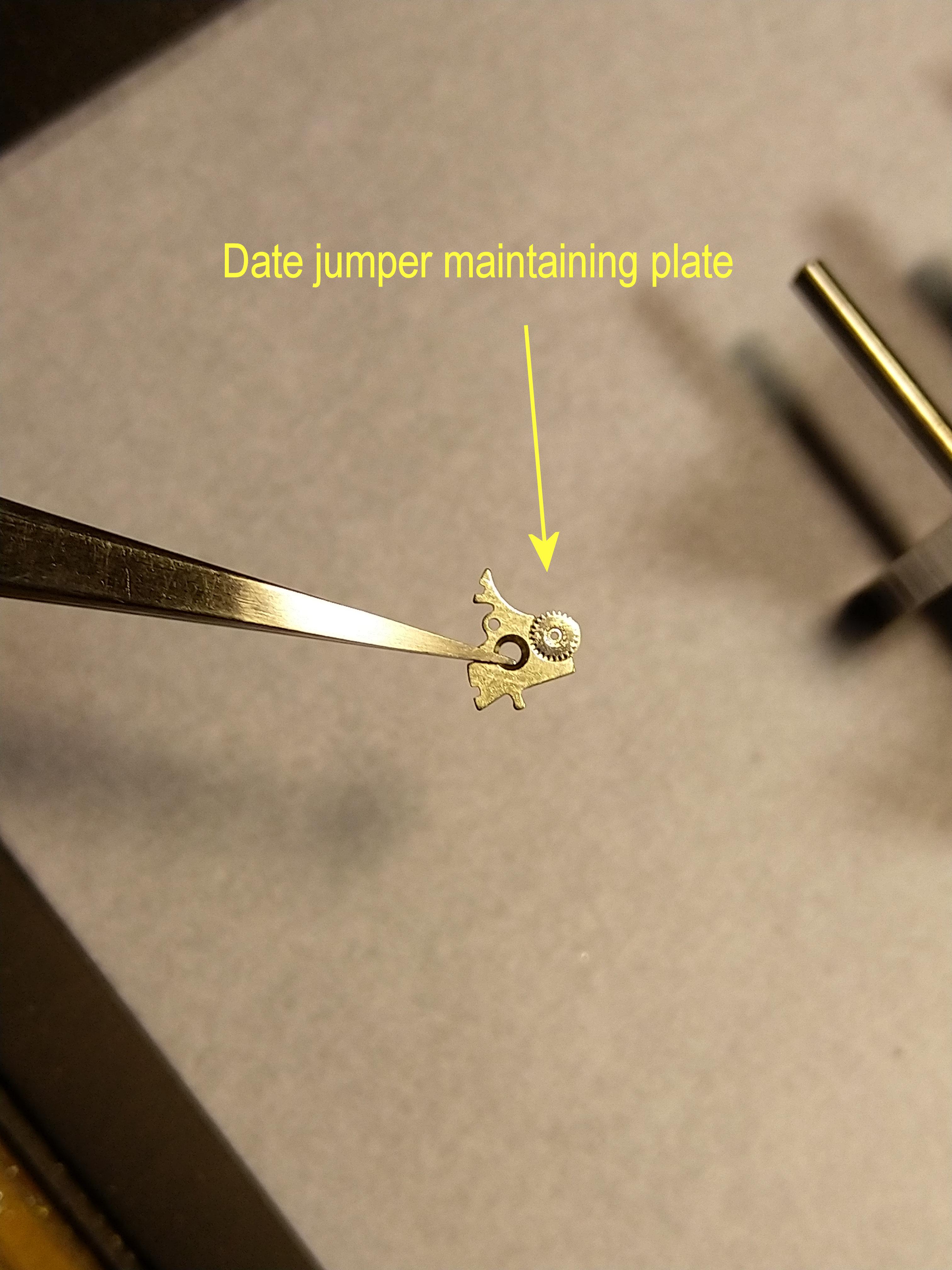

Next I remove the date jumper maintaining plate. I think it always is best to remove the date indicator so you don't risk to damage it and create more problems.
Since this small instruction probably is applicable on other movements too, I would warn that the small pinion on the plate sometimes can be very loose so keep track of the parts.

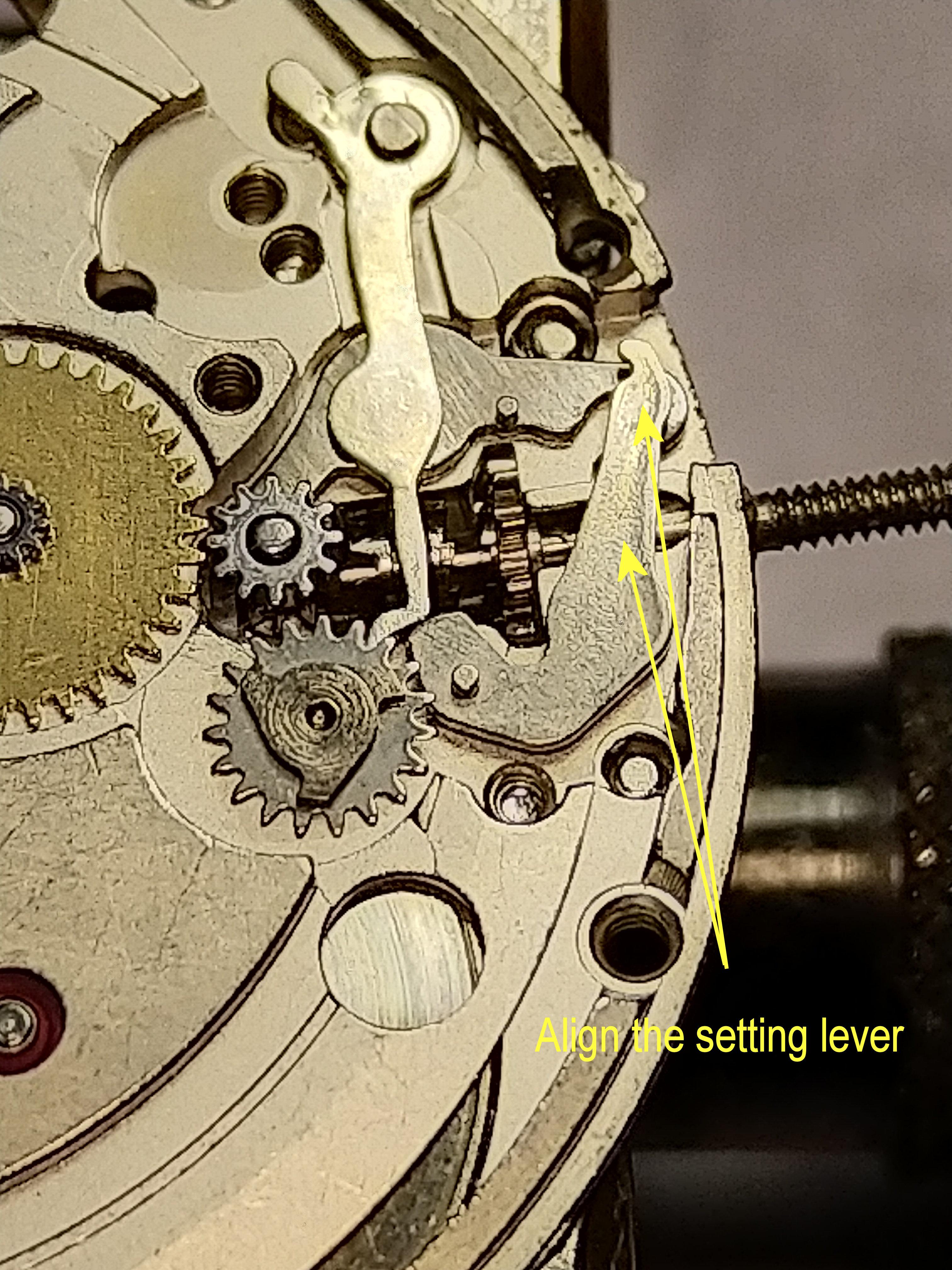

Now one can see what really happens work when one push the setting lever nob too deep. The lever is popping out and misaligning the most of the parts in the keyless work.
Now the setting lever jumper is taken off and inspected. This one still looks good.
There are three small pins or nobs on the setting lever. These has to get into the correct places in order to get the correct function. One now can see the pin holding the stem isn’t very high, so it will just take a gentle push to get the stem released.
Most of the times the corrector lever is still in place. Here you make sure the yoke is in the sliding pinion groove and everything lies flat and nice as in the picture.
The setting lever can now gently be lifted into place. At this moment I put the winding stem into place so I can be sure the setting lever comes into the correct positions. Make sure to align the pins in the setting lever to the correct places. The stem pin goes into the groove in the stem and the corrector lever pin goes into the hook shaped part of the corrector lever.

@HSL Thanks so much, my friend, my first lesson is complete! I had to repeat the process 6 times due to my clumsy missteps but in the end after several hours I have everything back up crown and stem reinstalled, and all seemingly running smoothly. In this case, the yoke had popped out of the sliding pinion groove.
Overall it was quite like open heart surgery, in that the movement was running the entire time. I'm not sure whether I should have tried to stop it while I worked, but all is well that ends well. Now, I know the keyless worked inside and out!
