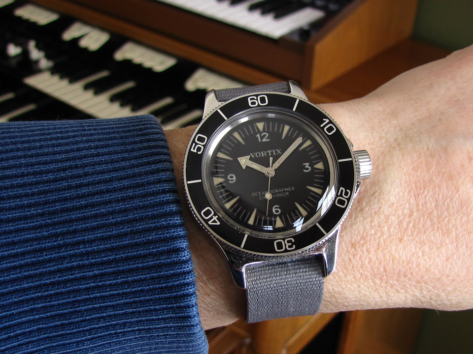

Last weekend, I completed my latest watch project, a(n) homage to the Omega Seamaster 300 Master Co-Axial, based on a Russian Vostok Amphibia, case style 120. I replaced the bezel with one from Dave Murphy that accepts Seiko-compatible inserts, added an insert from Dagaz watches, relumed the hands with a slight patina, and then made a new dial to match. Here is the finished result:
Here's a before and after picture:
The process for making the dial differed slightly from my previous project, where I had printed the artwork on photo paper which was glued to the dial blank.
In this project, the artwork was done using transparent waterslide decal paper, applied in two layers to give a sufficiently dark black. The decals were applied on top of a layer of luminescent tape.
Edited by svorkoetter

I like that.....
A lot!!!
I am really impressed with your dial making. I have thought about using water slide transfer paper my self, just not got around to trying it yet.
You may have just spurred me on.

Hello Stephan,
Really pristine looking watch.
I think you may have given me some ideas to convert some of the dials I got from Portugal.
Cheers,
Vic

Hi Rickyt. At the moment, I don't have the time to make any extra dials, as they take quite a while to make, and tie up my workshop for a few days because I have to avoid making any dust. Also, a dial like this is not the best choice for a beginning modder, since the finish is very delicate, and sometimes it's necessary to tweak the movement slightly to get enough clearance for the hands.
For a first mod project, I highly recommend picking up one of the many Seiko 5 series of automatic watches or an Invicta 8926 (a great watch from a horrible company), a dial and hands from 10watches.com, and if you wish, a bezel insert (from 10watches for Seiko, or an aftermarket Rolex Sub-compatible insert from eBay for the Invicta).

What's wrong with exploring new ways of doing things, especially if it can produce good results? If you didn't know the watch below in this post was on photo paper, would you be able to tell?

Exactly. Here's my "photo paper" watch. You tell me if it reminds you of car painted with a brush:
Remember that most vintage watches had hand painted dials. Using paint. Applied with a brush. This photo paper technique produces a much higher quality result, and with all the coats of lacquer, and being sealed within a watch case, should be quite durable. Perhaps even more durable than the super-durable, dark, pure black, professionally painted dials on a Rolex, like this one:
