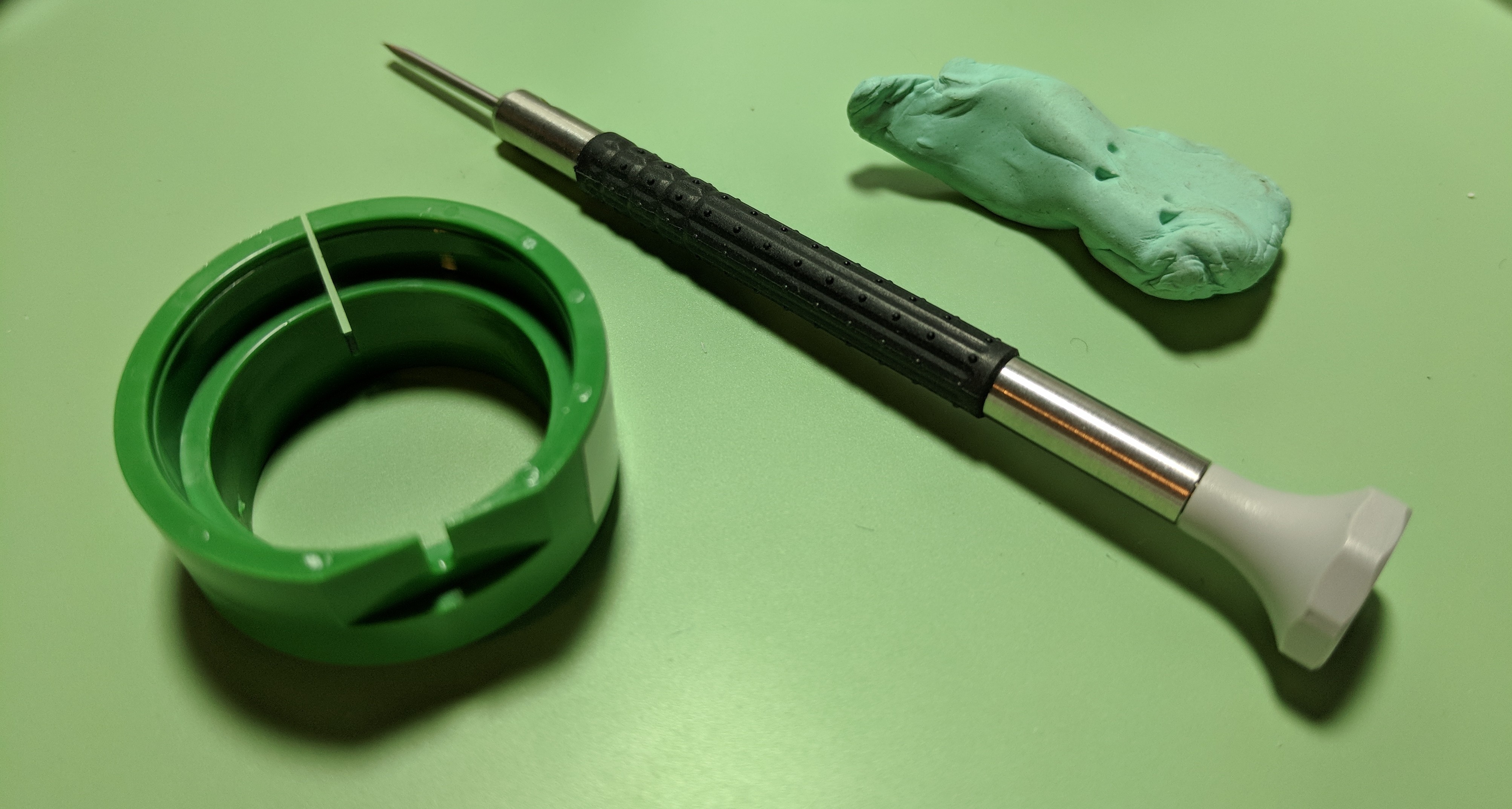

After the hands were off I removed the dial and then put the movement in a movement-specific holder for the ETA 2824/36 / SW 200/220. I mention this only because in HSL's excellent walk through to fix this issue (in another thread) he removed the rotor to ensure the movement could be held in a movement holder without interference from the rotor. This was not necessary with the movement-specific holder.
