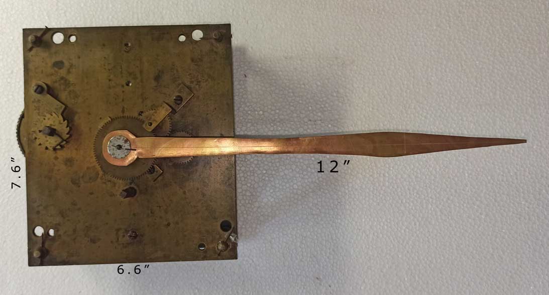

hi, again i am back with one more query. i have one single fusee large size ONLY movement with counter weight engaged on the minute wheel. now, to start with i will have to first make minute hand and then fix the dial size, so is it possible to judge the length minute hand?
I would say that movement is from some advertising clock going by the weight. I wouldn’t be surprised if the minute hand is about 18 to 24 inches. Its going to be a trial and error regarding the hand. Something that fits is all you need to start with.
good if it can hold 18-24" at present i am testing with 0.8mm thick 12" long hand. if the result is good i will further increase the length to 20-24"
one more thing i would like to know while testing does it make any difference if i test it without pendulum? as per my knowledge pendulum regulates the speed and has nothing to do with the hand/counter weight-correct?
The greatest load will probably be somewhere around quarter-to-nine. You could just test it at the first few clicks of the fusee to check it can still run at the weakest portion of the wind (even though the fusee compensates for this to some extent). Driving the pendulum does consume energy (think about during recoil) so will need to be fitted.
