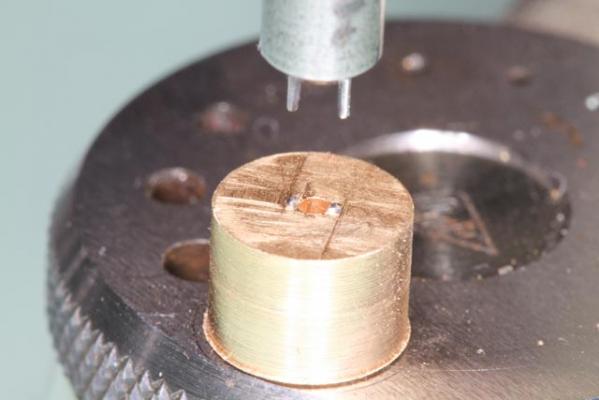

Ok, as per pictures I have a smiths rim set and wind on the bench, swimming in oil but all sorted. The fault I have is the mainspring bridle has lost its tab/notch/hook, like a hebdomas pocket watch the mainspring is fitted to a bridal in the barrel which slides around on full wind onto 4 notches in the barrel wall, thus stopping damage to the mainspring by over enthusiastic winding. So my questiion is this, what is the best way to create another hook in the bridal, my thoughts are along the same lines as making a new hole in the mainspring end, annealing etc, but what and how to make the hook?? I have a pair of barrel hook pliers that work great in soft brass but won’t even scratch the bridal, what I don’t want to do is whack a hole into it and not have a hook. the pictures are of the bridal ( broken) and a hebdomas ( complete ) incase you are wondering what I’m on about. And a few of the serivce. Thanks for any advise. -
