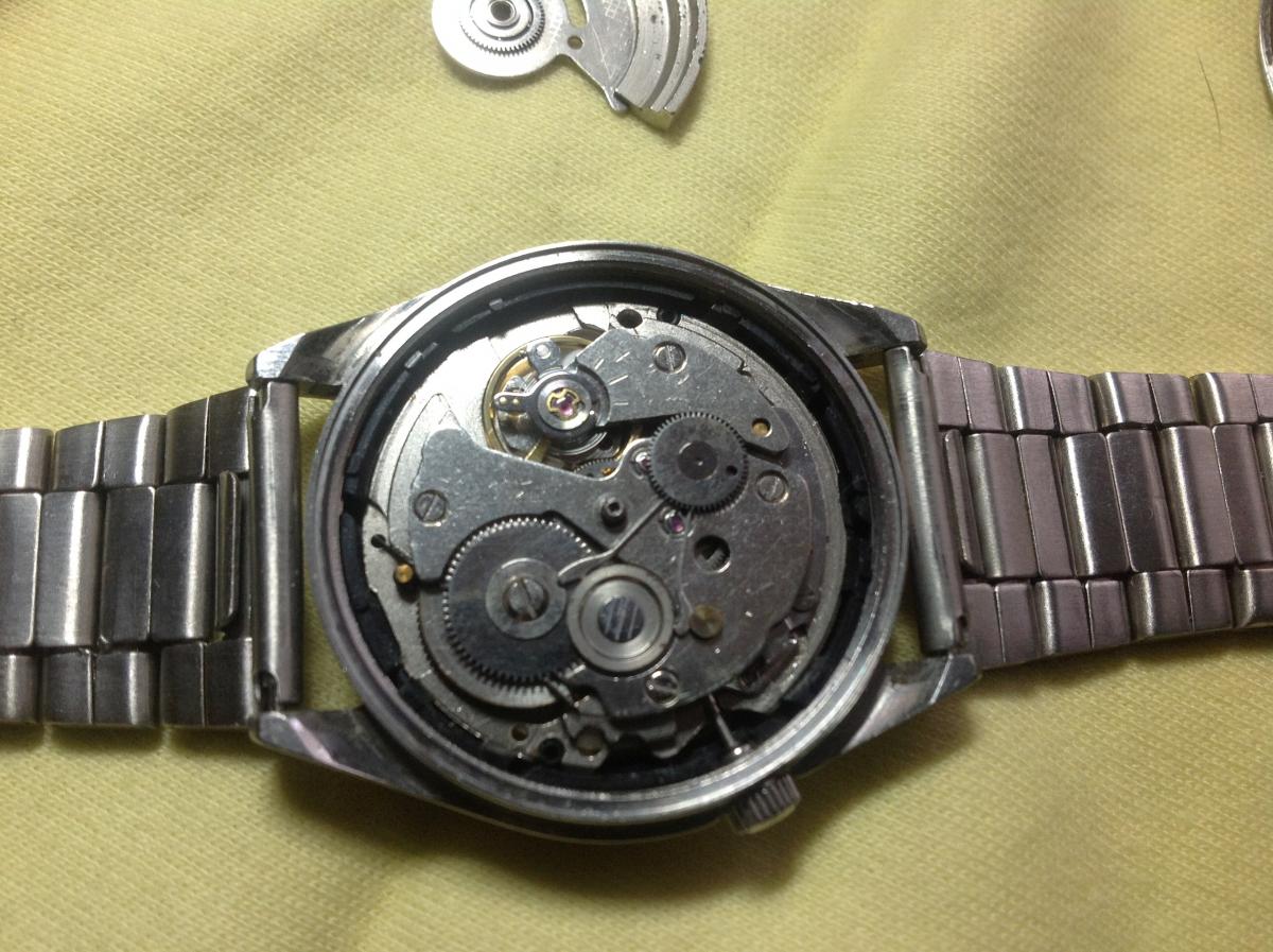

I opened it up and the old guy looks a tad battle weary
Whipped off the weight and had a go with the fibre brush and the corrosion goes quite deep.  There is corrosion on a couple of the wheels which I will attend to when I strip it and clean it. the Weight could have been catching a case sometime but also looks a bit like water damage.  Oddly the ball race is good and the weight spins freely with little play and no marks on the case inners.  The weight may or may not be original but lets face it that goes for all the parts (and a lot of the stuff I have tinkered with by the time I am finished).
The balance is really free and goes well for a minute then stops when the hands meet.  Its under warranty but It would cost about eight quid to send it back tracked so that is not happening.
I have not bothered with photos as it is a simple fix but I put on my rubbers and whipped out the stem and coaxed out the movement which though quite firm was only held in by a plastic holder - is that normal ?
When I got my scope on the movement sure enough the hands were touching and were not all parallel and I noticed that the second hand was a tad on the loose side so I took them all off.  The hour hand went back on fine but the minute and second hand just felt too loose so off they came again.  I got out my trusty toe nail clippers (stop wincing chaps) and gave them a little squeeze and on looking through the scope the barrel on the second pointer had just closed slightly which was good I had to lap the minute hand a bit as there is not much to work with (thank heavens for the microscope) but that worked as well and when they went on they had to be pushed on rather than slid on like before.  I managed to get them all on ok parallel and with adequate space between and the second hand started up on its own straight away, always a good sign. Back in it went with 12 at the right place but could not get the second markers fully into view so that is indicative of something not right. The ring under the lens may be a tad too large or the dial is slightly out.  Not too much of a problem though I will notice it all the time.
Seiko 5 dont appear to have a winding mechanism via the crown (is this right ?) and on poking around I noticed I could move the barrel with the screw and the click was working so rather than exercising my right hand (resist please) I used a screwdriver to wind the barrel up - seems quite easy and effective.
It worked for two days solid and seems to be keeping good time and in fact is on my wrist now.  It will go in the queue for clean and service.

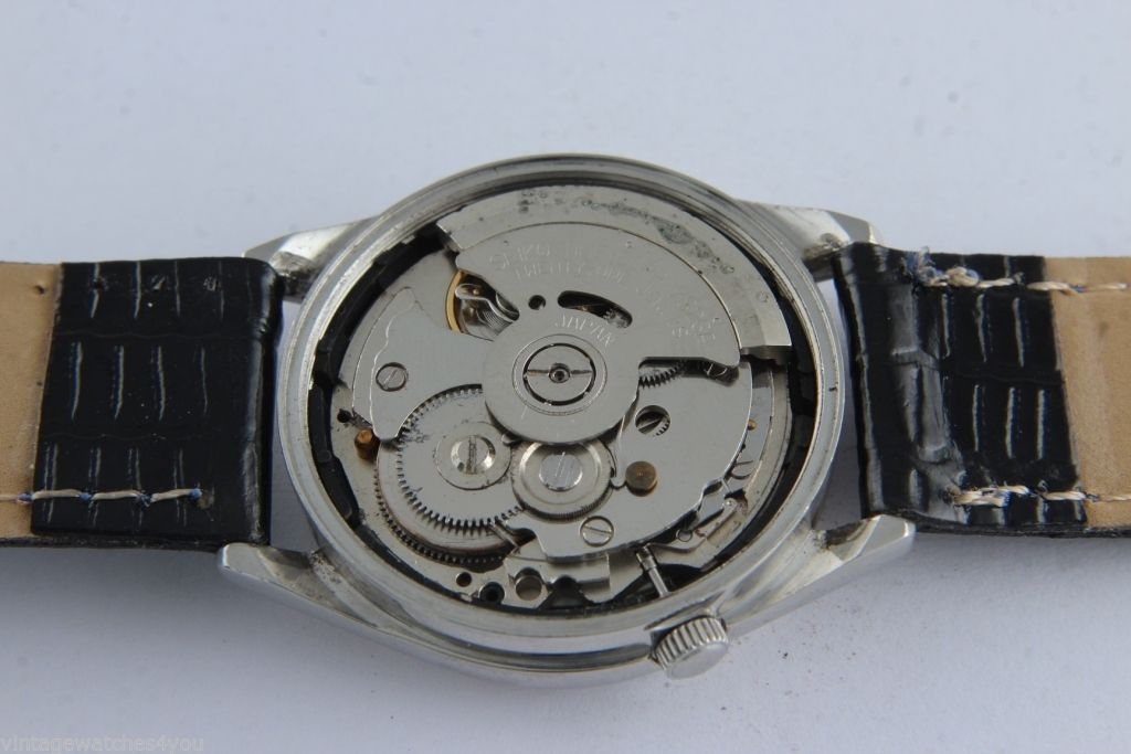

I think the caseback may be from a different watch as the number given turns up this- http://www.speedtimerkollektion.com/shop/product_info.php?products_id=7879 but then again that may be wrong.
You are absolutely correct BL,
I just have a feeling the movement is 7S26 and not 7019! The plastic ring, rotor and overall movement makes me think it is. Either way, those dials are for crown @ 4ish and day/date @ 3 so they should work! I can't see the shape of the jewel spring on the balance cock but it wouldn't really matter since they are interchangeable anyway...

Well here is a photo and a small video (sorry it is shaking a bit, I have not had a drink today :angel: ).  The watch is still going so despite appearances, I will persevere.

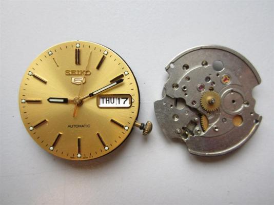

I believe you do have a 7S26 movement. What version has to be guessed but it could be A. Here is the telltale bridge from this movement:
The previous model bridge has some extra holes and stuff (not too different but not interchangeable). On the other hand the balance cock is interchangeable and you have a previous movement one! The telltale sign is the jewel retaining spring in the shape of a 3 leaf whatever-they-call-it while the original is simply a long thing with a slot in the middle.
The page you found is the original free Seiko course mentioned in Lawson's walkthrough...but it is not complete I'm afraid. Still, there is enough information there to do everything sometime with a little interpolation upon reassembly. :) They have a yahoo group that doesn't seem to work and is trying to move on their own towards a newer version. Still, thank you for the reminder, it is a good course...and for the money :)  The tool kit recommended are at best mediocre and I would not use them myself, the supplier doesn't carry them anymore.
Don't worry, you can work well in this movement and it will be a lot of fun. In the end, you will have a runner and if anything goes amiss chances are the parts are either available or a cheap donor can be found. Worth case scenario, you can always use the whole brand new NH36 from CousinsUK which is an upgrade to this vintage one with a couple of improvement: Hack seconds and manual wind in addition to old features.
