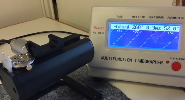

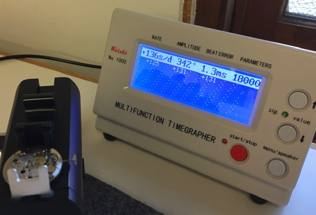

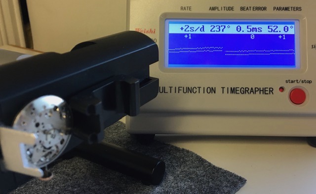

Hi all,
I completed a clean/adjust/lube on an FEF 380 from an old Doxa. I installed a new mainspring bought from O. Frei and got the one specified on their movement database. Based on the extremely high amplitude and its erratic performance, I'm guessing the mainspring may be too strong for the movement. I have re-cleaned and re-lubed the balance jewels but that didn't have an impact on the amplitude. I can use some advice on which less powerful mainspring to get, and/or if I am overlooking any other possible causes. I'm thinking the width, thickness, and length of the mainspring should be constants, so I guess I'm looking at less Dennison strength and/or less metric strength? I have attached two amplitude photos, one at 1/3 wind, one at nearly full wind, abd a photo of the O. Frei catalog description of what I installed. Ignore the rate in the timegrapher - I adjusted the rate to spot on at first but as the movement ran overnight it sped up. Any advice will be greatly appreciated.
Thanks!
FEF 380 1:3 wind.jpg

That doesn’t look like re-banking to me.
How is the timing in pendant down and pendant left orientations?

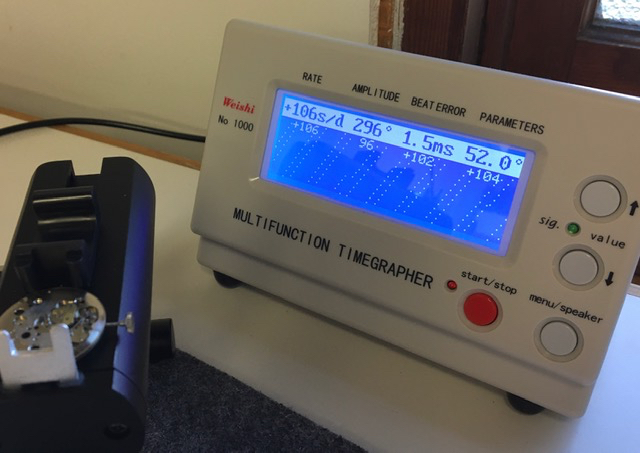

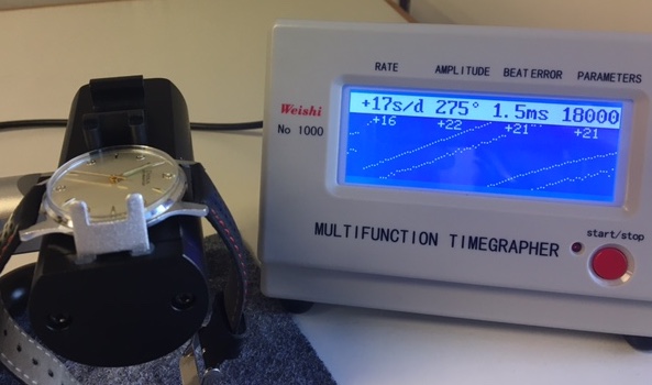

Per Rodobod's suggestion, here is the performance in those positions plus pendant up. I included a dial up for reference and adjusted the rate only in that position at nearly full wind. Given the variation in rates, could it be a balance issue? Maybe something wrong with the pallet pivot jewel?

You're not rebanking, but that is a lot of amplitude. What is the amplitude when you let the spring down about 1/2 turn?
As for the rate, that is not that bad for such a movment. If you close the regulator pins a bit it should bring the vertical rates up  some.
The amplitude at 1/2 wind is still at about 300 degrees (even at 1/3 wind). I'll try tightening the regulator pins some. I've never done that before.
My concern about the rate is, I adjusted it to that level of performance before, let the movement run about 12 hours while in the movement holder, and then when I checked the rate again it had shot up to about +90 secs a day. I gave it a wind and it was still that fast. So something is happening while the movement is running that impacts the rate. I'm guessing it could be because it's overpowered, but I'm not sure.

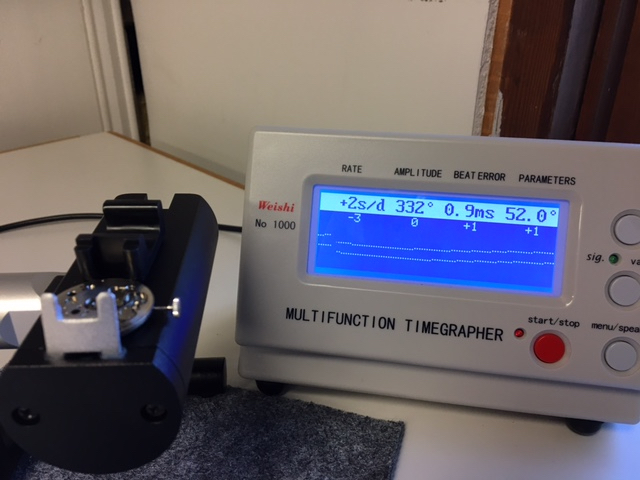

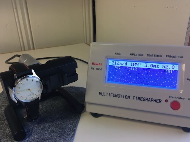

An update. I did install a less powerful new mainspring - metric strength .1 instead of .11 - and that reduced the amplitude about 20 degrees in both dial up and pendant down positions to something more reasonable. But what was more troubling was that as the watch wound down to about mid-strength, the rate dropped significantly to about -120 seconds per day. This was happening before I put in the new weaker mainspring. I swapped the balance assembly from another FEF 380 (cleaned and oiled) and that made the performance more stable. That tells me that maybe something is up with the original balance assembly, possibly in the balance complete, maybe the hairspring. I don't know.

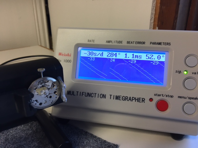

Attached is the performance today dial up and pendant down, pendant left. Big variation in rate and beat error and pendant left is a mess. I noticed the regulator pins are not as perfectly aligned as on the original balance assembly. I wonder if a slight nudge of the pin to make it tighter will improve the rate is down and left positions? I'm reluctant to mess with this since it's such an imprecise method, the fragility of the pin, and the possibility of disaster.
Any other suggestions are appreciated.

Please verify pendant left the hairspring is expanding and contracting free, no windings touching each other or rubber the the balance cock or wheel. Just to be sure.
second make sure the compass pins ar perfectly parellel to each other.
third, do not bent the regulator pins unless hou have seen by inspection under higher magnification (microscope)  the drop or locks are not equal.
4e: if all above is fine, check the height play of the pallet fork, this should be small be pallet needs to move freely. You can simply test this with the escape wheel and balance out of the watch when turning the movevent the pallet should easily drop to the other regulator pin.
5th: swap the pallet fork itself.
Please  let us know the results.
ps I do not like the traces, they are wobly, not straight lines, this is often due to issues with the escape wheel, dirty teeth, worn pivots, small particle in the jewelholes, not 100% clean pallet stones, not freely moving pallet etc., much more likely than an issue with the balance. I assume you used epilame for the ancher wheel and pallet stones and oiled them with a very small drop of 941 oil?
Edited by Ronp
I didn't like the traces as well and wondered what could be the cause. I did use 941 oil on the pallet stones and after the movement ran a bit I cleaned the pallet stones so hopefully there was only oil on the escape wheel teeth. I did not use epilame - that has not been part of my practice as of yet. I guess it's time to invest in it. I'll go through some of your other troubleshooting suggestions as well. Thanks!
I agree with Ron’s advice. Something fairly significant is happening in the pendant-left position so try to figure out why the amplitude has dropped off so far.

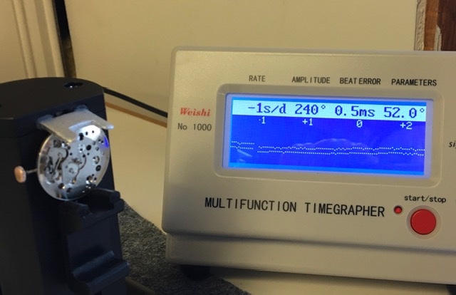

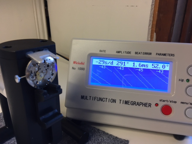

Following Ron's and other's advice, I went through the list.
-- Hairspring coils were not touching in any position. That said, the hairspring looked a little odd when I held the balance complete horizontally at eye level. The coils at the edge of their circumference sagged more in one direction then when I flipped it over. Could be nothing, but I swapped it for another balance complete.
-- Banking pins. Yes, one of the pins was not perpendicular to the movement plate so I moved it into position so that they were both parallel to each other
-- Regulator pin. It looked fine through a 10x, so I left it as is
-- Pallet fork end shake. This seemed fine as well
-- Epilame. Yes, I sprung for a bottle ($$$) and at the rate I work on watches I should have enough for 10 lifetimes. I treated the escape wheel (teeth only) and the pallet stones. Gave them a quick hair dryer treatment. Installed the escape wheel and pallet fork and let the watch run for 10 minutes, then oiled the pallets with 9415.
-- Swapping the pallet fork. I tried that but no difference.

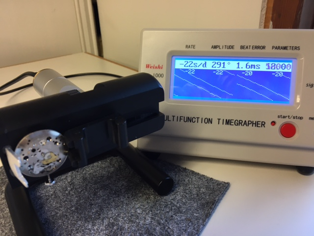

Attached are the current timegrapher readings. I adjusted the rate for pendant down and pendant left since those are the most common positions the watch will be in (like right now when I'm at the keyboard). It's running fast dial up, but I figure I'll wear the watch a few days, see how it does, and will adjust if needed. The traces are not as smooth as I would like, but I'll take them. My sense is this FEF 380 was at best an average quality movement in its day, and this one doesn't even have incabloc shock protection.

Is this the new balance? The pendant down/left positions are well matched.
The timing differences will likely improve if the amplitude gains a bit.
