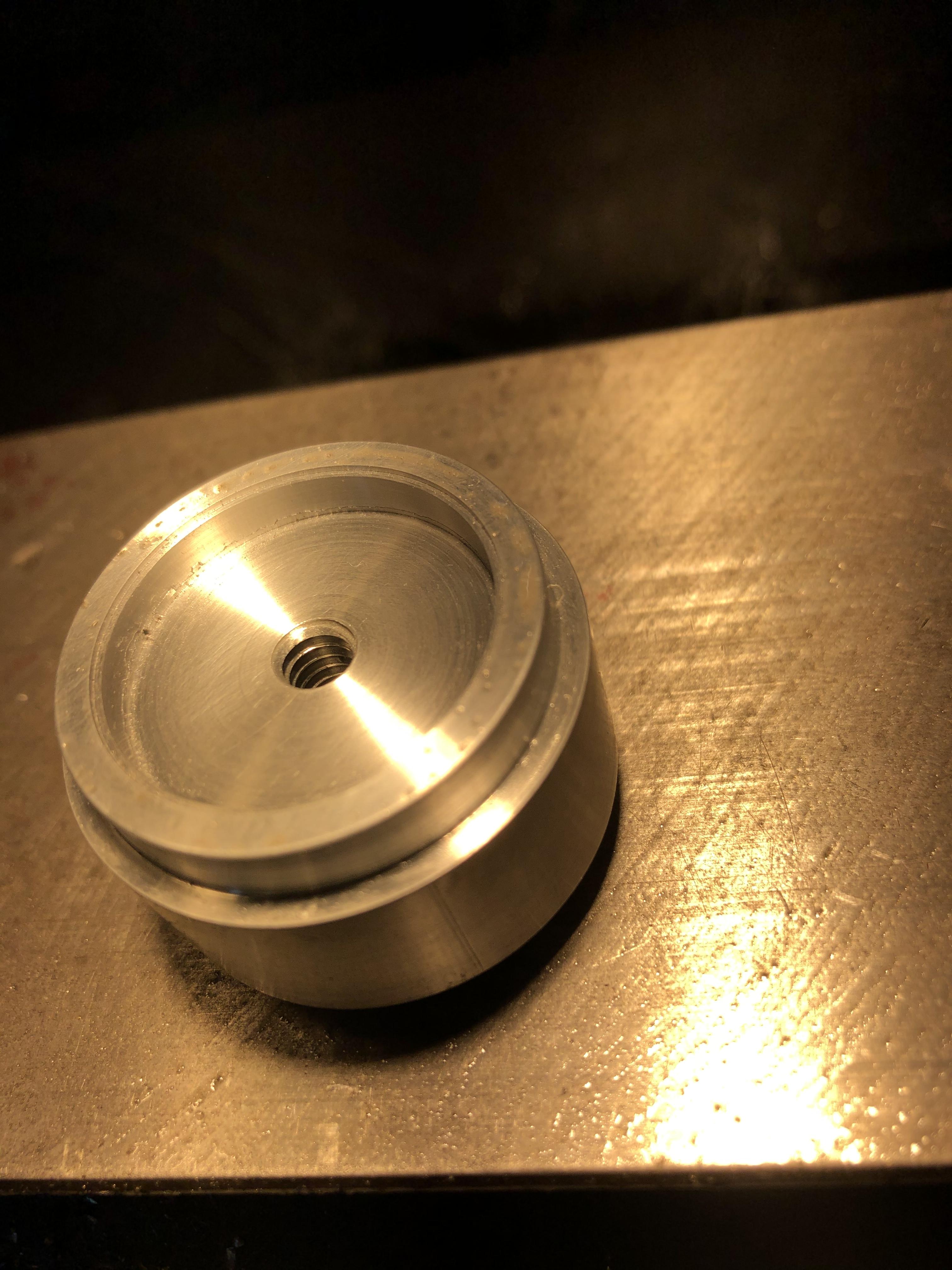

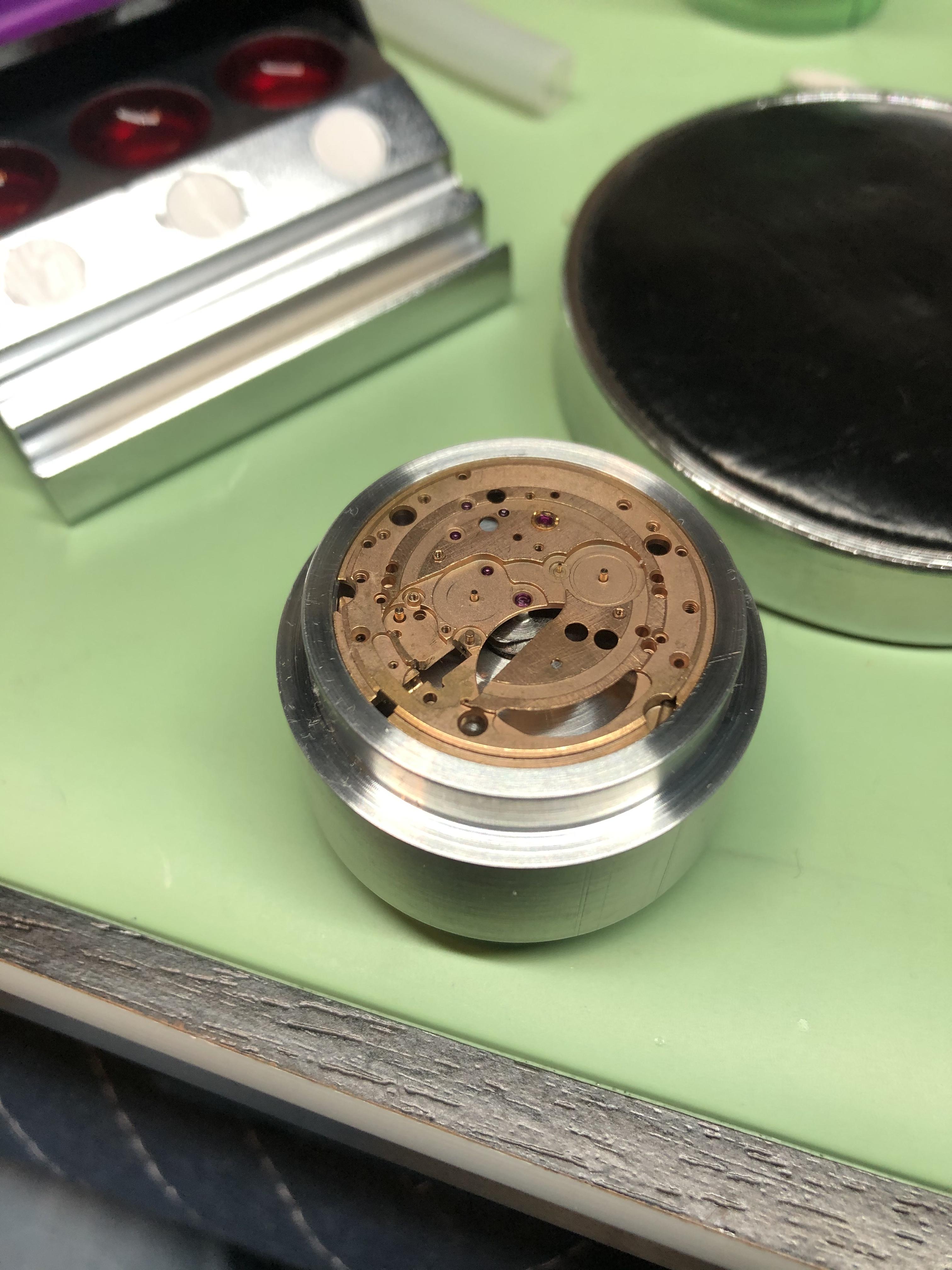

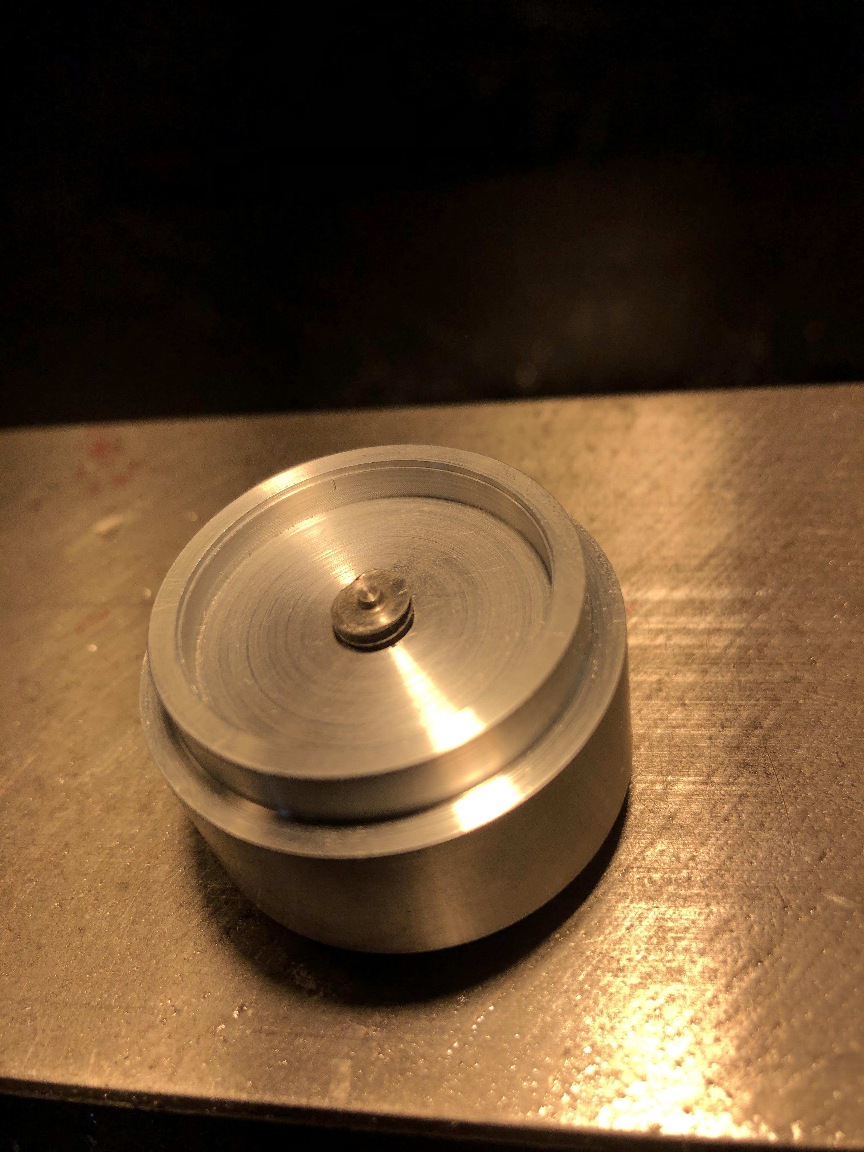

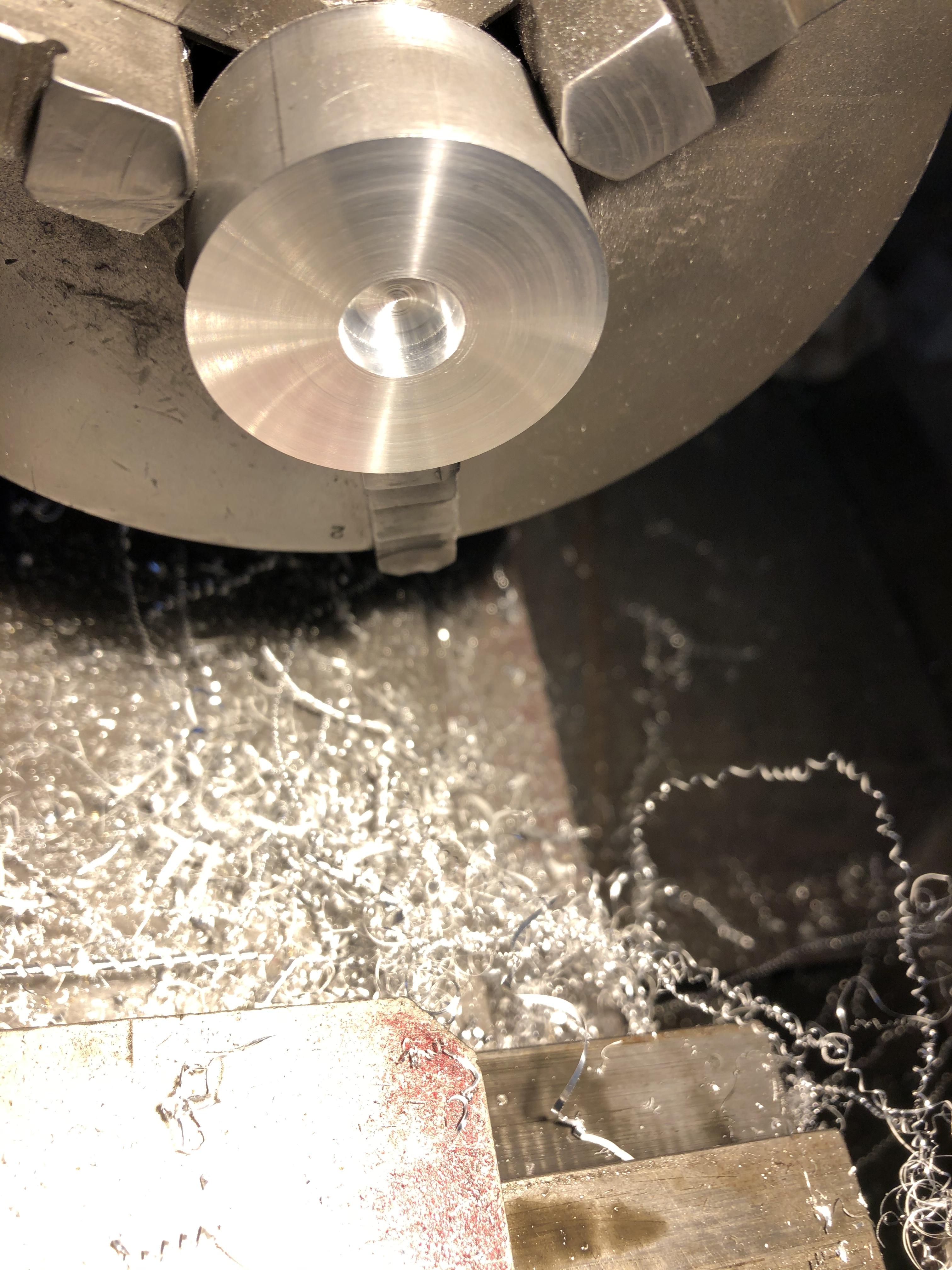

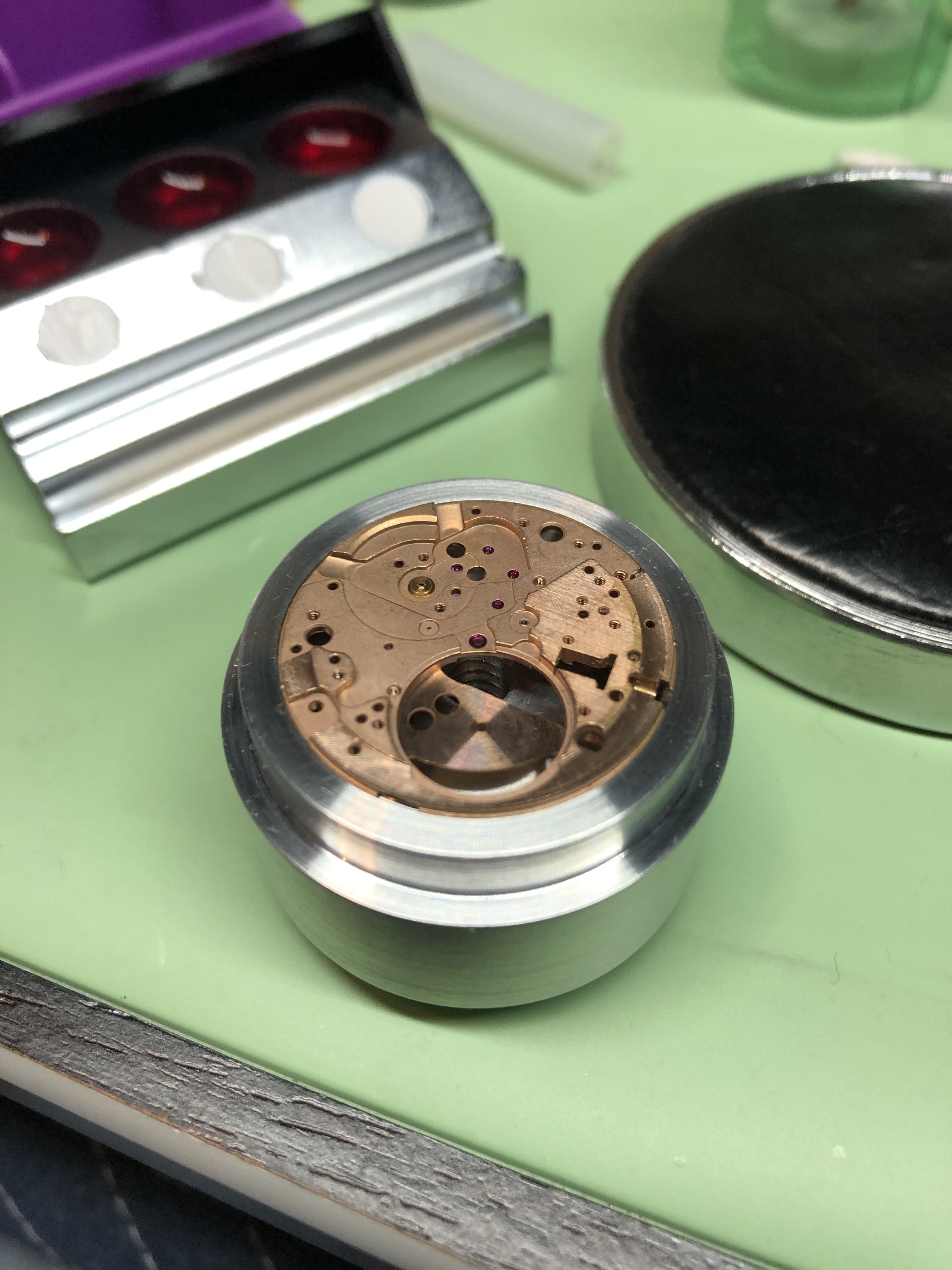

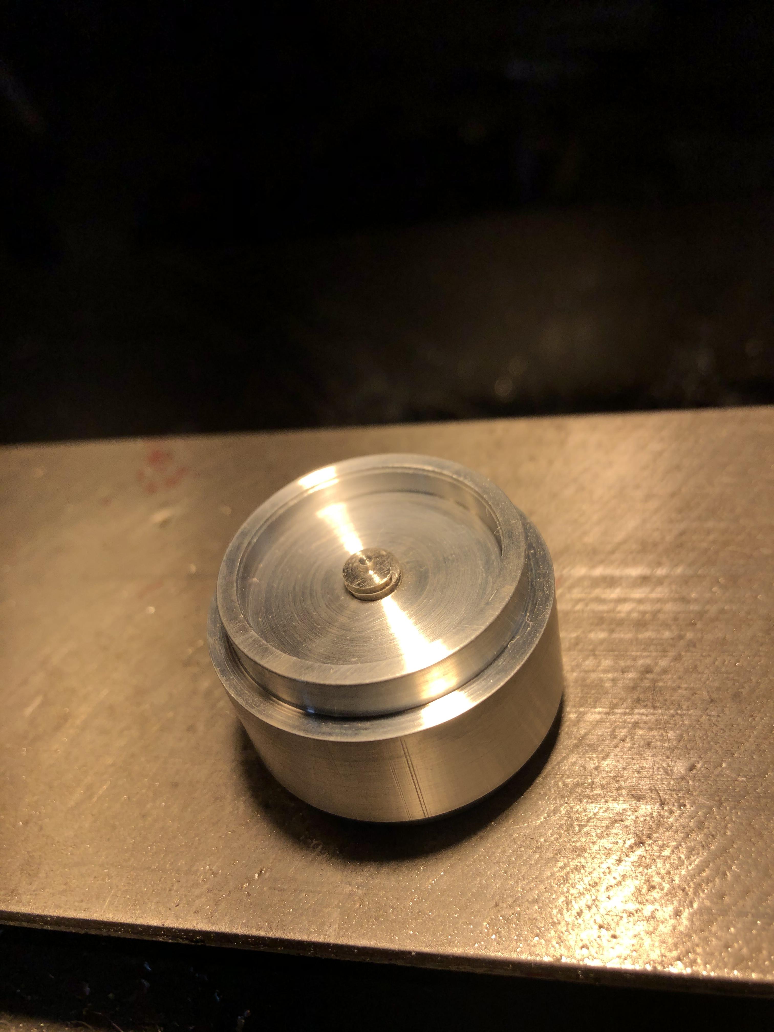

I really dislike the generic “clamp”movement holders. I have the “good” Burgeon one- I forget the number, and it works ok. But the legs always seem to be in the wrong place or putting pressure on something I really don’t want pressure on.
I have 1570 and 30/3135 holders and they’re great. Easy to handle and a center support for pressing hands etc.

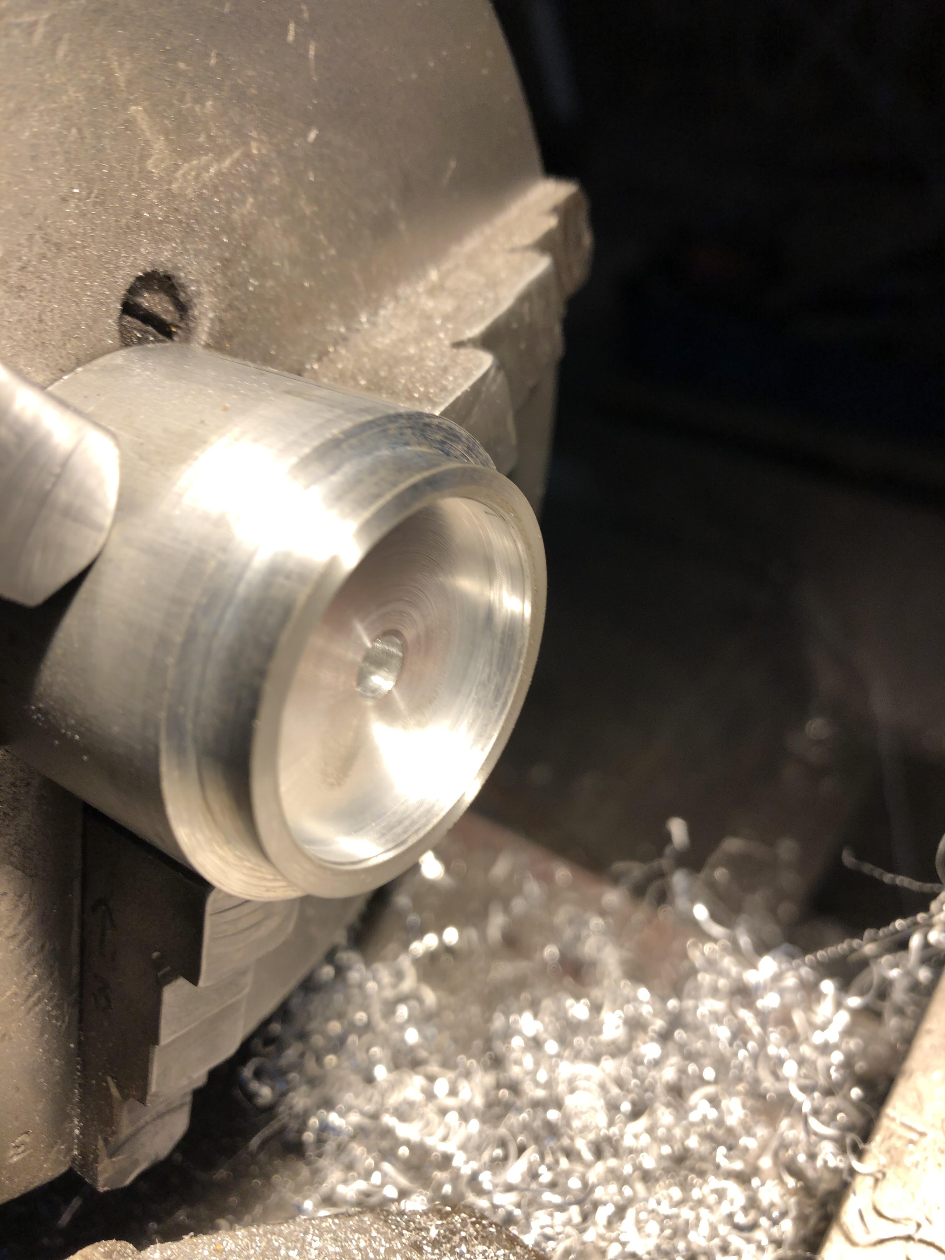

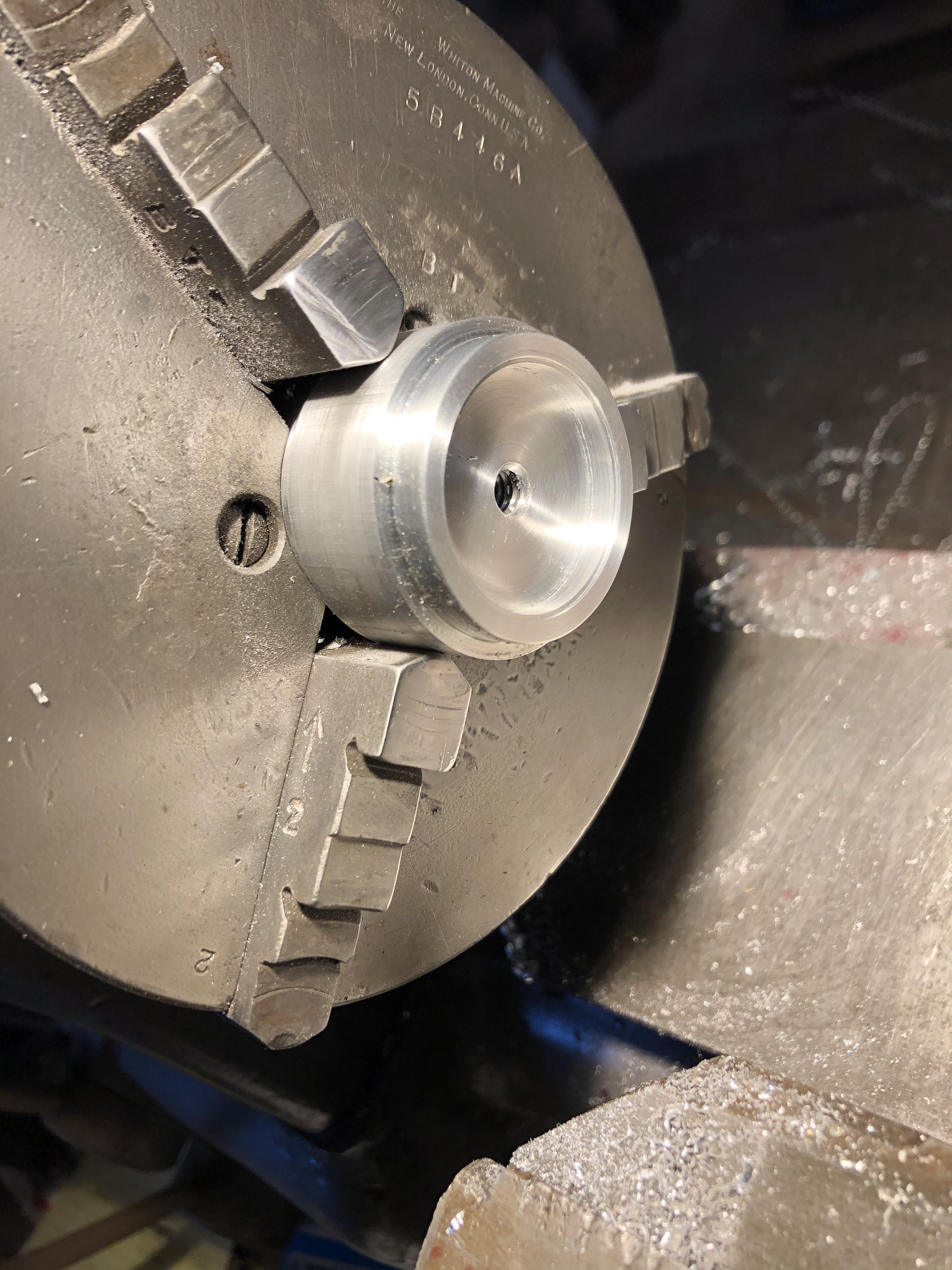

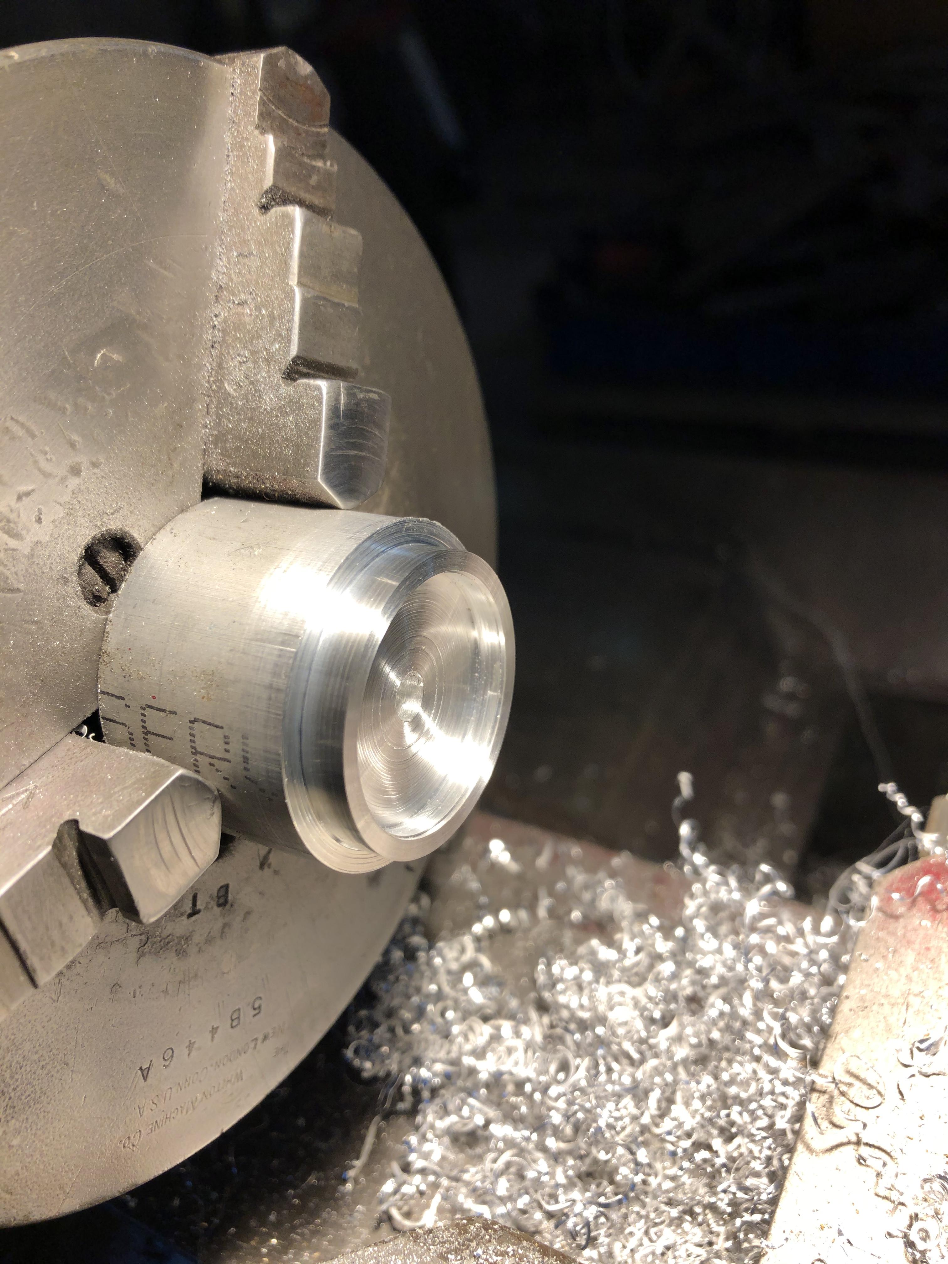

Knowing I’d be assembling the 565, I wanted a good holder (although it does sort of fit the 3135 holder).
It is two sided- either side of the main plate can be supported. And the dimensions are different. I’m not totally happy with the center support but it’s better than nothing. I’ll make something better later.
