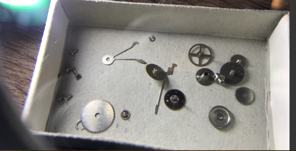

I finally opened the main spring barrel  it was dam dirty. I cleaned it, now waiting for the oils, I need to know all the oils required for the service.   I will be ordering the oils from cousinsUK.
Don't have details of oils.
it was not dirty, simply the original lubricant is graphite loaded. Seiko barrels are sealed, not meant to be opened and especially in your case you will not gain anything from having done that, but will distort and contaminatte the mainspring by putting it back by hand.
All that and much more has been dabated already so many times, as you would have found if you were to use the search function.

I was not earlier planning to open the barrel but out of curiosity i did and i need just help from all of you guys to make my watch ticking again.

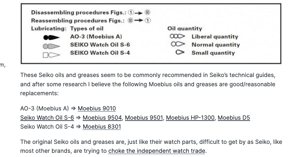

    Not able to understand the Oils and there Names. I need simple alternatives for these three oils and also need to     lubricate the barrel and main spring because i  also opened the Main Spring  barrel. Will be ordering from Cousins.UK.
    I found this which i guess explains all the options but i am still stuck with Barrel. Which Grease i need for putting back my barrel and Main spring please help.  Are these oil good which are mentioned above because these are too expensive and i am a student.
Please help me to bring the cost down. If some how i can just mange with just 2 Types of oils it would be a bliss. New 4r36 Costs around £80 and with oils and complete balance its costing me £84. But i am also scared that 4r36 has a different crown position the crown is @4 and my 7s26 has a @3 crown position. Does that matters or not and then i also need to change the crown stem that's also a tricky part. I am getting confused my hopes are dying.

To get your mov.t working again you don't need any oil, you need a good balance, plus tools and the skill to put it back together. And you need a timegrapher to judge if it is just running or running OK.
You can worry about oils later, if and when your present piece is running OK, and/or you want to continue working on mechanical watches. In the meanwhile have a good read at our pinned topic below that has answers to all your question, and then some.

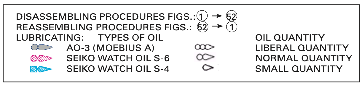

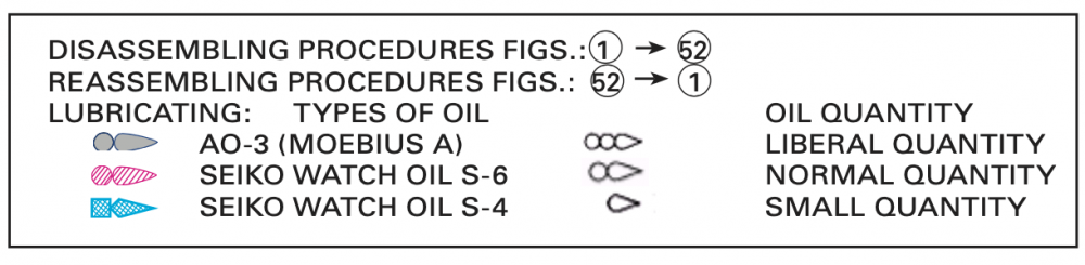

Refer to your datasheet for lubing instructions.
Have you ever looked into a Seiko service sheet, they refer to they own lubricants.  Beginners that dont take the time to search will then ask what's their Moebius equivalents. Answer given the topic I have linked above.

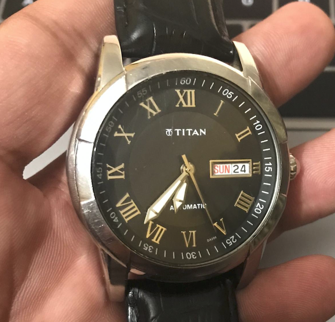

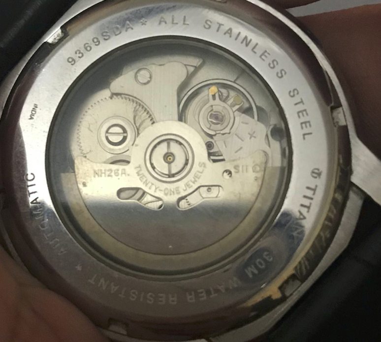

I'm having a mild confusion over which watch are you servicing? That's because in your picture you appear to have a NH26a? then I found a link below that talks a little about this movement.
what I don't know is whether the OEM components exactly replace the 7s26a components? Then the second link gives you the cross reference for the 7s26a components. So you can see what other watches are using your balance complete for instance.
then as you really want to fix this watch it might be easier and cheaper to purchase additional watches which can be broken or not functional to get parts for your watch as opposed trying to find new parts. Especially because more than likely you're going to need additional parts before you get through reassembling your watch.
NH25 = 7S25, NH26 = 7S26. SII is the Seiko branding for their movements sold to OEM. These NH2X now are not sold anymore, only the NH3x which add manual winding and hacking while mainataining total dimenzion compatibily and most parts incerchange.
Yes, they do. Below again the table which I maintain, tracking part compatibility across all version and all brandings.

It is a NH26A. Will the complete balance of Seiko 7s26 fit on my NH26A because i have learned on internet  that NH26A is exact 7s26.
