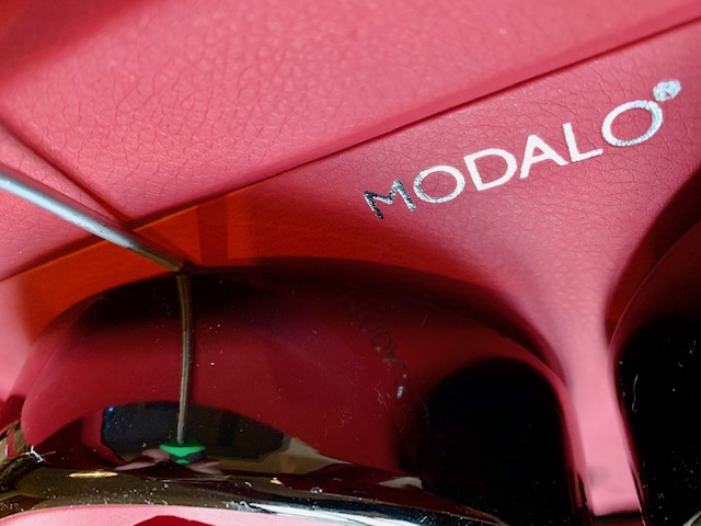

Hi...  did you ever figure this out?   I have a Modalo, lockable 4-watch winder.   It has two big winder circles that hold two watches each.  Pretty standard I think.
I believe the belts have worn out.   I had this challenge a couple of years ago; I sent it back to Modalo; they fixed it and sent it back to me.
This time, I've had Modalo send me two new belts, but I can't figure out how to get into it.  When I look on youtube, it looks like you just twist the part of the winder that holds the watches (just the inside piece) for other winders that look like this.  But this one seems different.     Behind the two winders, it looks like there is a screw (1 behind each)...  but I can't seem to get the big winder wheel (circle) off.
Any thoughts or luck from anyone?

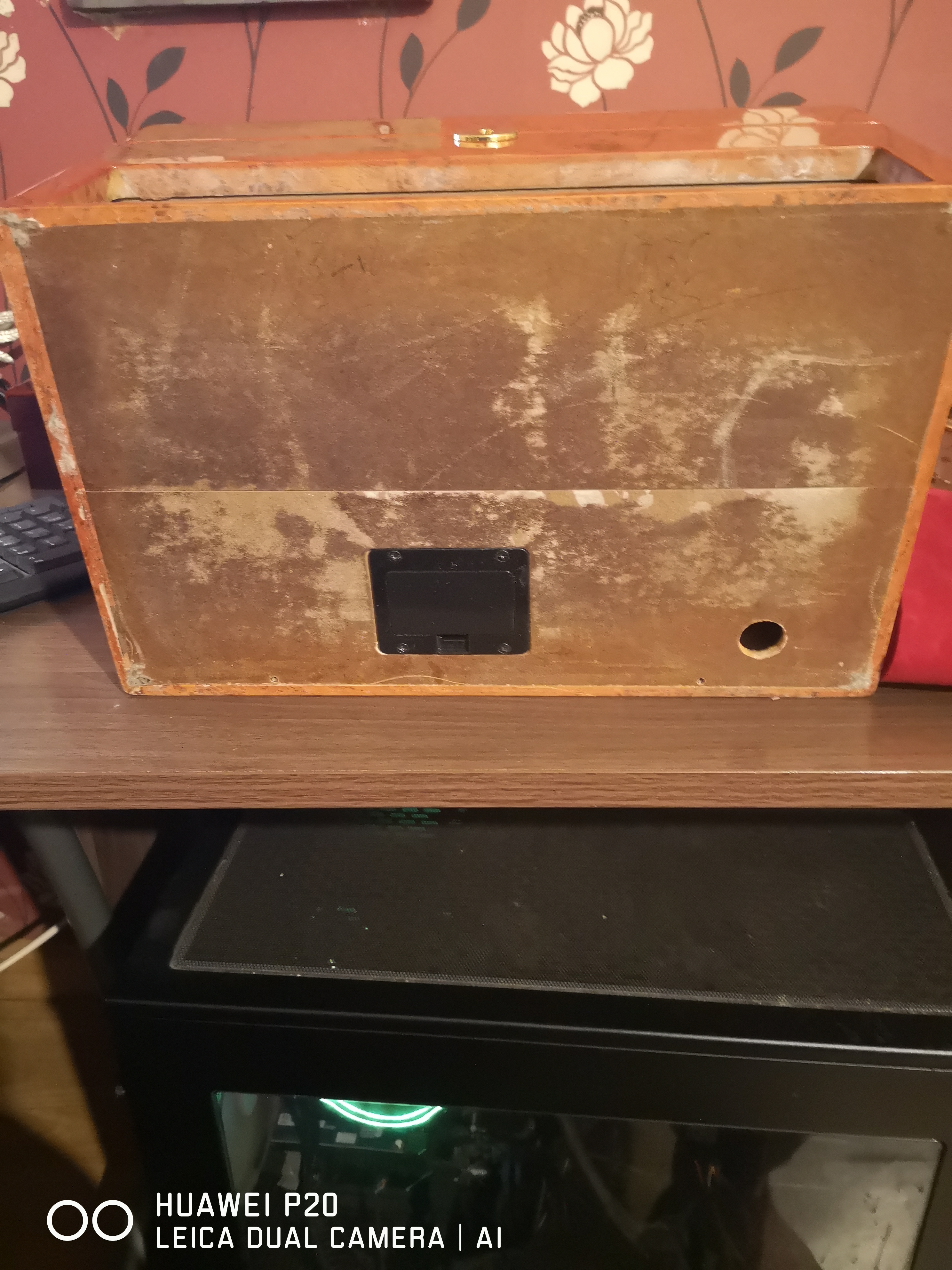

Hi
I removed the felt from bottom. Be careful it goes back on there's a small square door with 4 screws. Open door and you can look inside. I stopped there as I am unsure of the wiring.
Let me know how you get on.

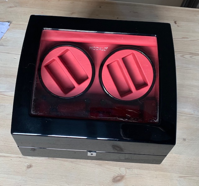

Here are a couple of pics.   Overall unit.
As I said, on most of these, the top wheels (watch holders) come off to reveal a couple of screws.  Typically by holding the black outside and twisting the inside.   I've tried that with as much force as I am comfortable applying.
When I try to look behind the big wheels (see the pic:  I'm pointing with a screw driver) I can see there appears to be a screw behind each one that holds the entire panel in place.  IMG_8120.jpg.7caa38b307ce26a5e4cc917f67457ba3.jpg
Regarding access through the bottom. I did have to that on another winder I had (TimeTutelary), and it was fairly easy to feel the small screw hole through the felt if you paid attention.  I have really checked this one out and didn't feel where any holes would be; pretty sure there aren't.   Where were those on yours?   I will check again.

Hey
UNPLUG IUT FIRST.
here are a few pics the back door opens and you can the remove the slats of wood.I think the slat nearest the rear should be left to last i think it has electric parts on it. The slats have small screws holding the slats in place in the corners.
The door part (battery compartment)  i removed as it lets you peep in and trace the wires
I put this to one side as i am hectic at the moment.
But please keep me informed as i need two motors my self.
Hope pics help and please contact me if i can be any more help.
I can take more pics if needed
I need to know what motors to buy and how i get them or the belts out
good luck
gary
hey
Here we go inside a modalo. Felt guilty not finishing it. sorry pics aint better but you should be able to see.
The slats slightly overlap so ease outward and either upwards or downwards.
cheers
gary
