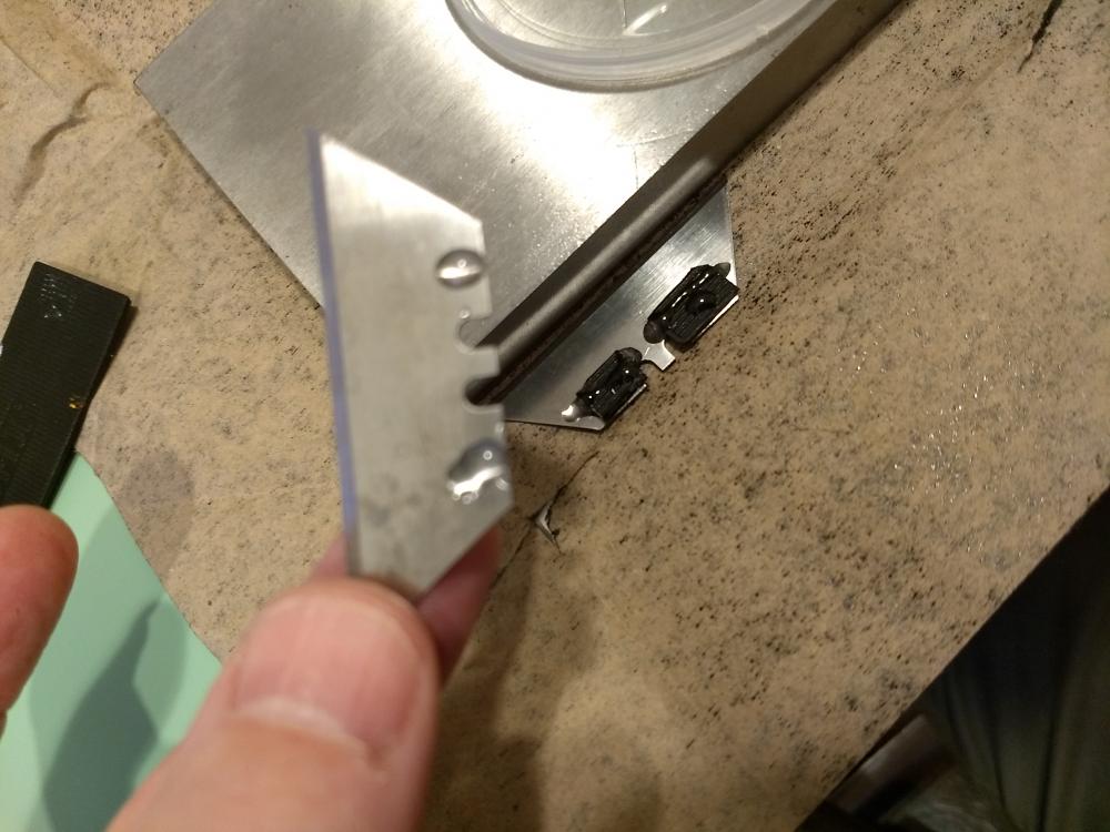

Well I've started on my knocked up poise tool that seems to be going quite well. I think I have identified at least two heavy spots.  I think the blades might be slightly magnetised as the balance can get pulled towards the blades, so I will address that later before I start taking any weight of the balance.
  • Thanks 2
I just checked and that heavy spot indicated in the video is below the balance pivot when the watch is midway between PD and PL (The two positions with the equally slowest rate, -65). I think that's expected and it's starting to make sense.
