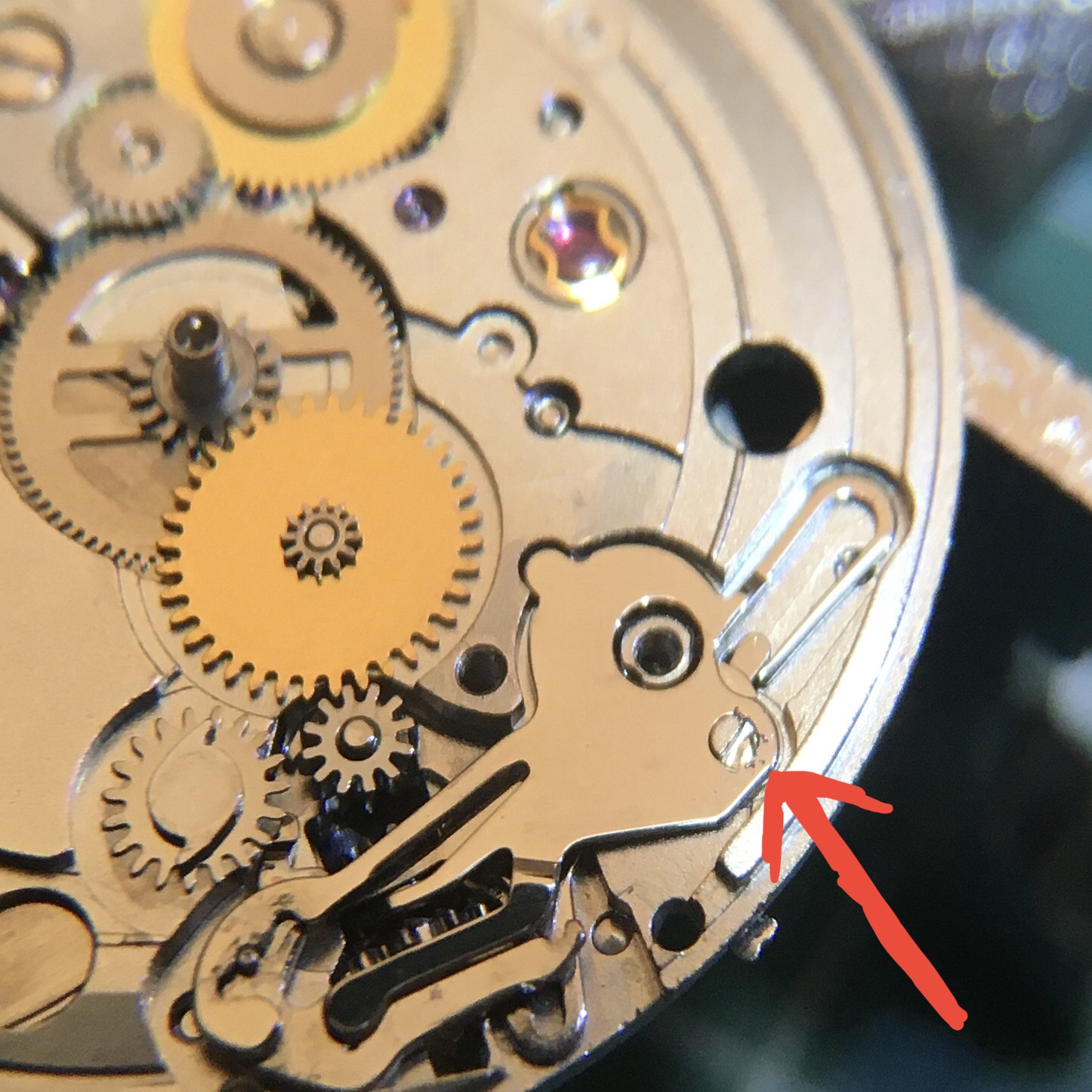

Hello this is my first post. And as you would expect I have joined the Sellita SW-200-1 Stem SNAFU club and so I am trying to fix the keyless works.
I am stuck on trying to remove the Setting lever jumper because the second screw won't budge using my 080 Bergeon screwdriver.
I have marked it red on the photo attached below. Which you can see I have aleady damaged trying to unscrew.
Is this screw smaller than 0.8? I have looked in the Selita Technical documentation and can't see the screw size specified.
The smallest screwdriver I have is 080. What sizes would you recommend for the SW 200?
Any information about this screw size and general tips would be much appreciated. Thanks!

Only one screw holds the set spring down which you already have removed.
To keep all fidly parts from flying out of sight, I put the movement in a plastic bag and pry the spring up.

even though in your picture looks like a screw is still there that conflicts with the tech sheet? It appears to be that Nucejoe is correct there's only one screw.

Thanks. Indeed there is only one screw and I have managed to remove the setting level jumper. Thanks for your help.
I mistook the the second smaller hole in the setting lever jump as a screw when in fact its just a piece of the main plate poking through with a small notch in end, giving the appearance of a screw. I have mangled it a bit by turning it with my screwdriver. Hope that doesn't cause any problem as I reassemble the keyless works!
